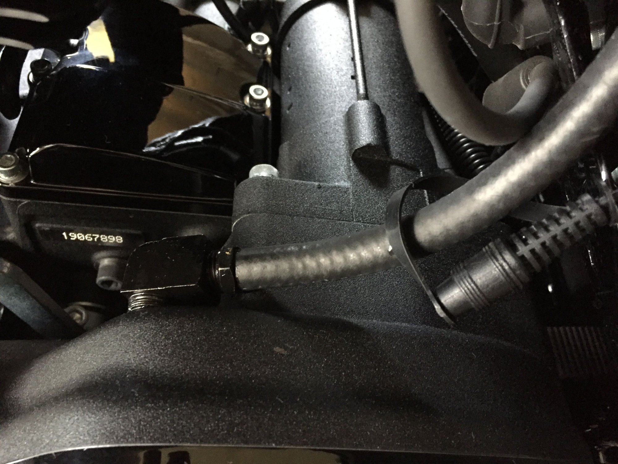

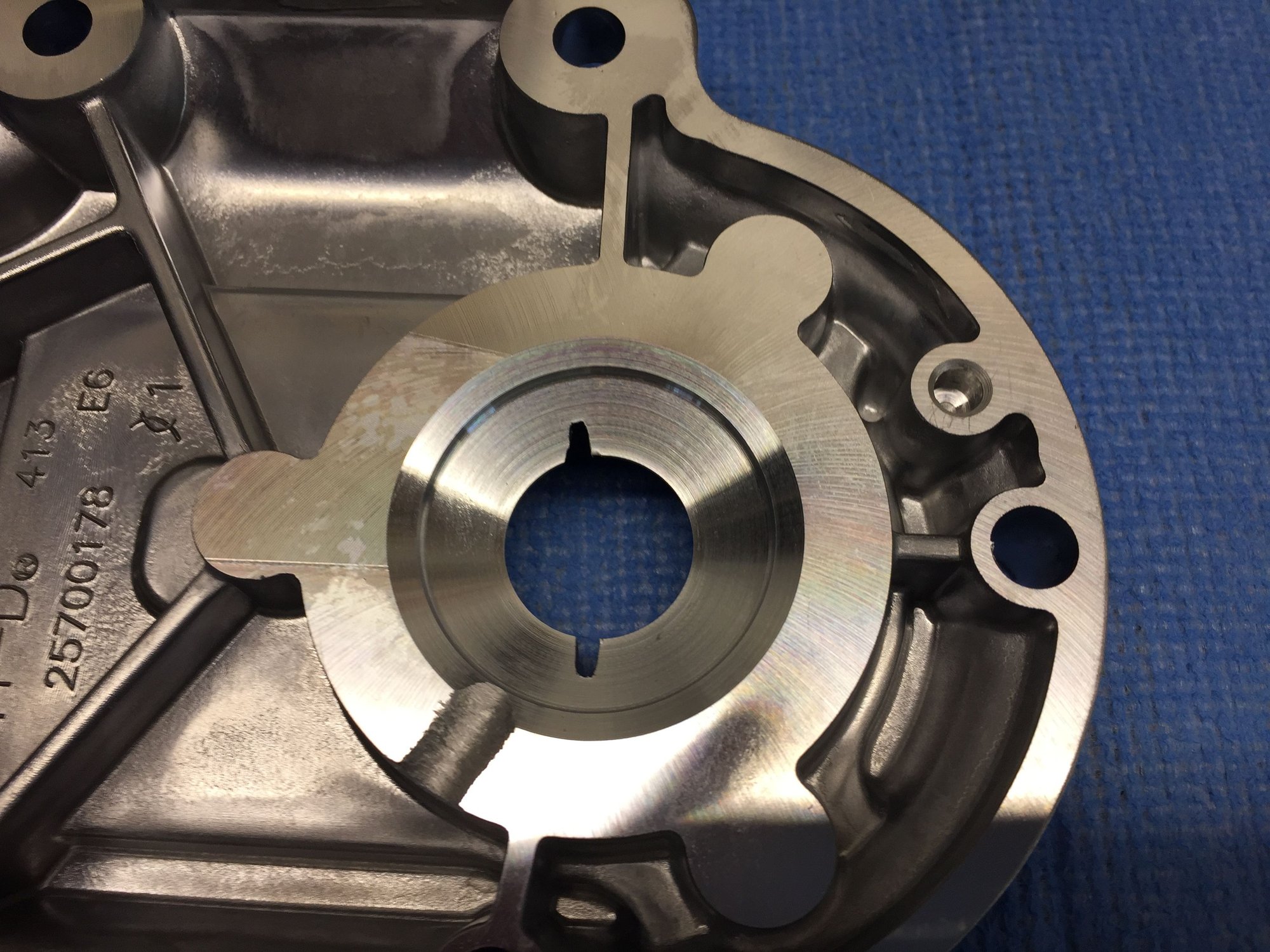

I made a slot on the inside of the side cover at the 7 o'clock position of the actuator pocket for oil to drain out of the pocket. Also added a primary vent. So far no more transfer and this bike was a heavy transfer.
Can you explain how you vented the primary?

Would a vent even be necessary if you're keeping the oil drained away from the shaft end?
Any pics of the 7 o'clock slot?

I going to go back and hide the primary vent better...this was just to see if it would work...
