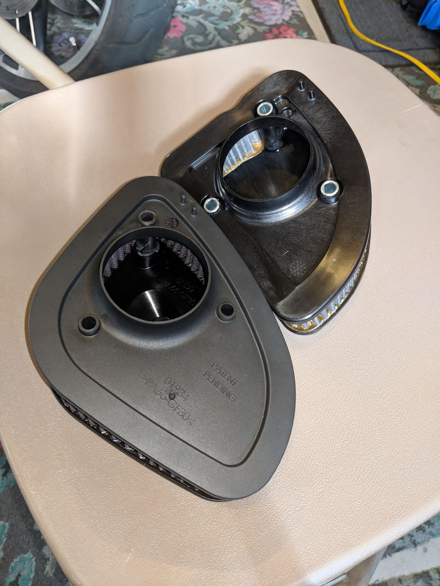

Heads up... Compare the build quality between the OEM and the K&N. I actually crushed two of the three mount tubes (that the screws go through) by torquing the screws to 45 in/lbs as per the K&N instructions. I had removed it for cleaning and treatment and it broke when I put it back on. Luckily,I still had the OEM one and put it on, only after checking my torque wrench though.
The OEM version has full metal tubes (roll pins, actually) and is of a much stronger build. Yeah, the K&N has much more surface area and is much lighter in weight but if this going to be a thing, well, I dunno. Has this happened to anyone else?
I will be calling the K&N toll free number as soon as they open, today. Will update on how this goes.
