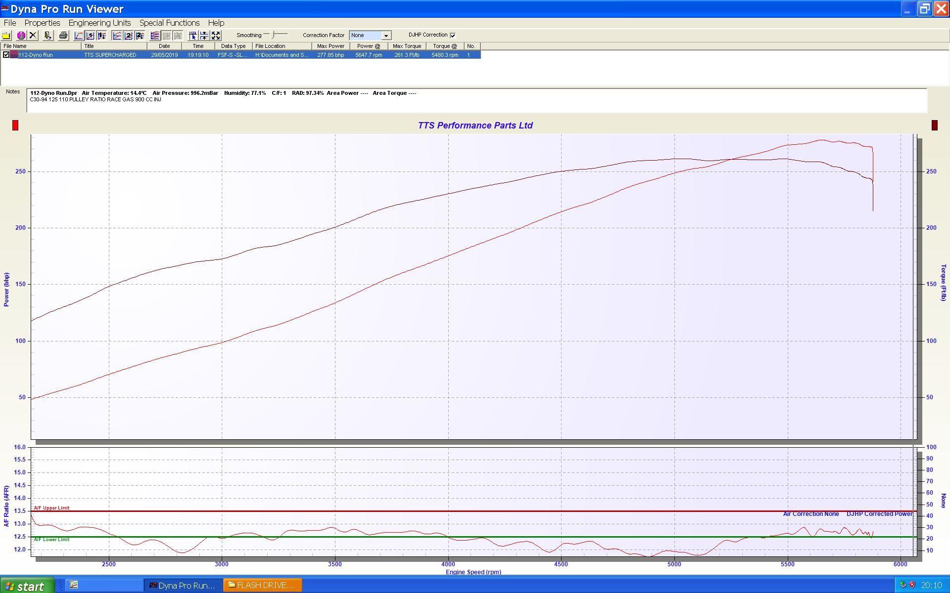

Default TTS Inferno Supercharger pulls 277 whp 261 ft.lb torque
So we are still at 114 cu.in., RS468 cam, std head, throttle body, etc. but we have upgraded to a C30-94 Rotrex supercharger. and running race gas 50:50 with pump. We have welded the crank big end journal and wire ringed the heads. We are just starting to run out of duty cycle at the top end. I know we are pushing the limits but that's part of the fun.

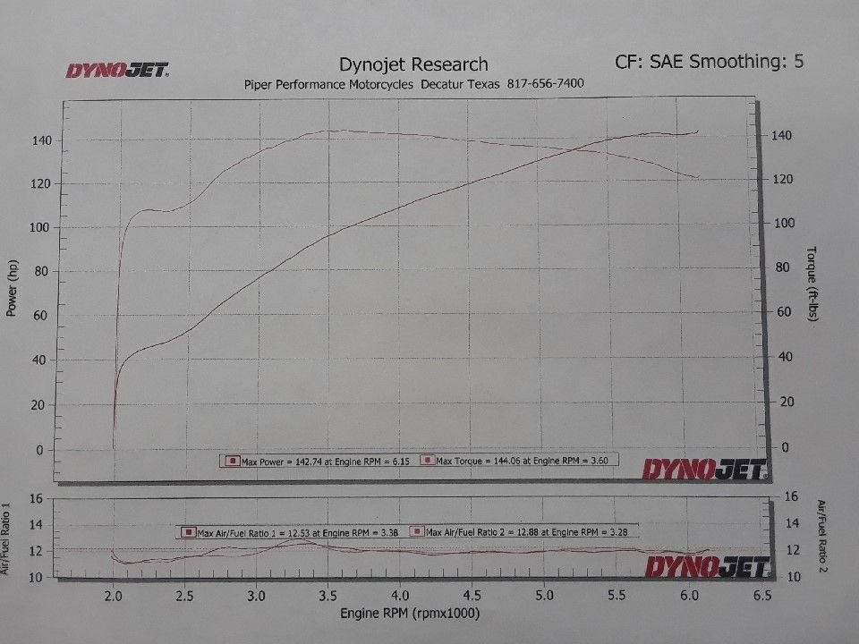

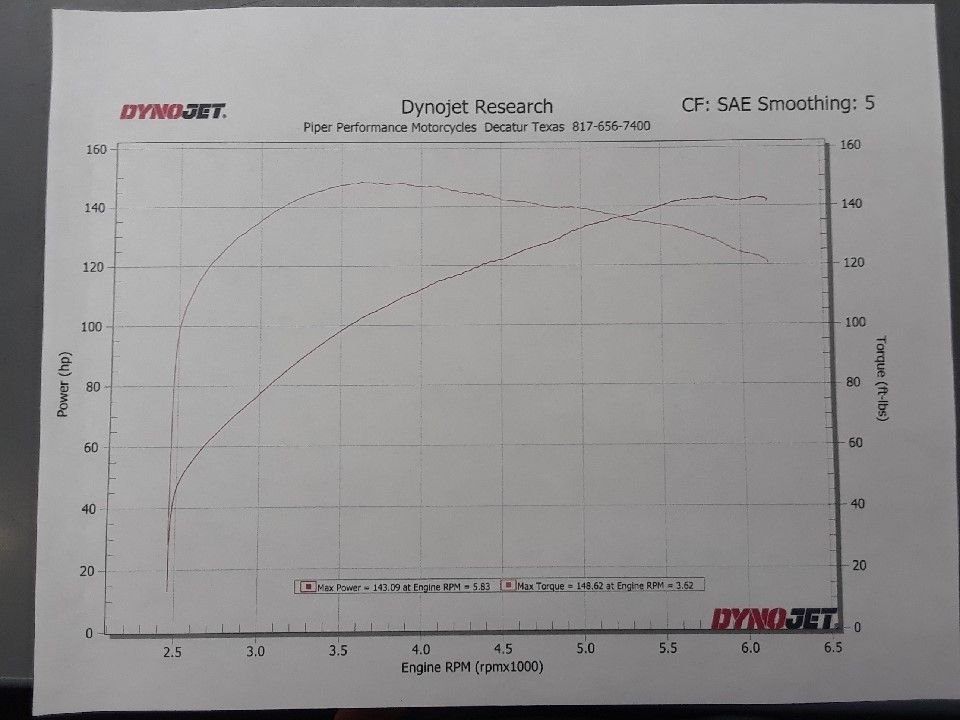

Here are the charts. 1st is 6th gear, second is 5th gear. I pick it up tomorrow. I'm thrilled to get great numbers similar to what you guys did. FM is selling a great combo.

Dang - that's respectable right there^^^

Got excited and forgot to post the specs:
2018 Fat Bob 114
128" Fuel Moto big bore kit
Woods WM8-408 cam with matching lifters
Fuel Moto Level A CNC heads w high lift springs
Screaming Eagle 64mm Throttle Body
Screaming Eagle 64 MM intake manifold - Ported (FM/Ward)
Screaming Eagle 5.5 gps injectors
Screaming Eagle clutch springs
S&S Oil pump, cam plate, and lifter cuffs
K&N / Fuel Moto modified Ventilator air cleaner
D&D Fat Cat exhaust
I did the build, and Piper Performance did the tune using TTS Mastertune

Hi-lift valve springs with that cam ?
Nice result
