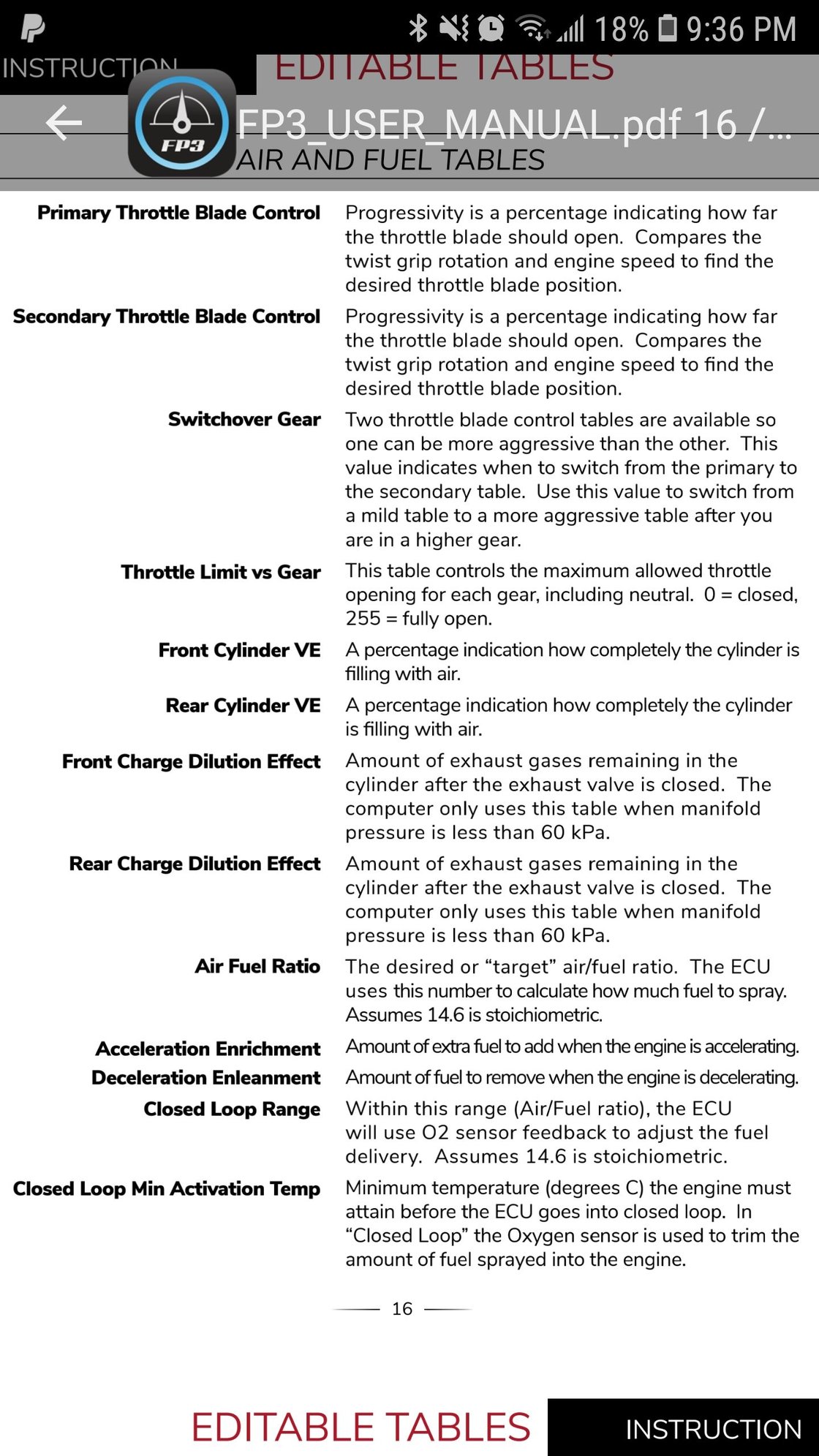

Fp3 screenshot
Throttle limit vs. gear .....anyone surpass the governor by tweaking these settings? I'm going to see what's up ..105mph in 4th ain't nothing...ran out of real estate

There are several things that need to be done to raise the limiters in the ECM properly. It is not just one thing. Get a Mastertune or PV and you will have the control your looking for.

I'd go with the PV at FuelMoto because of their reputation, service, and the PV doesn't lock/encrypt your map like I've heard that the TTS does.
