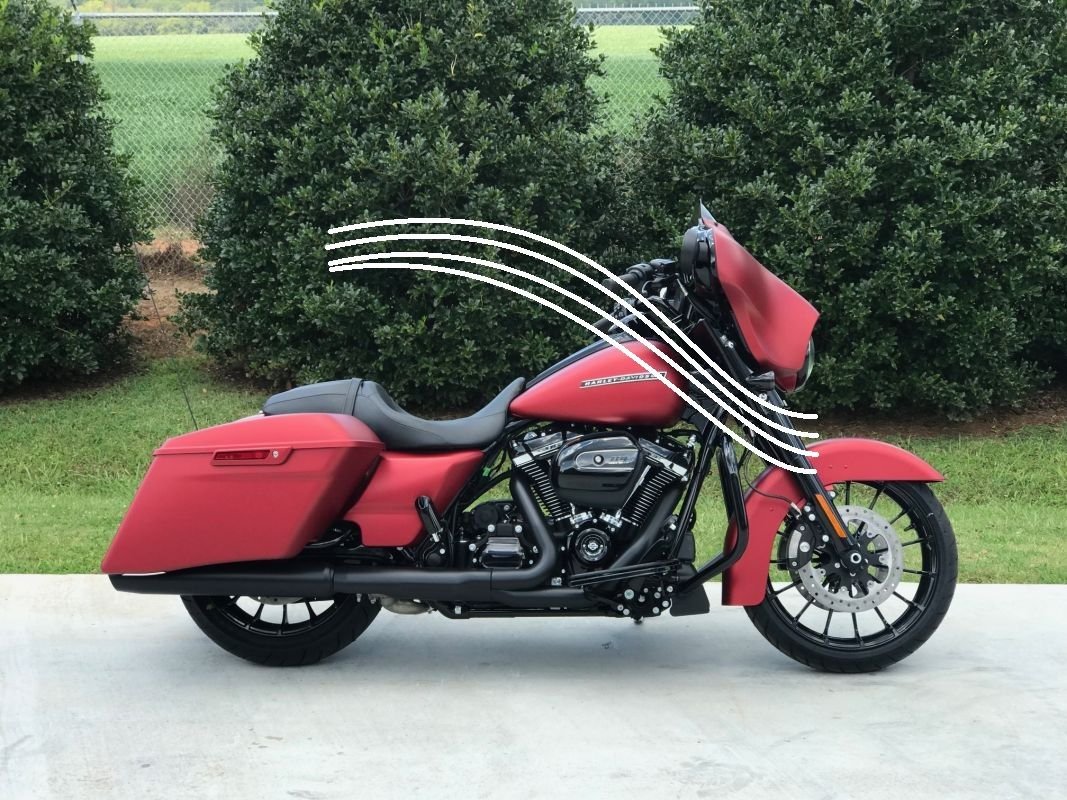

Rode the new SG M8 South yesterday to my Sisters house. At 70 mph I'm getting a Lot of air coming up over the tank considerably more Wind Buffering than my old bike is a RG. Reading on here I found the Wind deflectors. Looks like I'll order the one for the center of the fairing and the lower wings for each side. Not huge just something to get used to.

I have the wing deflectors on my '17 SG. They are more of wind directors rather than wind deflectors - no difference in buffeting with them open/closed. The only difference is whether you want wind blowing on your torso. The wind that is causing the buffeting is coming around the tank, which is a lower air stream than what is hitting the deflectors.

Since I'm a Amazon ***** I ordered the wind "re-directors". They should be here tomorrow.
