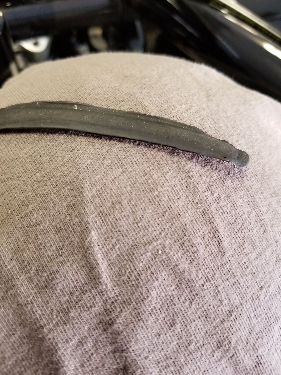

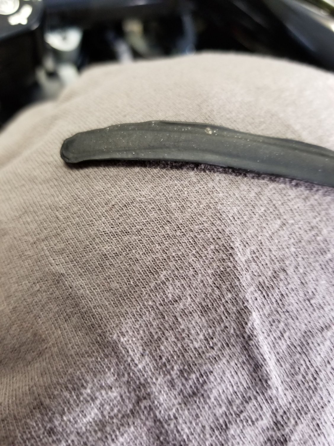

Here are the pics. I did contact KST by email this am. BTW, the deformed strip was in the slot, you can tell by the deformation. I did re-install and got my bars tight, but had to go way over the torque spec.
