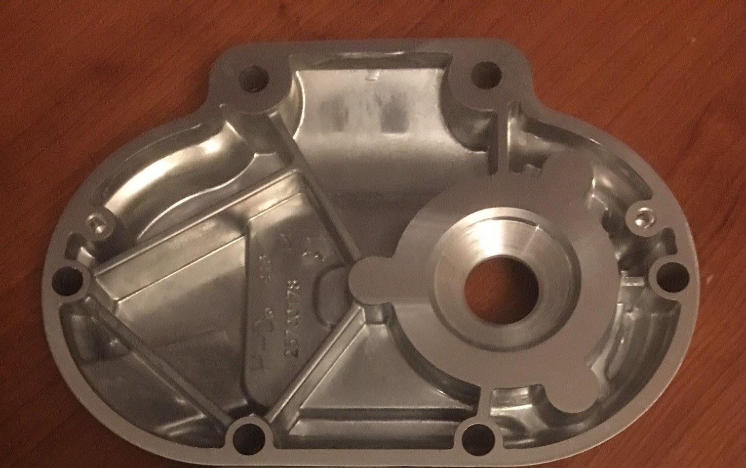

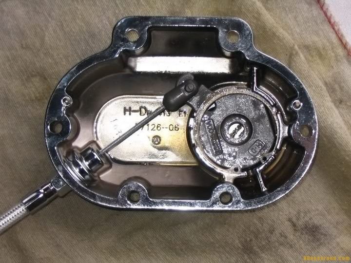

Originally Posted by Mart
Why is this touring models only? I thought the only difference in build is a hydraulic clutch.
The difference is in the side cover design.
The cable side cover allows the oil to drain back to the transmission. It is pretty well open.
The hydraulic side cover traps oil, if get past the hole and into the actuator cavity it is very hard for it to drain back, so if there is vacuum in the primary it will get sucked across.
Opening the actuator cavity and relieving it so that oil drains back has proven to stop the transfer problem.
