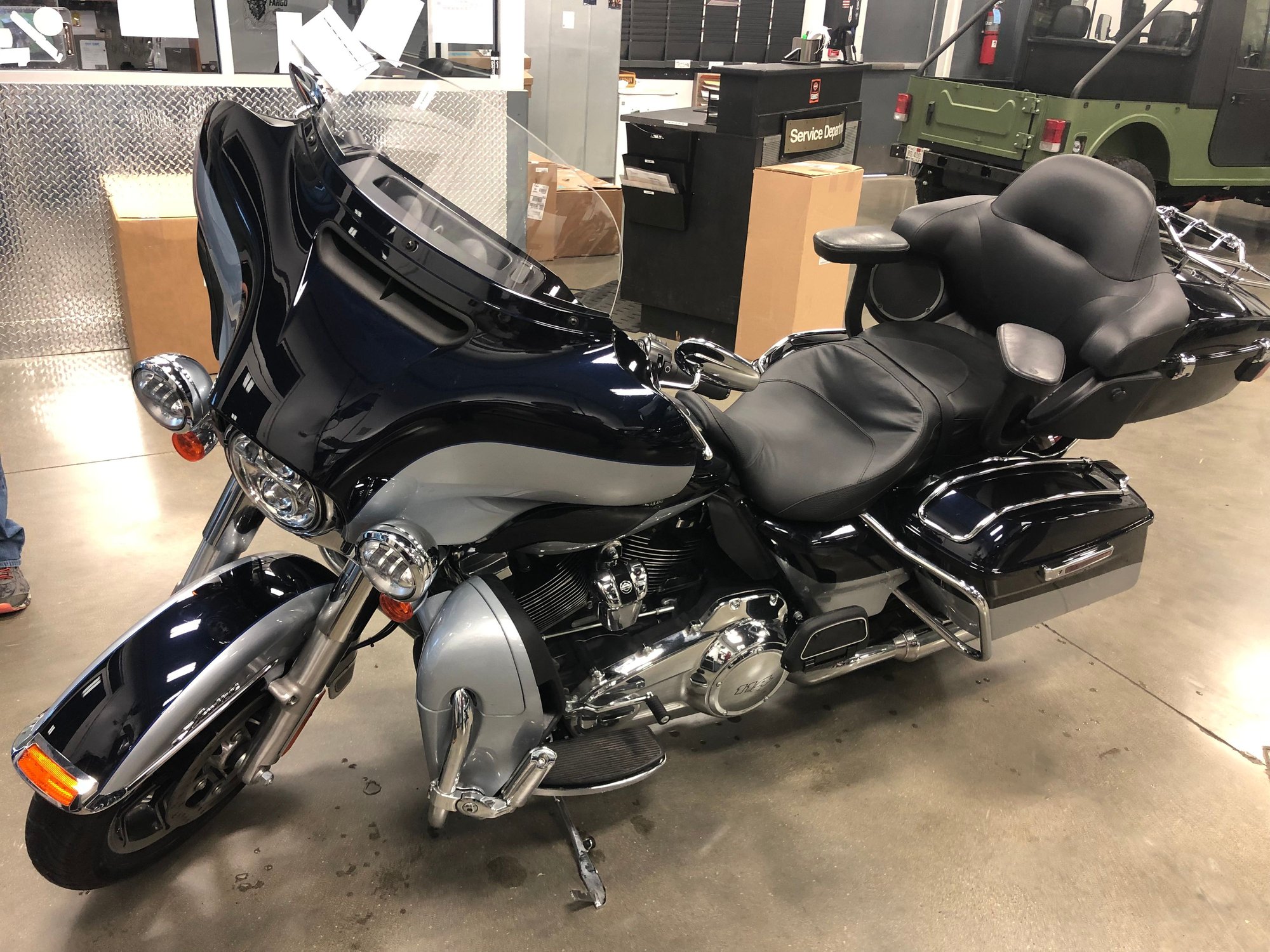

This one is a new toy, more buttons, more power, and therefore more tempting to play with, lol. I do have the patience to wait out winter, if I scrape it all together and check my sock drawer😀.
I have read a lot of posts, not all which agree with each other, and so have been checking my bike for signs of issues- this one being the clutch switch.
I appreciate all the knowledge on this site, and am constantly learning things I did not know.
Thanks for all of the replies on this post!

I really like the Midnight Blue/ Barracuda Silver color combo...they reversed it from last year...
