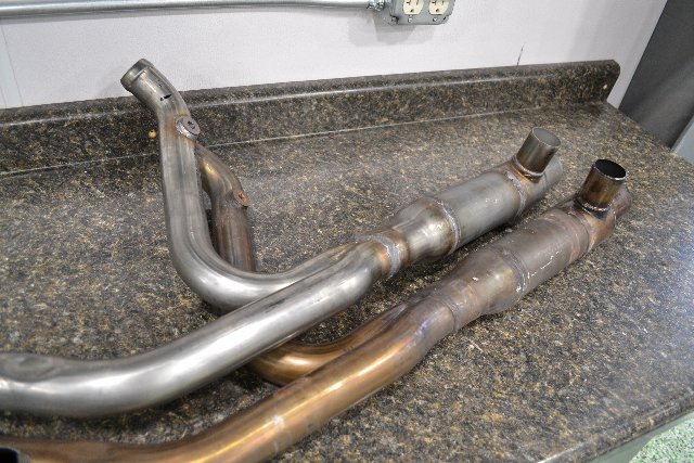

Originally Posted by Mofo67
Jamie, will you use the head pipe that came with the kit or something different? I assume the head pipe has a high flow cat and a larger collector than the normal head pipe but still uses the stock heat shields. My local dealer has not been able to find out if an aftermarket head pipe will fit or not. In the HD listing it states you can not use the SE high flow exhaust system.
Looking forward to more information and results.
Our initial testing will be the SE Stage IV kit as delivered. The SE supplied pipe appears to be exactly the same as the OEM head pipe with the exception of the Euro4 stamping.
Top> SE pipe supplied with 131 kit
Bottom> OEM head pipe
hope you're using the SEPST as a baseline for folks, first do the ecm calibration, then dyno tune that with SEPST..then you can work your magic in stages so folks have a good understanding of how much you will improve upon it with upgraded components and tuning, etc

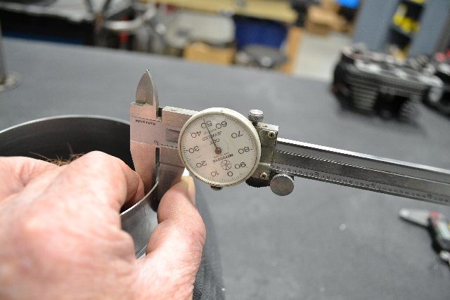

cylinder spigot thickness coming in at .049"
