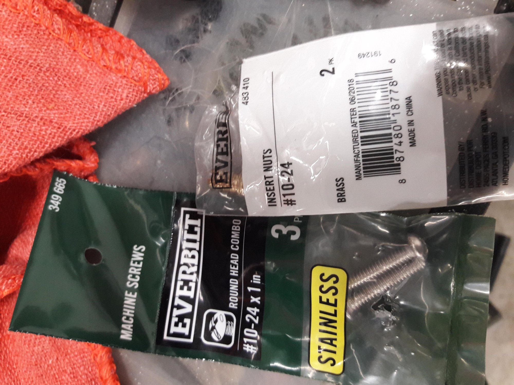

I cross threaded it so badly that the insert turned in the plastic housing when I tried to unscrew and it just pulled out.
Here are parts from Home Depot I used. This is a 2020 Road Glide Limited, not a bat wing. Speaker pod is $80+, these parts were less than $5.
