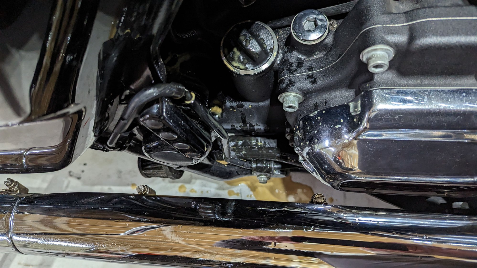

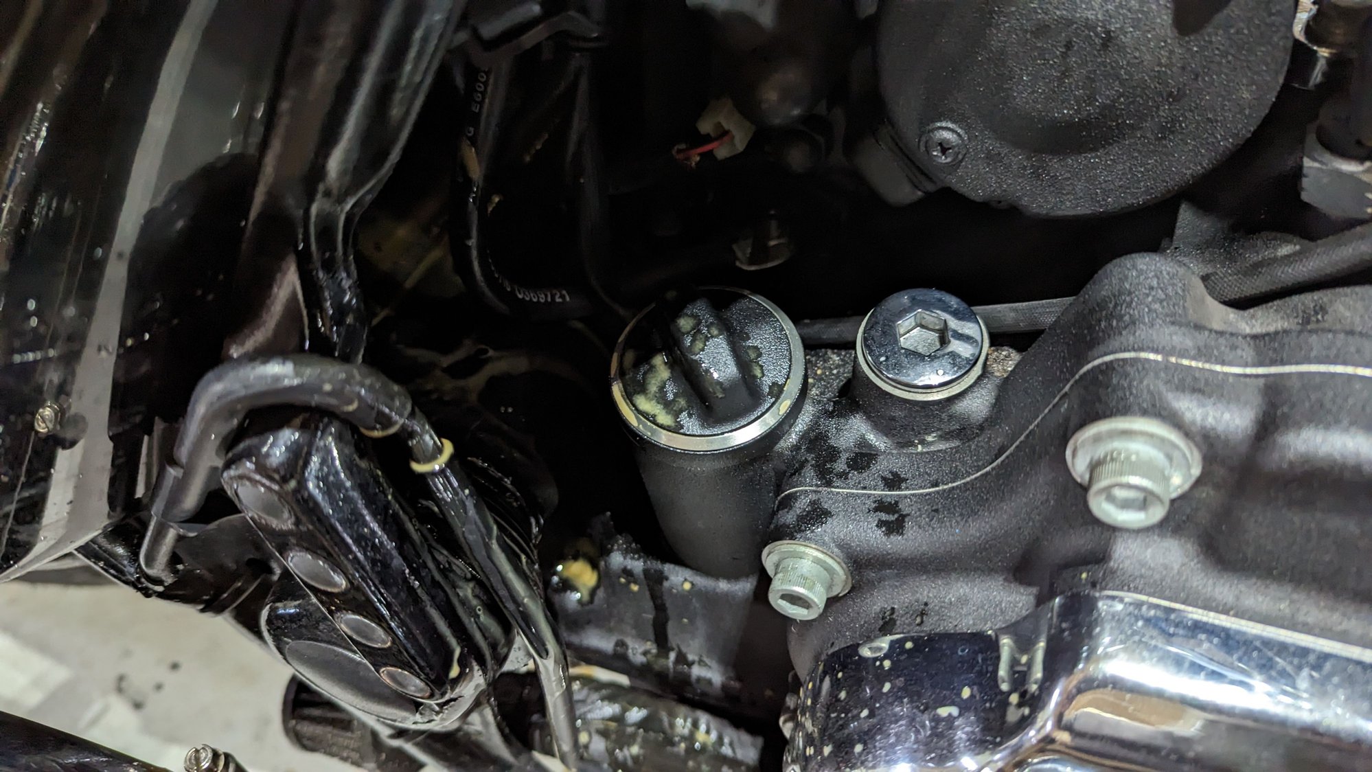

Case study of what happens if you don't have the oil pump seal.
