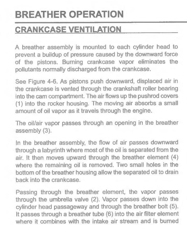

In the second paragraph of section 4.6 of the 2017 touring service manual, it states the "displaced air in the crankcase is vented through the crankshaft roller bearing into the cam compartment". That was printed before they put a seal on the back of the oil pump.
I am curious what the later models service manual says now about venting the crankcase with the oil pump sealing off the bearing.
The 2020 manual states exactly the same still; however, we know it's pretty much sealed off to some extent (to keep some amount of pressure in the crankcase to keep the oil return feed positively fed), and that the crankcase also can vent through the cam bearing.
Any pressure the Check M8 is relieving, which has already bleed out of the crankcase into the Cam chest/Oil bag/heads, obviously doesn't do anything to help with sumping but does help eliminate a ton of oil vapor in the air intake.
