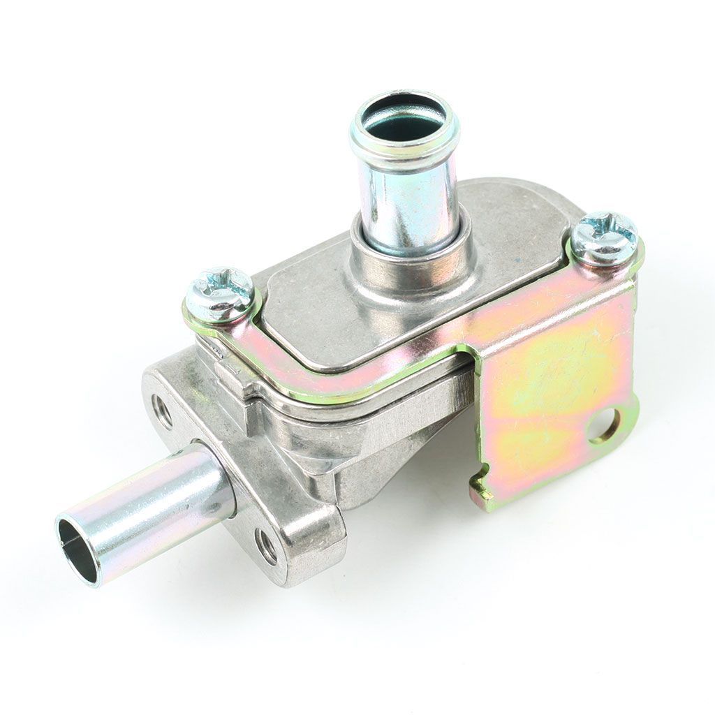

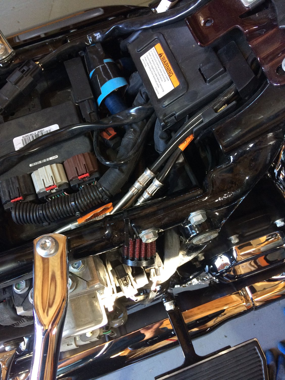

I did the DIY version, 2018 Road King, metal trans cover. Drilled 21/64 and tapped 1/8 NPT, used the 5/16 fitting from my DYI vented dipstick. Drilled two holes in the cover gasket. Back to a normal dipstick no more hose hassle. Trans cover screws have compound on them - a tedious removal.
Bought a PCV reed valve & tucked under the seat, pictures attached. Reed valve ports are approx 1/2 inch.
Ported trans cover
Reed valve wrapped and nested.
Reed valve, I removed the bracket. Screws were tight needed vice grips.
I ditched the plastic check valve I was using, the reed valve is much less restrictive. Wrapped the reed valve so it won’t abrade the wiring or frame. The vent filter is in the same place as before tucked in near ABS unit.

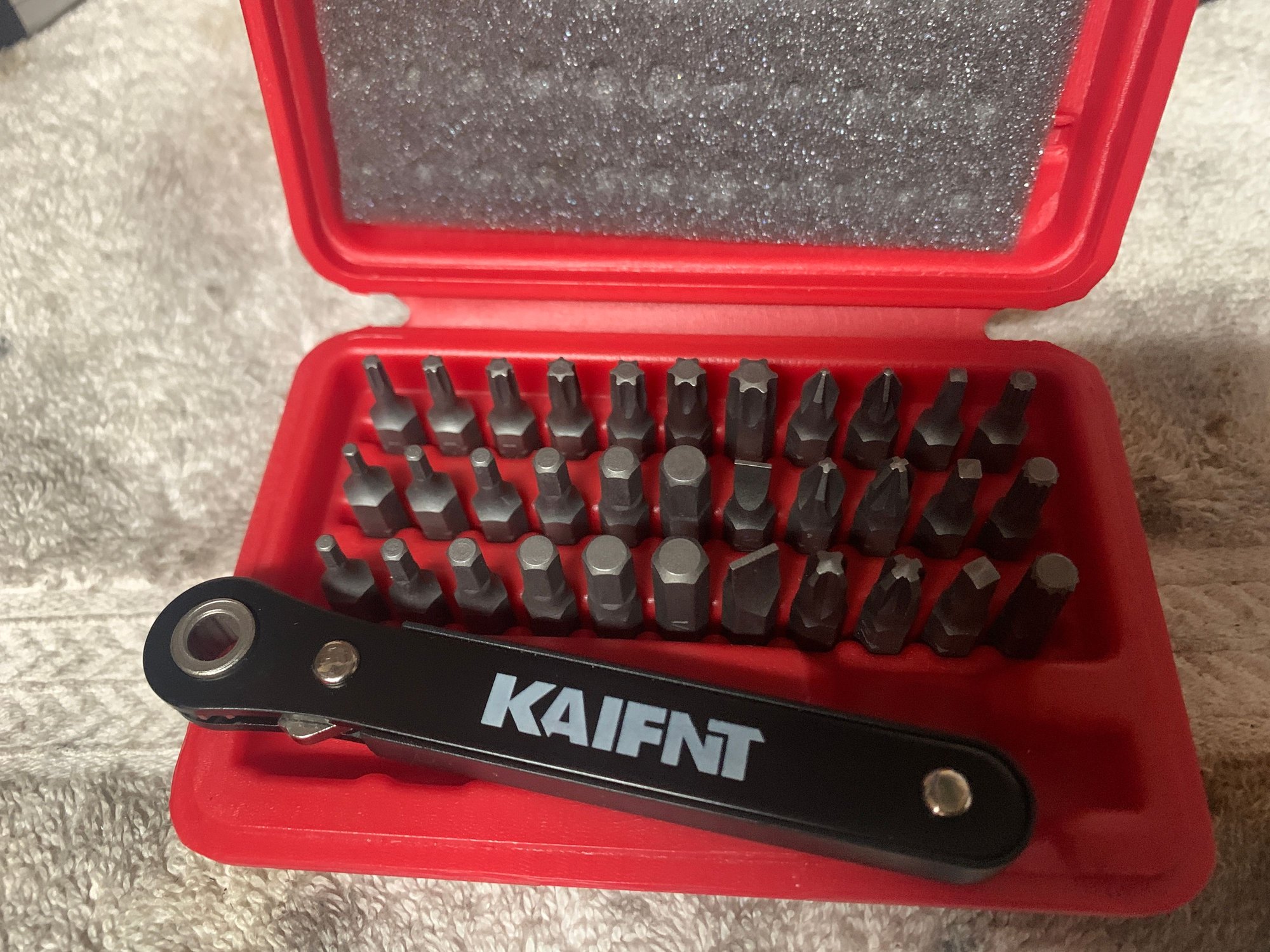

Originally Posted by 702
He had a small ratcheting allen wrench.
A small ratcheting Allen wrench? Please tell me more. I'm not familiar with ratcheting Allen wrenches.

Old Oct 15, 2021 | 09:22 AM
This is a set that I have --
