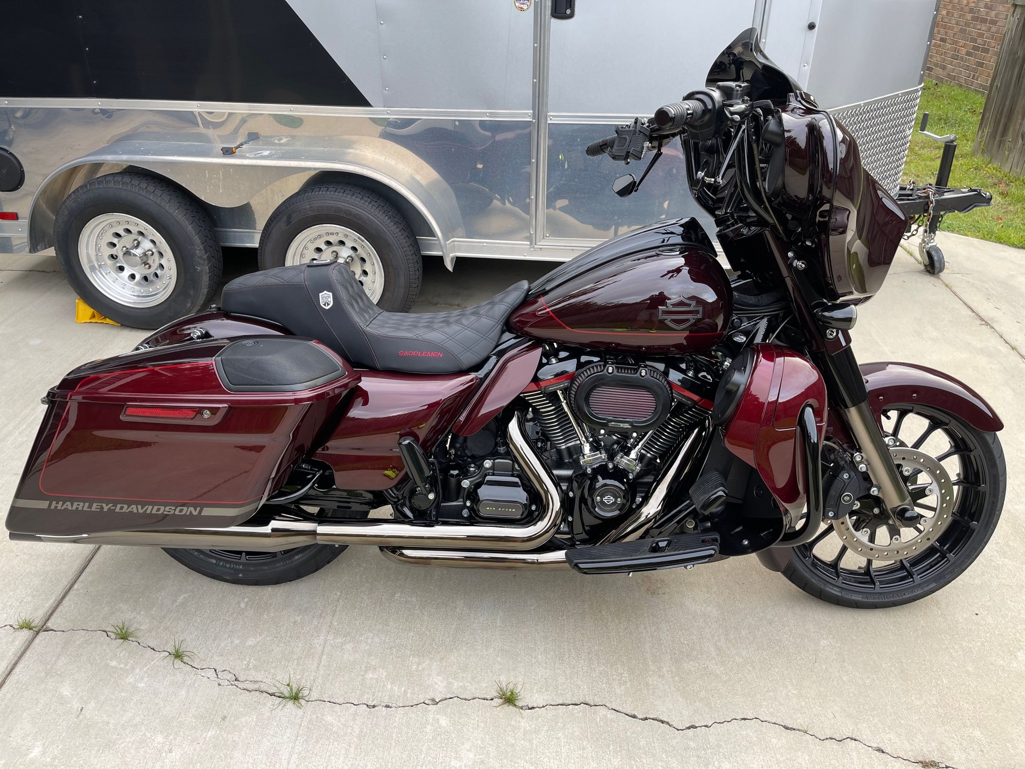

Actual true duals will most likely hurt. There are several pipes out there that look like true dual but actually have a collector, I would suggest going that route. This is a pic of my bike with a full Khrome Werks 2-2 performance system, looks like duals but it has an H collector that performs great on the dyno.

Very nice looking
