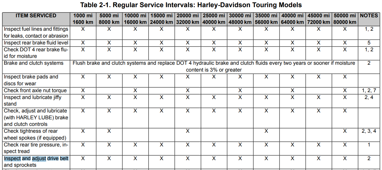

Riders have gone over 100k miles before on the original drive belt. I would say as long as there are no holes, tears, or rips--it should be fine.
If you did your research on the maintenance manual, it doesn't really list an interval on changing the drive belt, but rather always inspecting it at each oil change.
Here is what the maintenance manual says:
Maintenance manual schedule for drive belt -- just inspection
