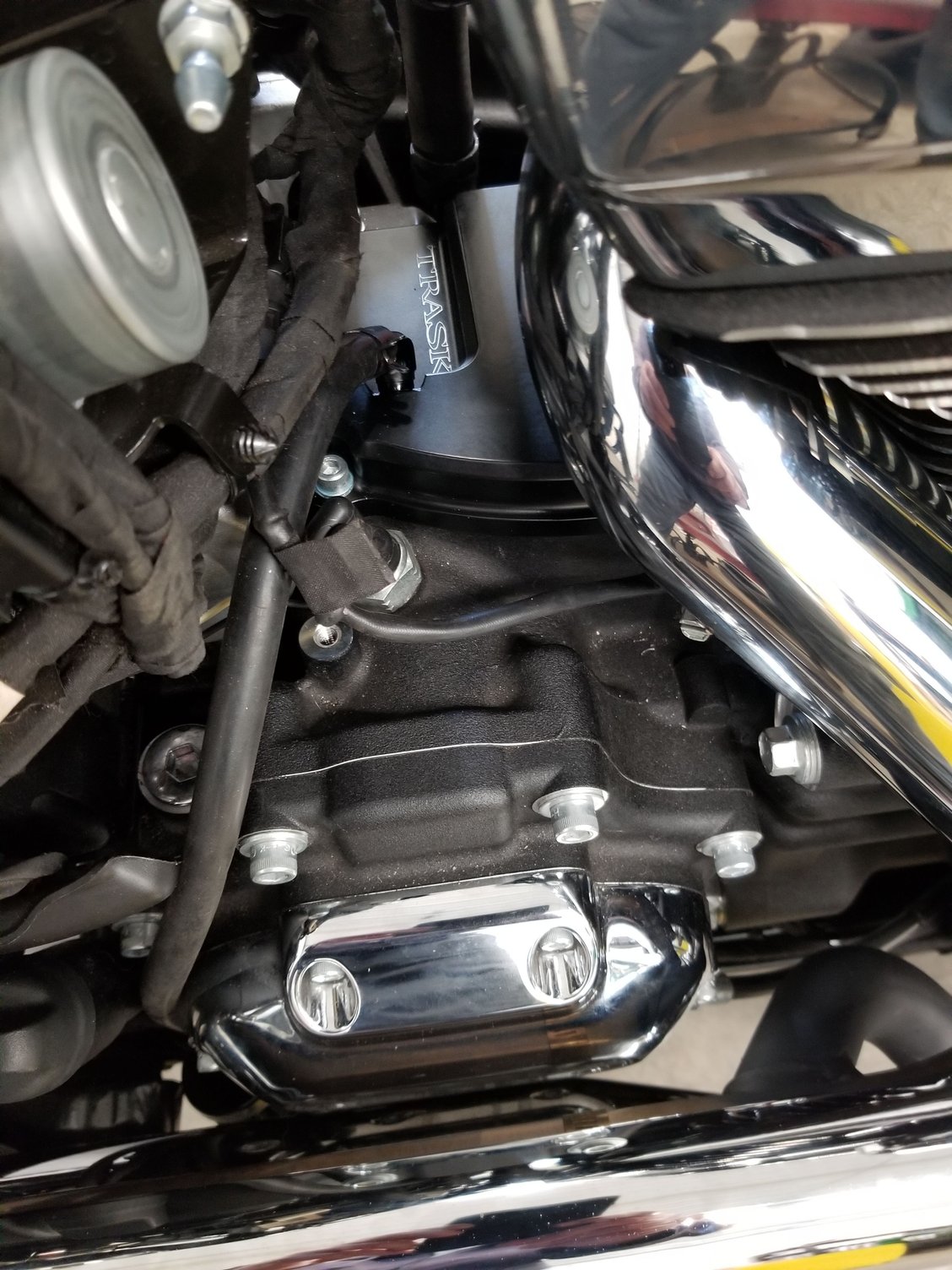

Put it wherever you want of course, just know that Trask installs it up high. In my case above the ABS Module behind the right side cover.
Meet "Moots", he's the guy that developed the Check M8, and is the guy that installed it on my bike (pictured).

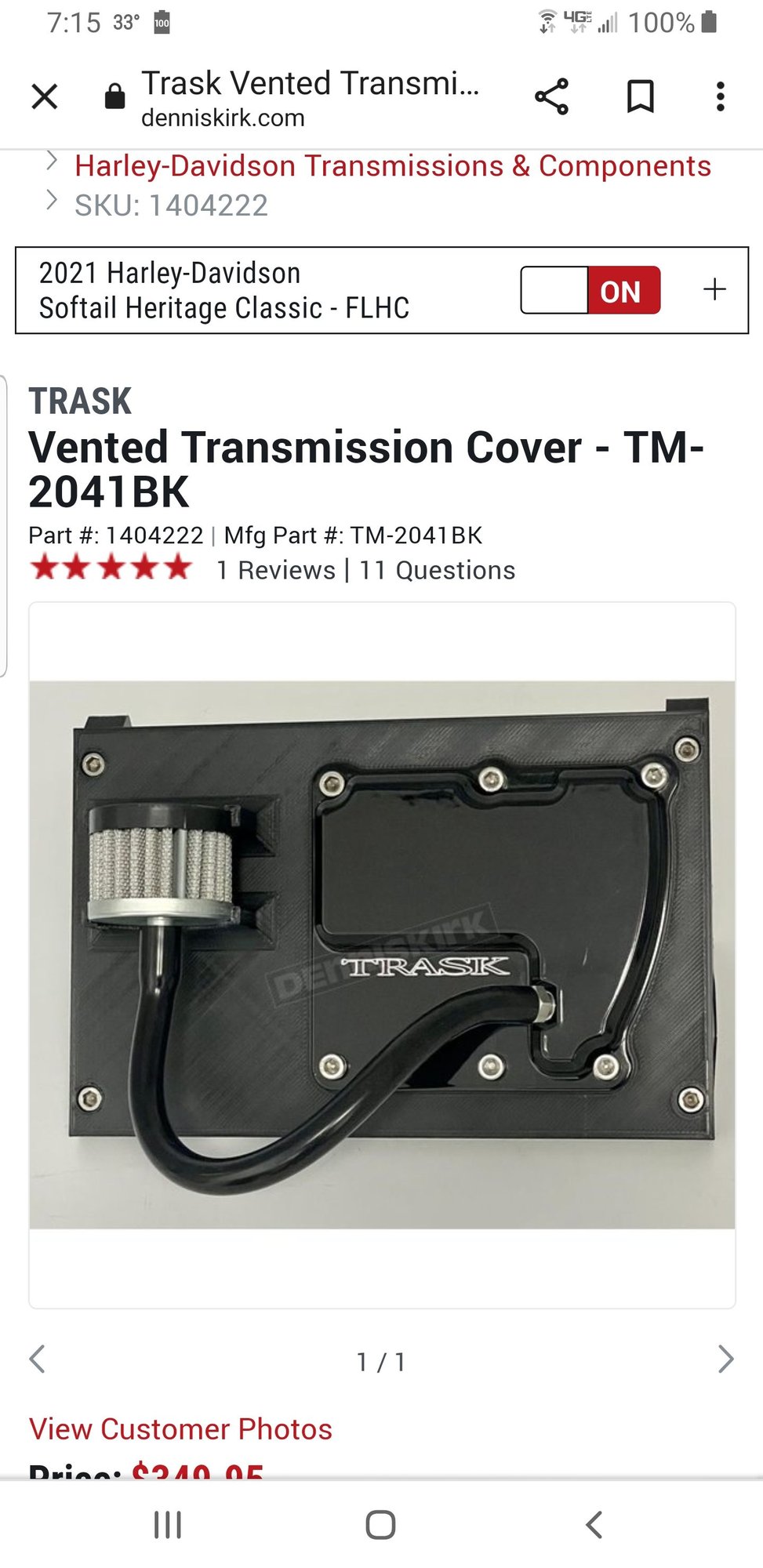

Huh. Wonder why they show it mounted horizontally on the cover?
That's a marketing photo for their website, it doesn't mount there. Call them, maybe it doesn't matter.
Excellent idea. If the install kit doesn't state preferred orientation, I'll call and ask, and report back here.

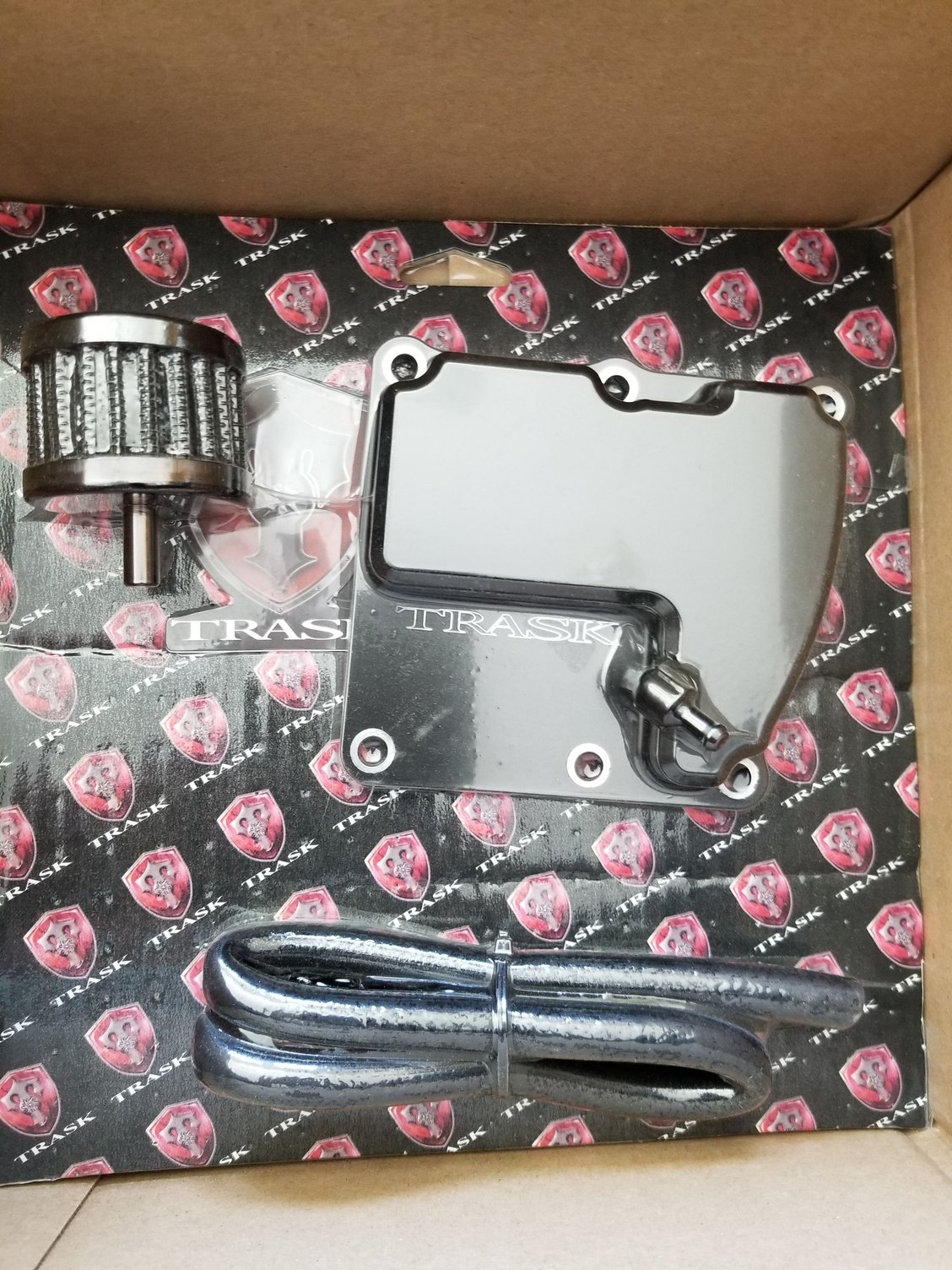

I received my Trask CheckM8 today. Confirming there is no assembled layout as-received.
I plan to call them and ask what is recommended, if any.

Thanks for member advice. I didn't hear back from Trask yet so decided on vertical down install.
Could have done without inch long Grade 8 fasteners slothered with loctite for just a cover seal with minimal tool access, though.
