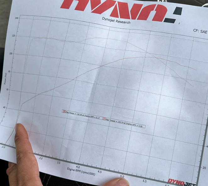

most of the DROP in CAMS, when review dyno graphs, only do what you are asking...MAKE MORE POWER...in higher rpm situations. based on the graph below, that bike needs to shift around 6200, that alows the rpm drop in the next gear to be on the come up of the power range again.

Wow that's a flat torque cam about 3.5k rpm!
Looks like ~ 4-4.5k rpm shifter to me to keep downshift around torque peak.

Here's my dyno graph. Thought I might as well post if the site lets me

Based on that chart, for strong acceleration you'd want to shift so that the bike is turning over 3,600 RPM AFTER shifting. That's where the torque is the best. Not that it makes a massive difference; you've got 120 ft/lbs from 2,000 RPM on up, but you hit 130 at about 3600 RPM so shifting which keeps the engine in the peak torque band should make it take off like a rocket.
