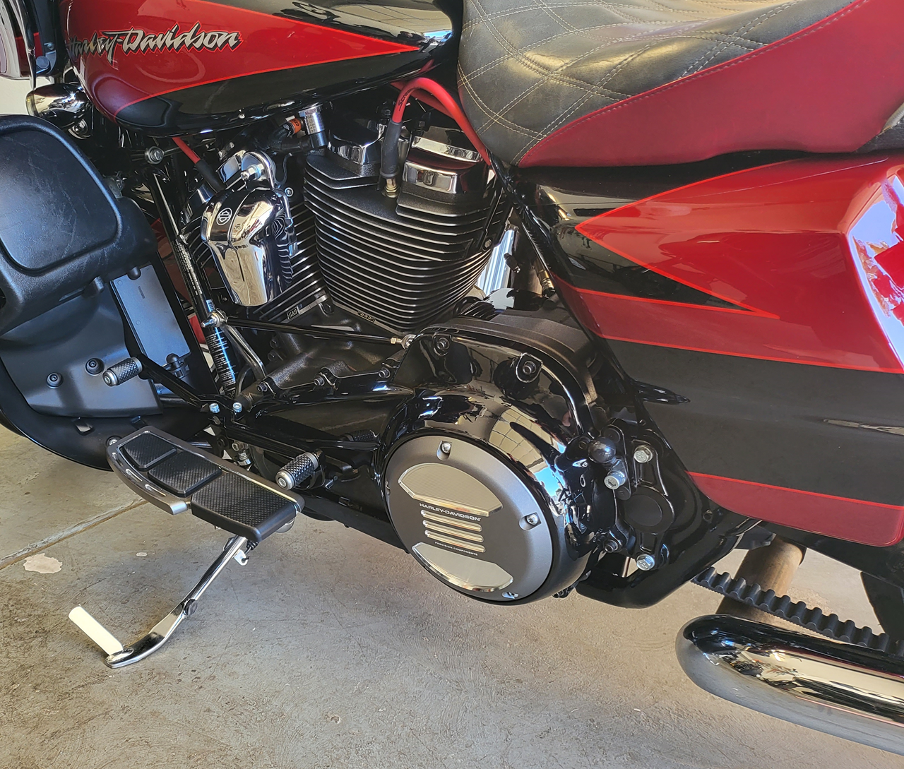

It has been a while since I've had time to do much to my M8 except ride. In my last major upgrade, I built a 128" motor, upgraded the primary with a Rekluse clutch and a Baker compensator, replaced the front and rear suspension with Legends, and upgraded my brake calipers and pads with Galfer. I documented that entire process in this thread.
With one minor exception—the Rekluse clutch—the entire build has been flawless. After 29,000 miles on the build, I've had zero failures. That said, I'm not exactly satisfied, either.
The Legends suspension is a night and day difference over stock. The ride quality is good, but I wouldn't call it excellent for a sporting rider. I will get into that more later.
The brake calipers have held up well (no more warping issues), and once I got the right pads, I got more braking power, albeit at the expense of a progressive feel.
The engine has been great. It's silky smooth and very quiet. My only complaint is how much I must shift when riding in the twisties. The little bobber I built two years ago has spoiled me with its roll-on power, even in 6th gear.
Finally, there's the Boom II Audio. What can I say other than it sucks! I made a minor upgrade by adding sound deadening to the front pods and replacing the 6.5" mid-bass speakers with Hertz MP165.3s. That update put some punch into the system that you can hear and feel at 65-70 MPH. Unfortunately, my head unit is starting to crap out on me. The GPS stopped working a year ago, and now the display is flaky.

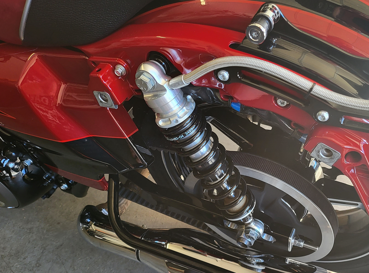

I have already started this project. One of my dealers had multiple sets of the SE/Ohlins rear shocks in stock that weren't moving. They offered me a great discount, so I picked them up. At the same time, I ordered a High-Lifter Chromoly swing arm from A1 Cycles.
I have about 300 miles on the new shocks and the swing arm. It's a night-and-day difference in feel, traction, comfort, and lean angle. Once I got them dialed in, the Ohlins shocks made a big difference in my cornering confidence. The wheel hop I experienced with the Legends shocks cornering on rough pavement is completely gone, and I am less fatigued after a long ride.
I have no idea how much the swing arm contributes to the shock's handling characteristics because I swapped them simultaneously. I'm sure it does have an impact because it's 11 or so pounds lighter than the stock unit. Here's a photo:
I have the shock connected to the middle mount point and have extended the shock adjuster out 1/4". To get to that shock length (equivalent to a 14.25" shock length) I had to spacer the mufflers down 3/8".
Currently I'm at my summer home in Prescott, Arizona getting a feel for the new suspension riding on Arizona 89A, which has excellent mountain roads with fantastic hairpin and switchback turns. Before making the trip out here a few days ago, I went through Oatman, Arizona to get to a stretch of road on Route 66 called the Sidewinder. With its tight hairpin turns and overall bad surface quality, it's a good test of your suspension.
Here's a 2LaneLife video on Jerome to Oatman. I rode Prescott to Jerome yesterday... didn't scrape my floorboards once. That's a first!
Lifting the rear as high as I have has introduced a bit of "pull in" in the front suspension that's noticeable in tight turns. I'm going to drop the rear by 1/4" to see if that goes away. If not, I'm going to see if my steering head bearing needs to be adjusted.

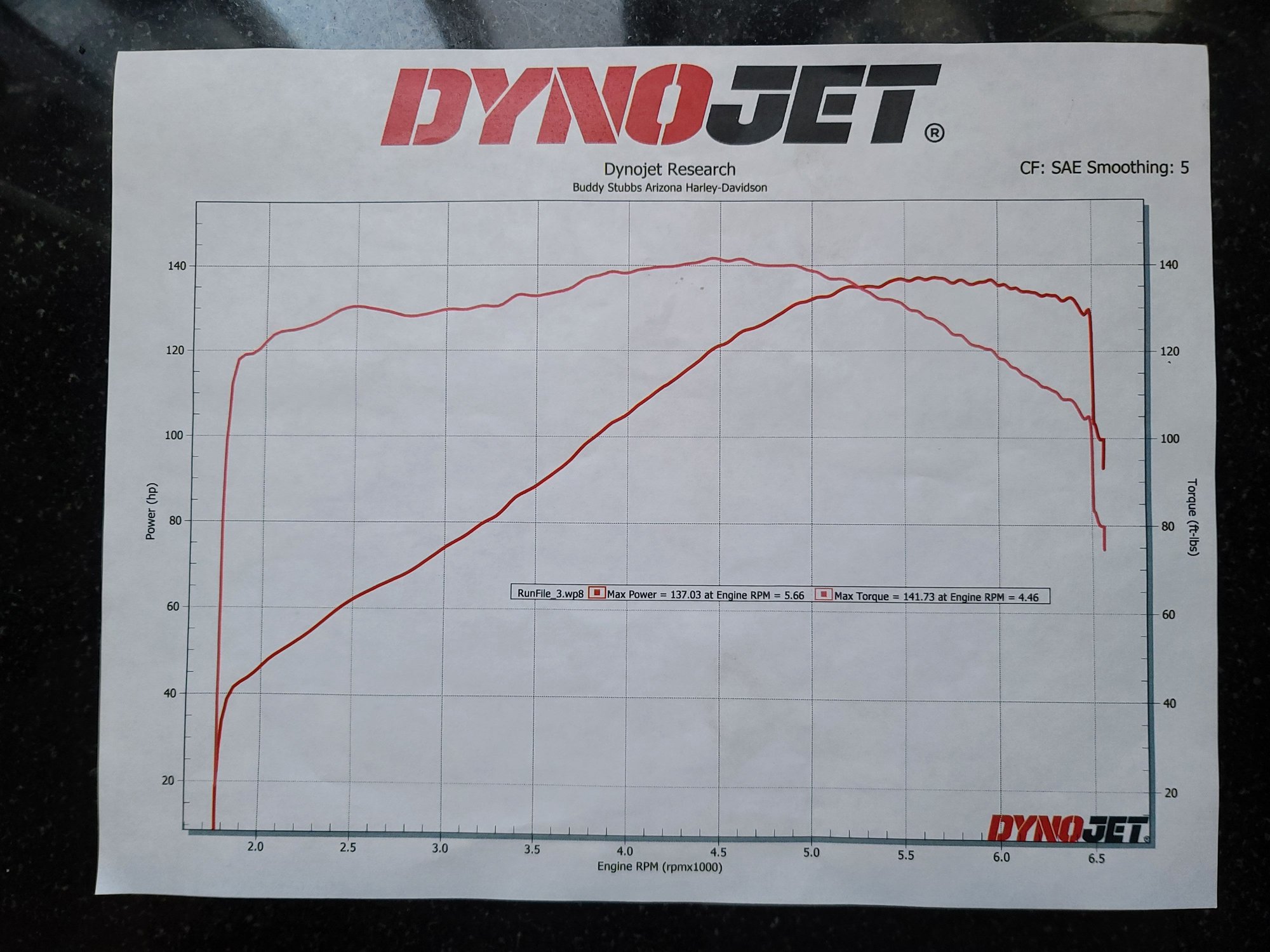

I did my 128" build on top of the Stage II upgrade I did in 2018. That saved me the cost of a new cam, lifters, push rods, bearing, etc. Besides, I like the Woods 222 cam characteristics and wanted to go easy on my valve train.
How do I get more power, particularly at the bottom end, without giving up the quiet, smooth power I have with my current 128" build? Here's what I have now:

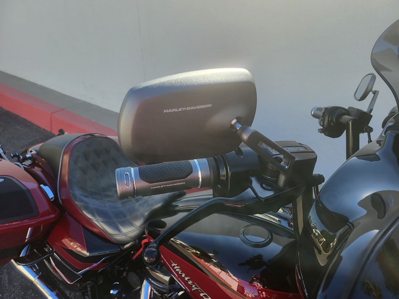

After 7 full years with this bike, I am ready for a style change. From the factory, this bike ad a bunch of chrome. Over the years, I've toned it down a little bit by replacing a few bits and pieces, like the shift levers and rear brake lever, but I also added more with a custom CVO derby cover.
When the Adversary Collection accessories first came out I grabbed some (Black & Orange) for my Pan America Special. They look and feel great. The mirrors are excellent. So I decided to give my CVO the same treatment in Graphite. The color perfectly matches the logo on my tank and goes well with the Black Granite engine cases and my Corbin seat.
Here are some shots:
I really like the Adversary Collection accessories. It was (IMHO) exactly what my bike needed for an easy style refresh and I'm finally happy with the level of chrome.
Next up is to paint and install the ST front fender I have sitting in the garage. I have the black paint and the metallic pearl (Starfire Black), but the Atomic Red isn't available. So I working on how I can have it matched.
