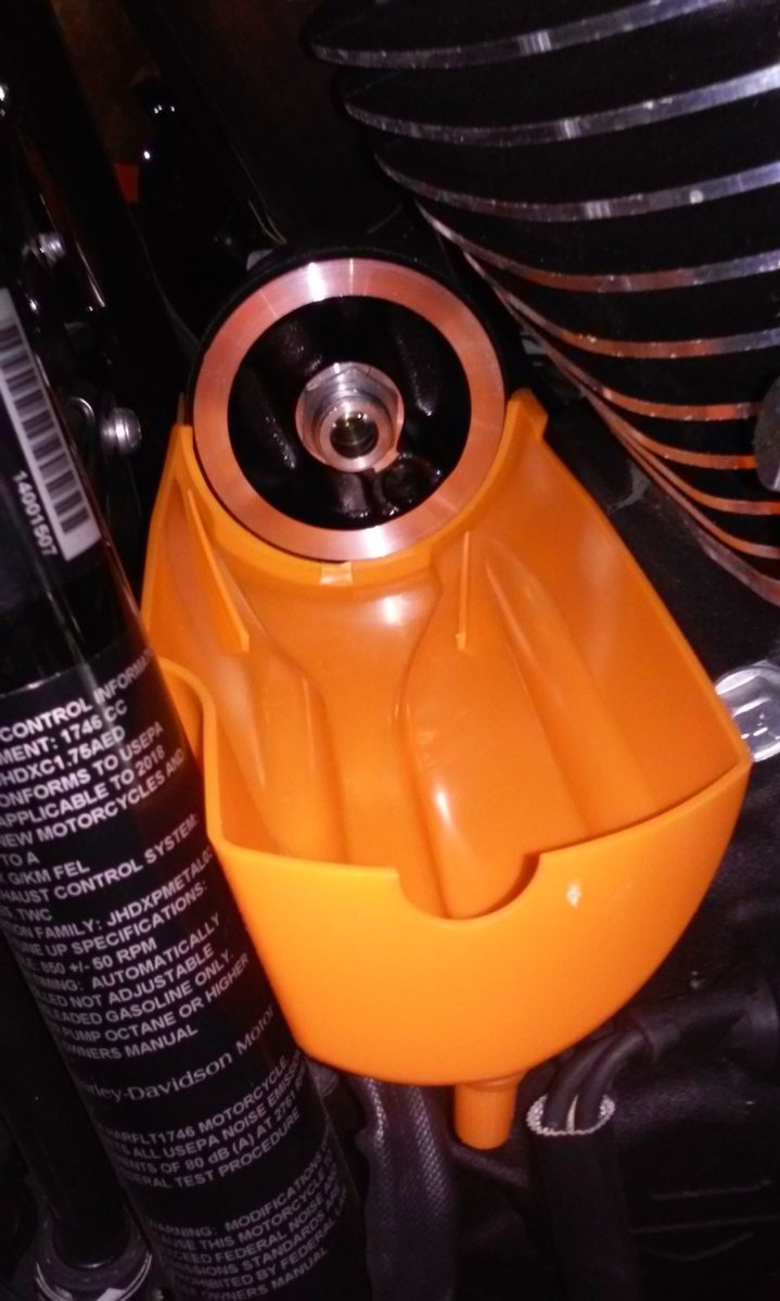

I just use the HD drain catcher, it clicks into place..first I stuff a couple of square cut up pieces of bedsheet under it...remove filter and drain catcher, then cloth pieces and no muss no fuss on bike..easy peasy no addt'l cleanup necessary

yep thats the same thing i use but that cheezy plastic trough falls off easily and next you got a big oil mess on the lift and floor!! but to each his own!!

that's never happened for me...snaps / clicks into place and always stays put until I don't want it to...works like a charm

Are you talking about the M8 funnel, or the pre M8 version? I've used both, and could never get the pre M8 version to snap/click/catch onto anything on my Twin Cam. The M8 version works great on my M8 however. A slight twist locks it firmly in place.
yep I agree the pre M8 funnel for the twin cams is a joke it hooks to nothing!! glad to hear they made it fit better for the M8's
