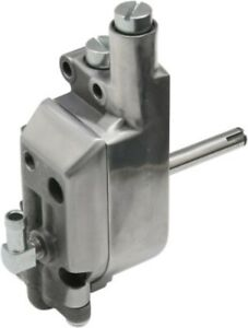

From the pic above, you see this screw? Under it is a spring, and the ball under that.
Lapping means getting that ball to seat cleanly in the pump bore without sticking. It's a simple fix...about 5 minutes.

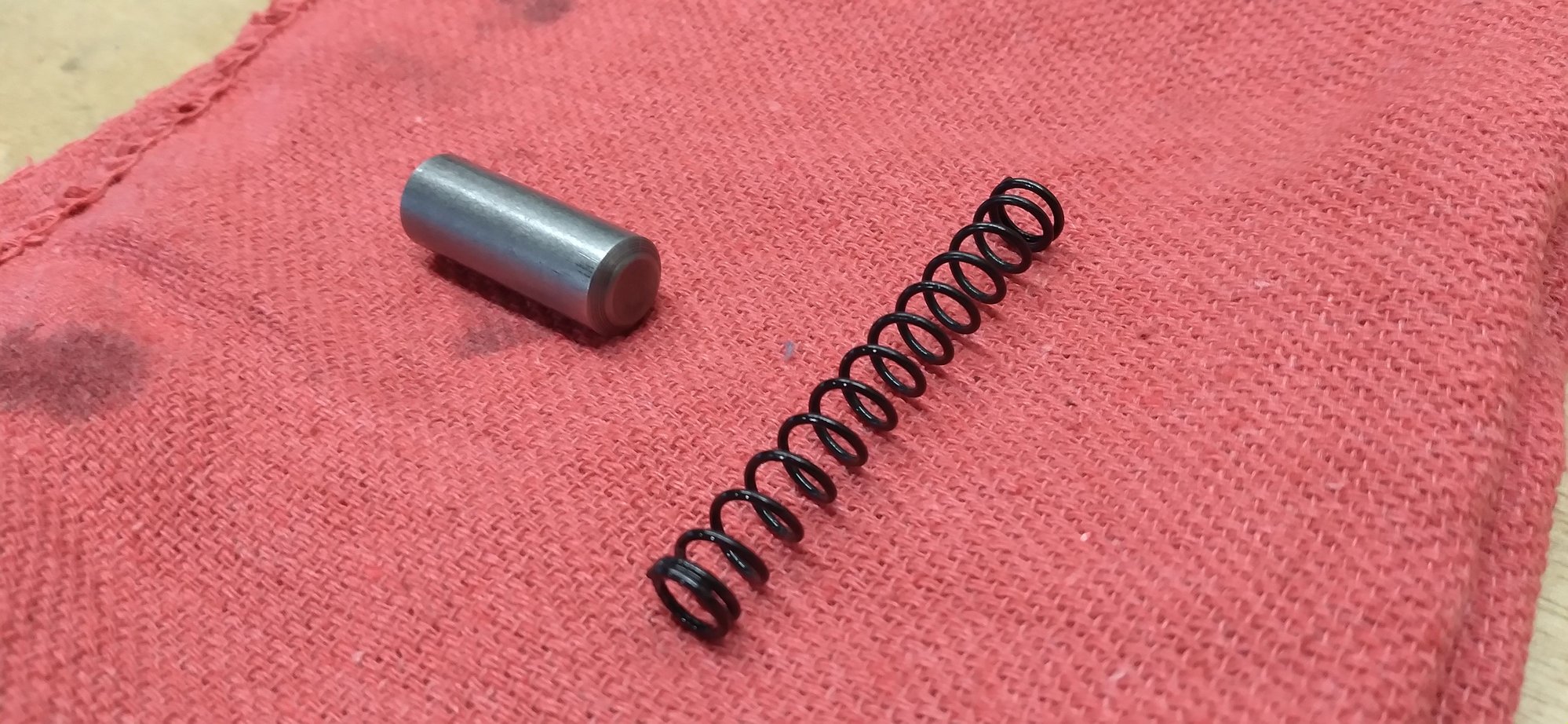

This is what I got. And I'm assuming all the oil coming out is normal.
Thank you Sir, Bob

It's the other big screw behind that one. Probably just needs to be cleaned and re-installed.
