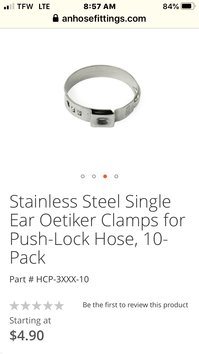

I run SAE 30R7 oil hose from Jagg's Oil Cooler and Oetiker stainless steel single ear clamps.

I'm using J2076 on a current Shovel project, which is very similar to J30R9, except the pressure rating is a little higher (175 versus 100 psi). Max temp is the same. In the past I always used the screw clamps, but this time I plan to use crimp clamps for a cleaner look.
