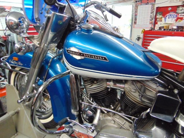

well I see a few mis steps with it
1 it has the incorrect year gas tanks as in 1966 right side petcock - correct are 2500 and UP as they like the 66 are one year
2 this confirms what I thought first up its not the right color, as its a re paint and it looked off to me
3 the handle bars are replaced to 1973 and up series and they are also aftermarket not oem - original bars are internal throttle
4 this also means the 1200 dollar 65 linkert carb and the air filter in and out is also a pricy thing to find
5 the mufflers are later shovel as well
not having posted the pictures -- its not as easy to just scroll up and look -- the other guys will see more as more is
nice looking machine BTW I will find the 65 I did last year that we turned down 40,000

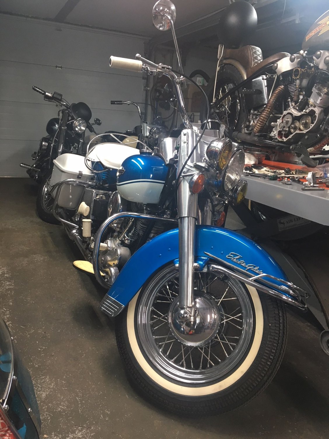

I have this is my shop so any pictures you might need I can proving

correct petcock top of the tank in front of the tank cap
