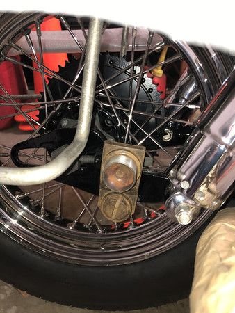

Could be the angle but is your rear side car tube on the frame flattened out?
That piece of the frame is definitley flat on the underside. Not just flat but worn through on the bottom. Couldn't figure out a way to make it look right with a fix, but let it slide since it has no bearing on anything as far as putting the bike and sidecar together.

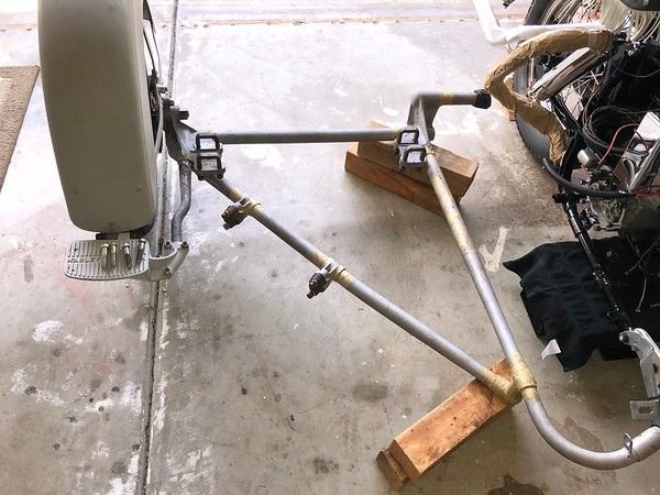

Side car attaches in these three places; that tube has no function
Upper and lower on the front down tube
Rear mount attaches to the swing arm

Whats the purpose of that tube then? I always thought it was sidecar related, just learned another thing about these bikes.
What does the sidecar frame attach to at the rear of the bike? I can't tell in the pic.

'58-'72 they used this hole off the rear fork
and used this bolt and clamp (nut attaches on the inside)
In 73 with the change to the squared rear fork, they added a two-piece clamp and then in 79 it appears to have changed again as did the brace that goes from the sidecar frame to the top clamp. The two components that appear to have remained constant are the upper and lower down tube mounts.
