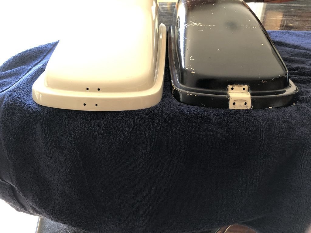

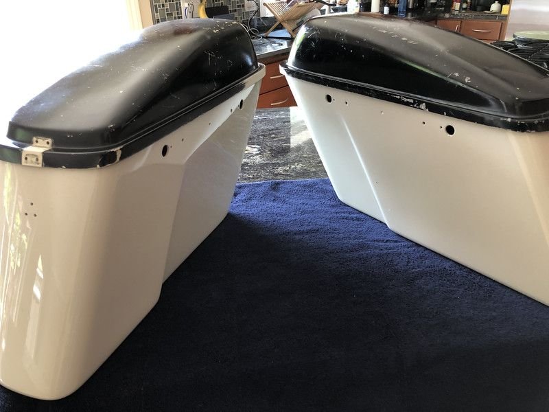

Saddlebags...and the learning curve deepens
Lid for stepped side bag on the right and lid for smooth side bag on the left.
Smooth side lids are a loose and sloppy fit on the step side bags. Step side lids do not fit on smooth side bags. When matched correctly they are a nice fit.
Palmers Vol 2 discusses seven variation of the bags (63-68). Time to read and digest it more completely. Unfortunately the pics of the variations are absent. And the parts manual is not exactly clear to me either.

to me the black are correct in visual as they were designed for more storage - ie radios - gear - ect
