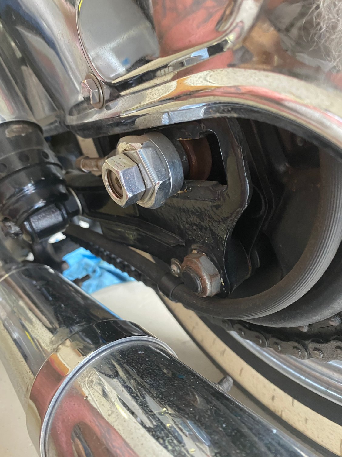

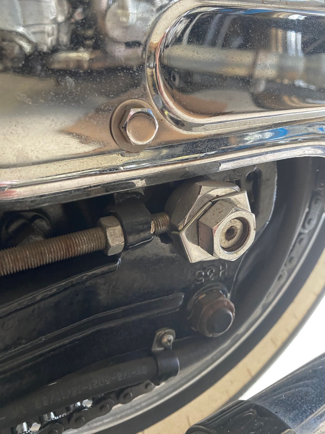

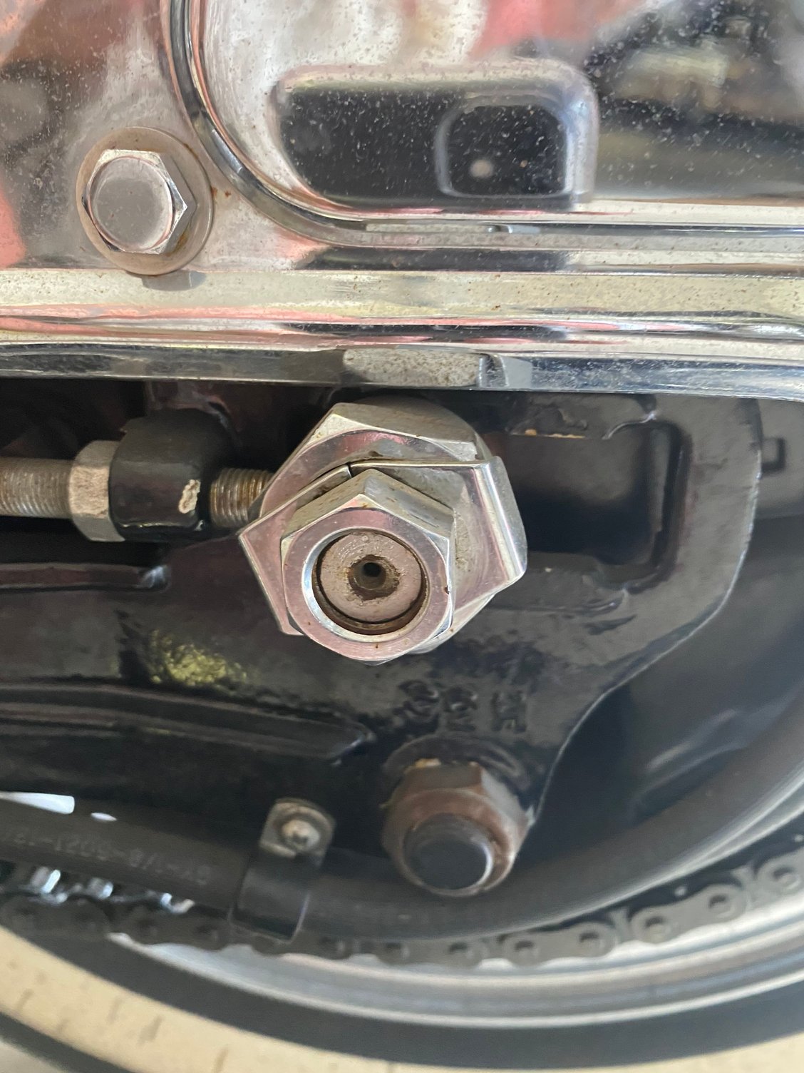

Speeding BT - As I stated to Panz everything appears to align with his picture and with your descriptions above. I did find the 34703 65 number on the bottom of the trans case. Could not see any other numbers. The anti-theft number on the front of the trans case shows it to be an early to mid 70s case. Below are pictures of the left axle clip you requested. Let me know if this is what you wanted.

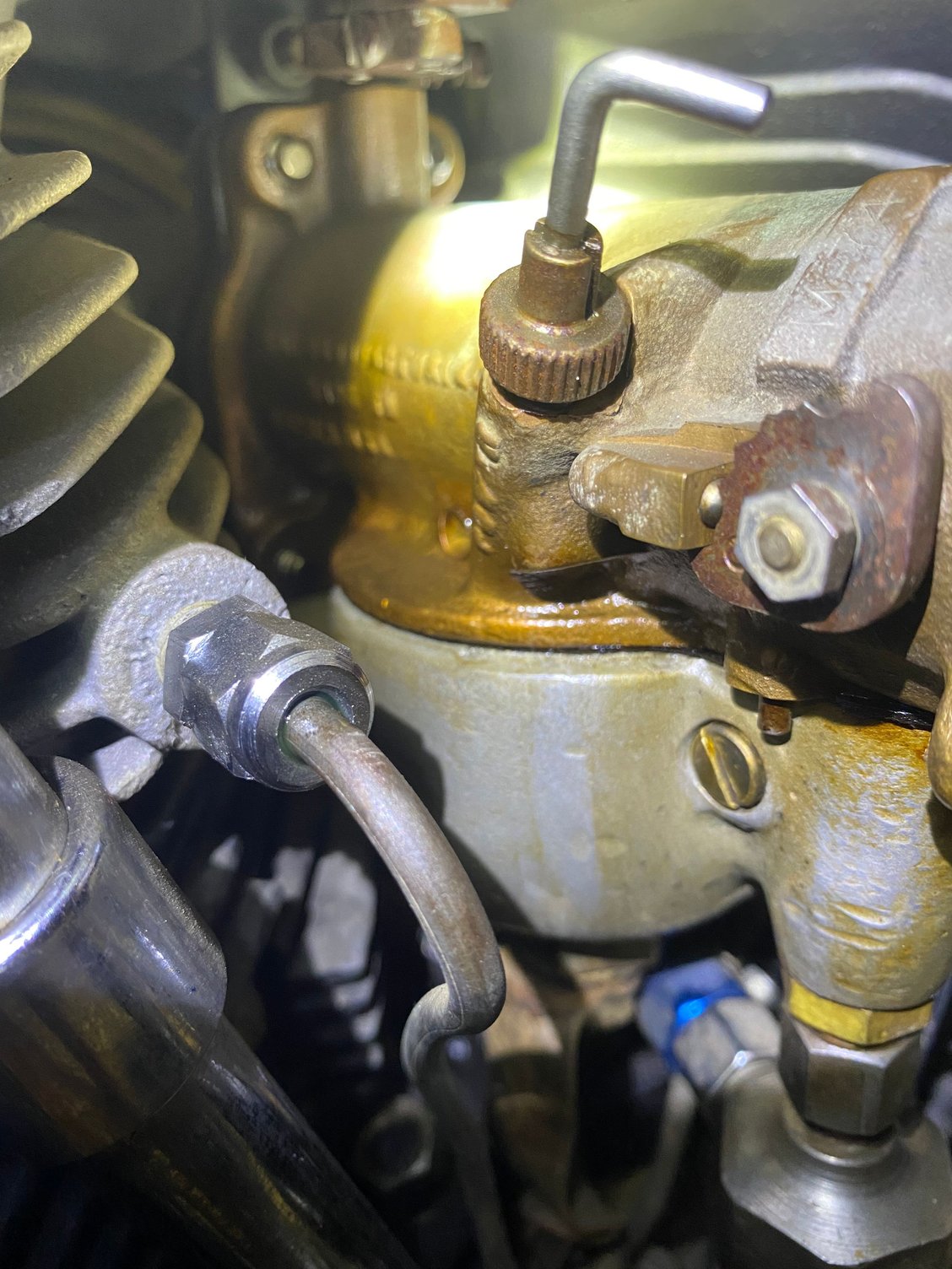

Well she runs!!! Have a video of her starting but can't figure out how to upload. Used starter fluid and she started right up until the fluid ran out. Never did get her running on gas and now she won't start with ether. I opened the petcock and after a few minutes had some gas come out of small hole on the left side of carb when looking at the carb. Hole appears to be on top of the bowl. This is a Linkert carb. I twisted the throttle and do not see gas squirting into the carb throat. I checked spark on both cylinders and it was good. I assume the Linkert is going to need to be rebuilt. Does anyone have any other ideas on troubleshooting that I should go after first? I am stoked that she started, should be going down the road on her in a week or two.
...after a few minutes had some gas come out...
If you disconnect the line from the tank to the carb, if/when you open up the valve/gas line, gas shoudl be immediately (or almost) be coming out of the line. "After a few minutes some comes out" is not the norm. Suggestion...pull tanks and flush them out. Pull carb and do a basic rebuild (parts kits are cheap and simple to install). I wodn't atomatically "assume" the entire carb needs a rebuild. It had been sitting for a spell, might just need a refresh on the basic small parts.
Thanks. Those pictures are exactly what was needed. The brake hose clamp screw first appeared in that position about later-67 and it then remained there through 1972.
The run number is upside down as it often is when in that location and it looks like H35? If so, it helps indicate the swingarm is about a 1971 model. If you ever have things apart, inside that axle clip you’ll find forging number 47614-58B followed by hallmark A and a die number which may be about 15.
Outside the R-H axle clip you’ll find forging number 47606-58 and a hallmark that looks like the letter Q with WF inside it. Also on the outside will be a die number although there can be some variation in them because the combination of numbers on some swingarms indicate the forgings were not always used in the order in which they were produced. My best guess on the die number would be 71 or 72.
Why doesn’t the axle finish proud of the nut? Is it the wrong axle?

Thanks Panz will pull the fuel line today and see how well the gas flows. To be clear the gas that came out was from a hole on top of bowl, outside of the carb. Gas ran down the outside of the carb. Went into garage this morning and smelled gas. The petcock is closed however the carb is wet with gas in the same area, see picture below. Looks like the petcock may need a freshen up as well. The numbers on the right side of carb are 1 1/2 Mod M and below that is 2-418. Was looking at website Linkertcarbs.com. I assume you are talking about the kits like L1.5HK for $65 and not the complete rebuild kits such as M51 that are $450. I have a M74 B model. Just found number location watching a rebuild video.
Speeding BT - thanks for the info. Disappointed the swingarm is a different year but oh well. I don't understand this question - "Why doesn’t the axle finish proud of the nut? Is it the wrong axle?" Not sure what "proud" means unless it means outside face of the nut? I obviously do not have that answer but am sure I will find out at some point.
Sorry the pictures aren't better, can't seem to get the light right and the camera to focus properly.
Numbers on right side of carb.
Directly behind the adjustment screw (not sure if this is idle or fuel/air mix) is the hole gas is coming out of. You can see there are numbers on this side as well but I cannot make them out.
Eric
The head of the axle looks chrome so probably a repop and without looking in the book I would think it should be parkerized no?
