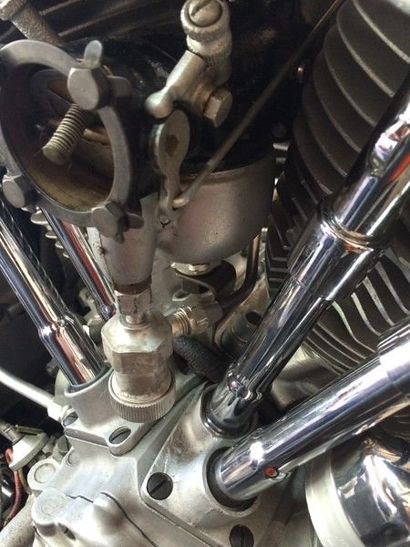

The filter on your carb should look similar to this. You unscrew the bottom cap and it comes out with some cork washers.
And if you called Carl's and made an inquiry about a "Petcock" I am not sure he will return your call. Might try again and inquire about a "gas shut off rod" assembly. Not trying to be a smart a$$ or anything like that. he is just really old school so modern terms probably might make him wonder about the inquiry. He has an amazing shop and an even more amazing collection of Knuckles and Pans (from 1936 to 1964.) Best part is that he rides them and doesn' just look at them. His favorite is his 1936 Knuckle. It gets ridden on a very regular basis. Think he has put about 50K on it since he retsored it.

My dumbass in a hurry to pull the carb didn't open up the filter housing. Just pulled it and it definitely needs changed. The cork gaskets appear to be shot as well.
Will have to do some more research on the gas shut off rod and how it works to see what the problem might be.
