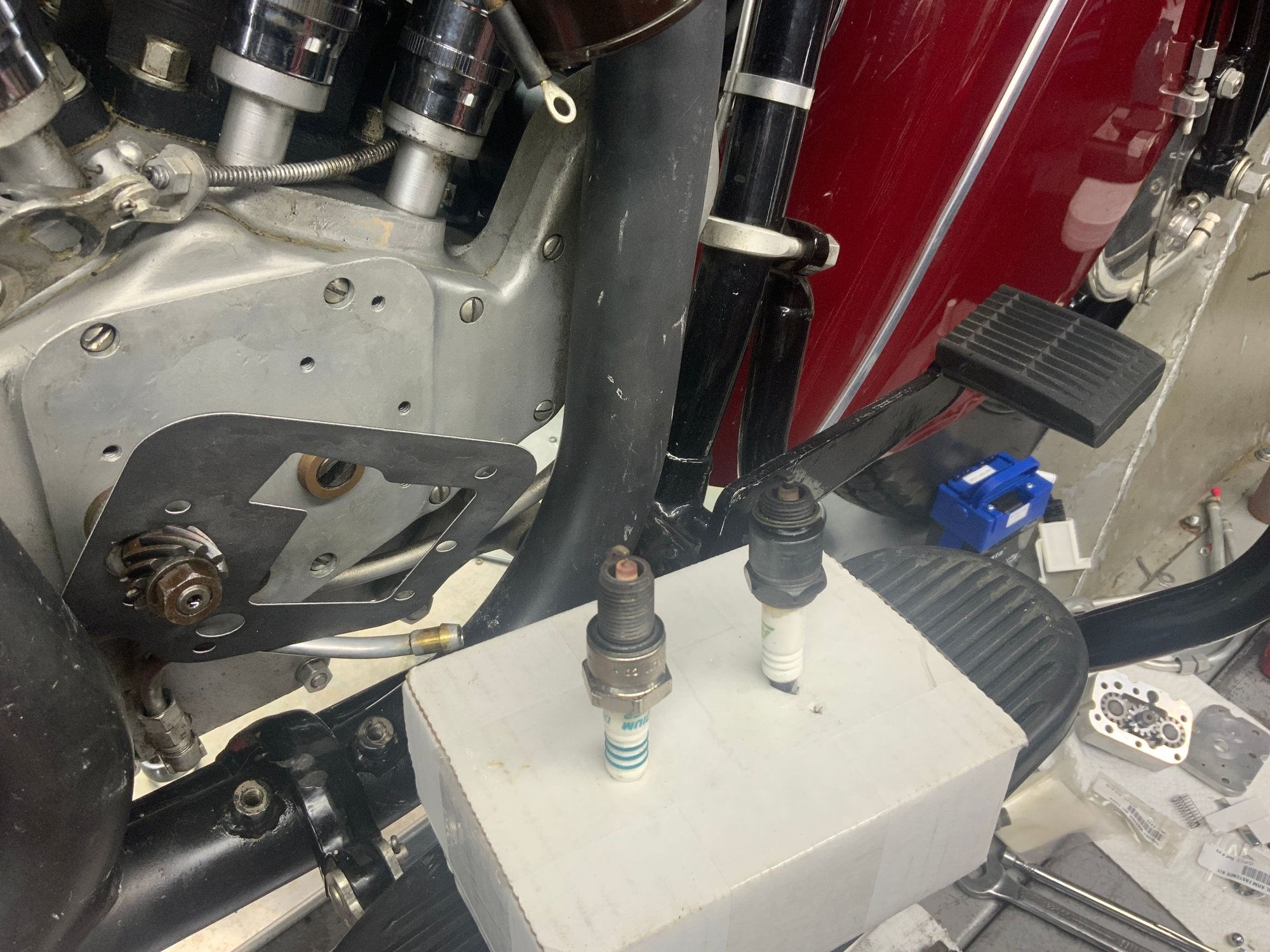

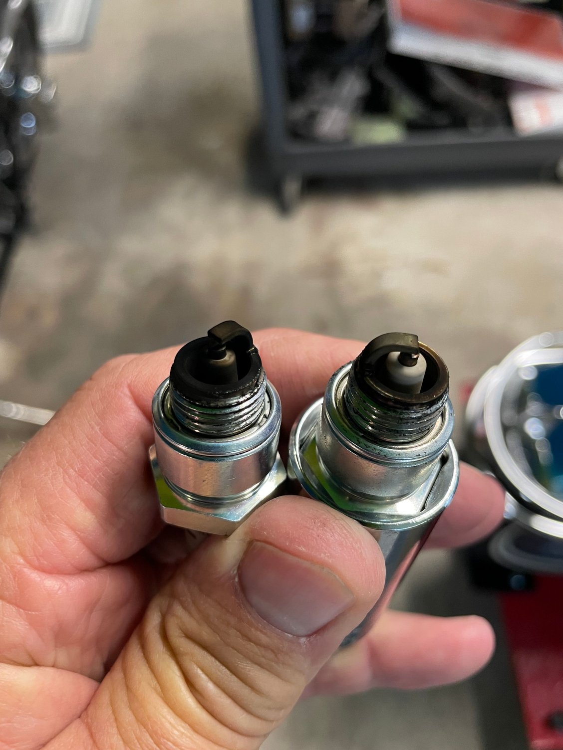

Once its too your liking find a road long so you can hold the throttle at 1/3 to 1/2 lets say for 20 minuets - then pull over gas station with gloves take the easiest spark plug out
if its like the one on the right and not the one on the left its very close - the adjustable jets has a ball ratchet - turn the hi speed the one not connected to the choke clockwise only 3 small clicks at a time will change the plug color when your real close - in and try it again on the road - your looking for some black and some dark tan - a finesse is the deal and dont get to its fine - make sure you use the time doing this correctly
once your done you can count the turns on both and record them so no matter what happens you have a base line to start with — that will let it run down the road
we suggest an ink pen to mark the location so you get it exact to what you have done - then weather changes its 2 clicks out for cooler weather or what ever your altitude requires

Looks like I am a little too lean. I have move the high speed out three clicks and will recheck.
I am hoping it is typical for the front cylinder to run rich or I may be burning some oil in the front cylinder.
Since John's picture shows the front darker as well, maybe this is typical.

I am not the expert, but both plugs should look about the same. If you are positive that you have no air leaks, intake manifold and throttle shaft, I would then find the right guy that will Dyno tune your bike. I have a local shop that has tuned bikes as far back as JD's on the Dyno. First time he tuned my Flathead I thought he changed the motor?!?!?! Sometimes technology is not a bad thing.
