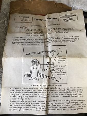

Ain't nothing wrong with keeping the original oiling system on the 65 Pans. The only issue with the 65 models was that the inner primary was non-vented. Pressure build-up from heat would cause the seal on the solenoid to leak. HD solved that with the type 2 inner primary starting in early 66 models. They also offered a retro fit for the early inner primaries. Did that to mine as I was rebuilding it.
Lotsa times folks convert to a sealed primary under the guise of "...well all that dirty oil being sucked back into the oil bag just can't be a good thing..." My only response is that I took my '65 FLH to 113K before shutting her down. And that is why you have an oil filter in the tank and change oil according to schedule, or sooner if you run it in really nasty conditions.
If you decide to seal the primary, let me know. I have a couple of pics from a guy on another forum who shows exactly how to do it right.
