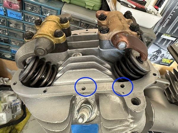

So I was trying to finish up on the motor and buttoning up the rocker covers. Of course Murphy decided to intervene and two holes ended up stripping out (Pics), one of which is a blind hole.
Can I use a heli-coil repair kit?.
Will it pull out with 15 in/lbs of torque applied?
Will it last?
If not it means pulling the timer, the manifold and then pulling the front head to weld and redrill & tap the holes
...and I was browsing the web and another option is a time cert? Know nothing about them either. Better alternative than a heli-coil?

I had to helicoil a few in my 61, no issues.
Dont put an insert in it.

I believe the helicoil size is 10-24. One important thing to ensure a good thread is a aluminum specific cutting fluid. Tapmagic Aluminum works real well.. WFO Larry recommended. Use it for both drilling and taping. Make sure to clean out the hole with brake clean or some other volatile solvent.
