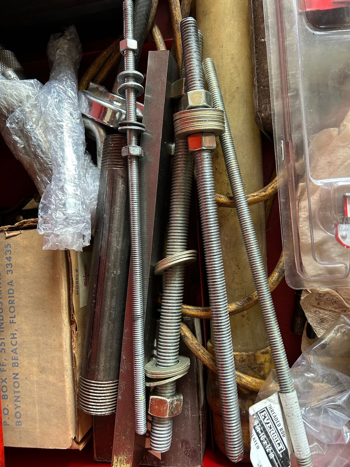

Have the bushings out of the frame for the brake crossover tube and the seat post. What's the best way to install new ones? Freeze the bushings and then heat that portion of
the frame in order to press in the bushing?

Long threaded rod. I'd machine drivers but you could probably get away with heavy washers.

I get grade 8 all thread of various sizes with nuts and washers from the local hardware store, and the correct size bushing drivers. (Lowes, ACE or Home Depot usually have this). Freeze the bushings and use a paint stipper heart gun to head the hard metal. And if it were me, I press each bushing one at a time because it has always worked better for me. And it's easier to control the cold and hot temps when working with one side at a time.
I'd bet your local Harbor Freight has busing drivers for a good price.
