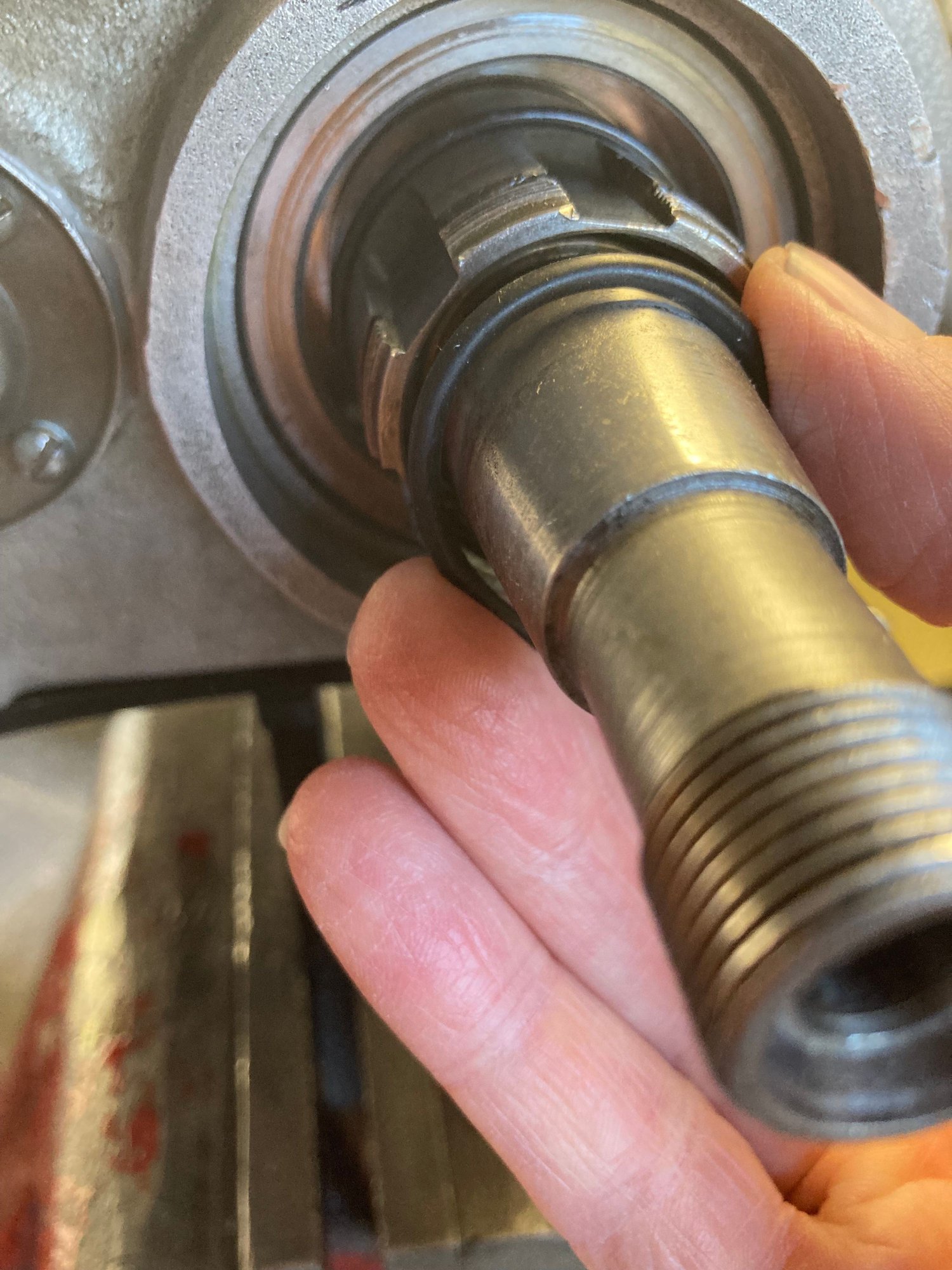

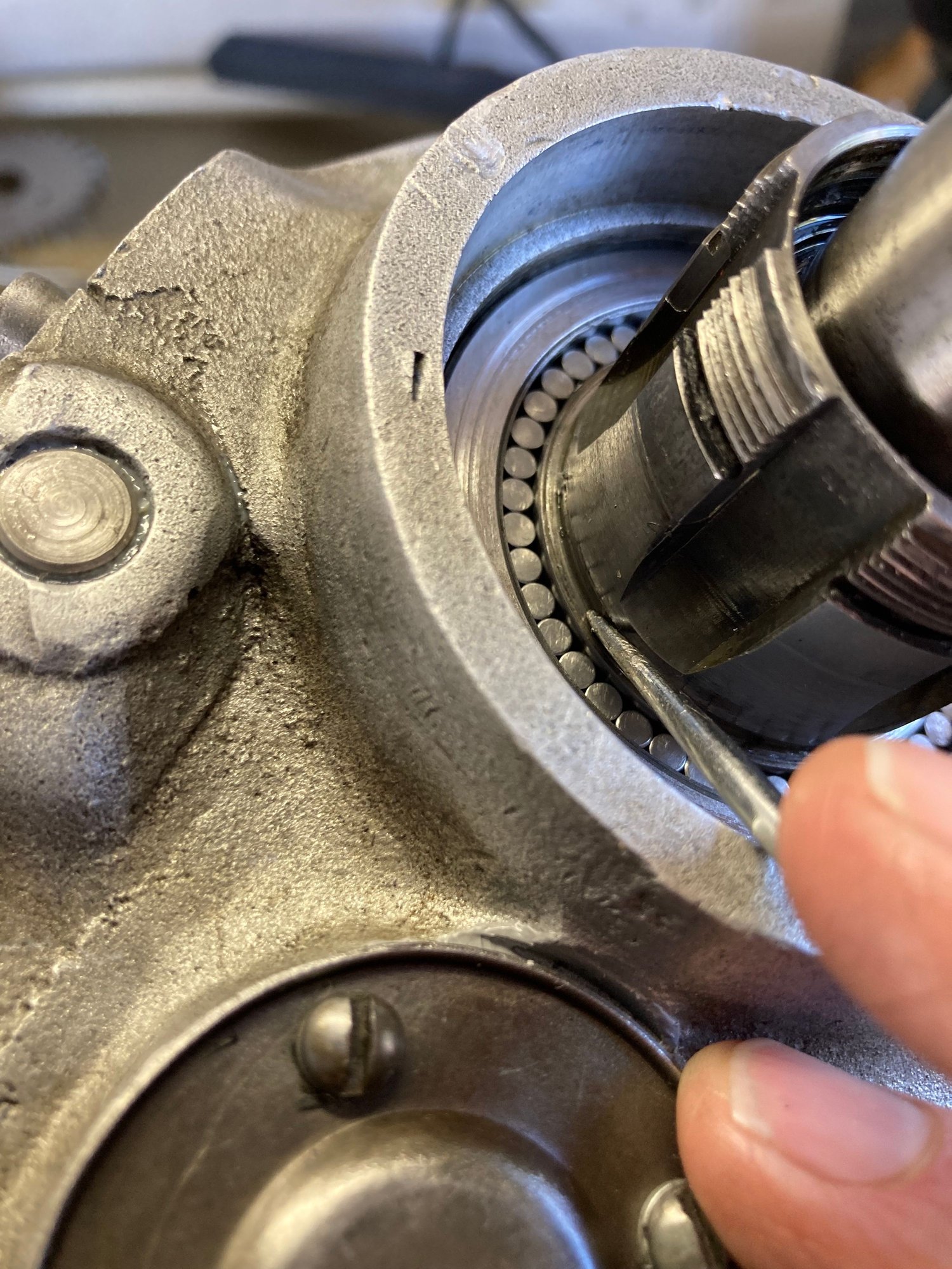

But I was unaware of that part number when I did my tranny, so ended up inserting an O-ring behind the spacer where it nestles into the chamfer. Doesn’t contact the rollers. Doesn’t leak. Just took a few tries to find one with the right thickness not to rub.
Here, I dug up the photos…
The last pic shows the shoulder where the O-ring sits. I forgot to include a shot with the rollers, so you can see that the O-ring doesn’t rub if you choose the right thickness.

The oring on the bearing spacer is a good idea. I used a bearing spacer that was machined for an oring from this person (saddlebagrail@yahoo.ca) in Canada who machines them himself. Came recommended by someone on this forum, but can't remember who now. Well made piece.

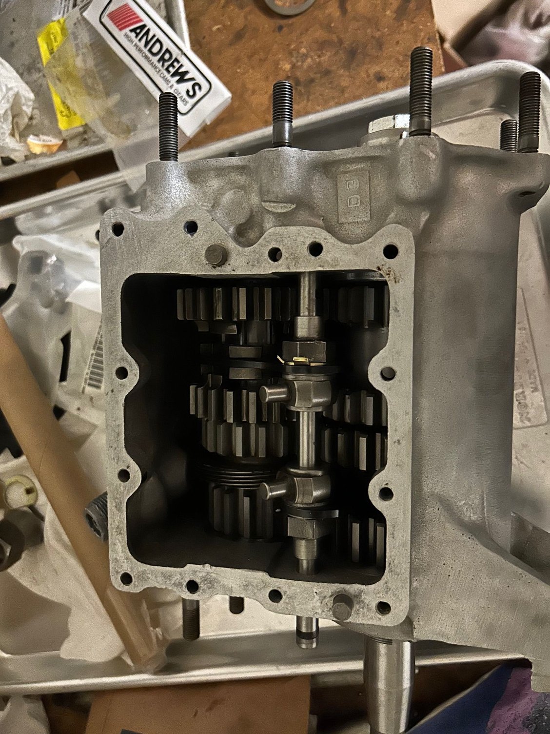

Got the seal ordered (#12013). Thanks. Also gonna do the supernut just because I have one.
And it's starting to look like a transmission again. Andrews gears in the box
Only part of the top components that is not OEM/NOS is the shift drum
