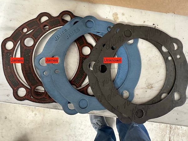

Pulling gaskets and stuff. Going to use James base gaskets. I've had good results with both James and Cometic head gaskets. Just trying to save a few buck tho and use what I've got rather than spending $60 on a new pair of cometic head gaskets
Have three different cylinder head gasket, two by James and one unknown if anyone can identify. I assume the James ones are a late (left) and early (right) style manufacturing?

And the blue head gaskets would quickly become frisbee's if I were you.

Well it looks like a 23 on the motor and a 24 on the tranny will work. Also found the 82 link primary chain will work just fine.
FWIW, I have used James and Cometic base gaskets and both leaked—but that’s because the cases on my ’51 FL have wear and minor damage around the mating surfaces that I didn’t want to repair (R&Ring the studs concerned me and at the time my bottom end was within spec, so didn’t want to split the cases). So, I used OEM base gaskets with Ultra Gray (= Yamabond), and nary a leak at ~3,500 miles when the bike was parked for the forthcoming bottom end.
I hear you on the expense of Cometic head gaskets. I have used Payen head gaskets on my A-Series (naturally aspirated) builds with good results, which are essentially identical to James’s design with fire rings and orangey goo, so for sure I’d opt for the James among the three sets you show. That orangey goo embedded into the gaskets will disperse too much if you over-torque them—but of course you won’t make that mistake with your experience.
