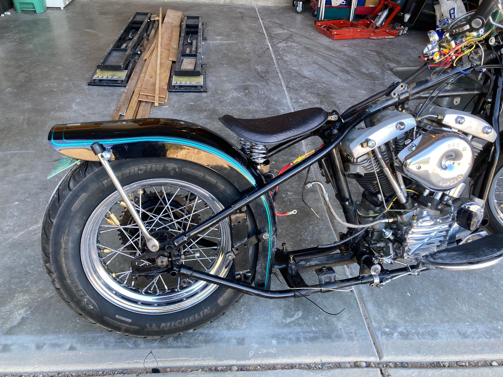

It's my bet that if you install the pogo seat you'll find it too far forward. Look at where the seat post is and where the pivot has to be.. I had a similar issue with my evo bobber. I rode it with a narrow solo saddle for about 12 years. After that my *** couldn't take it anymore.. I found a wider saddle that could use the current front seat mount. I had to move the springs to the outer edges of the seat so that it didn't rock. Compare that to the current ridding position of any rigid frame bike with the pogo seat.. FWIW I really like to move the seat back on the 65 Pan and lower it while keeping the pogo but the Duo glide frame kind of keeps the seat up. BTW, this bike does need a rear bar to keep your *** on the seat..

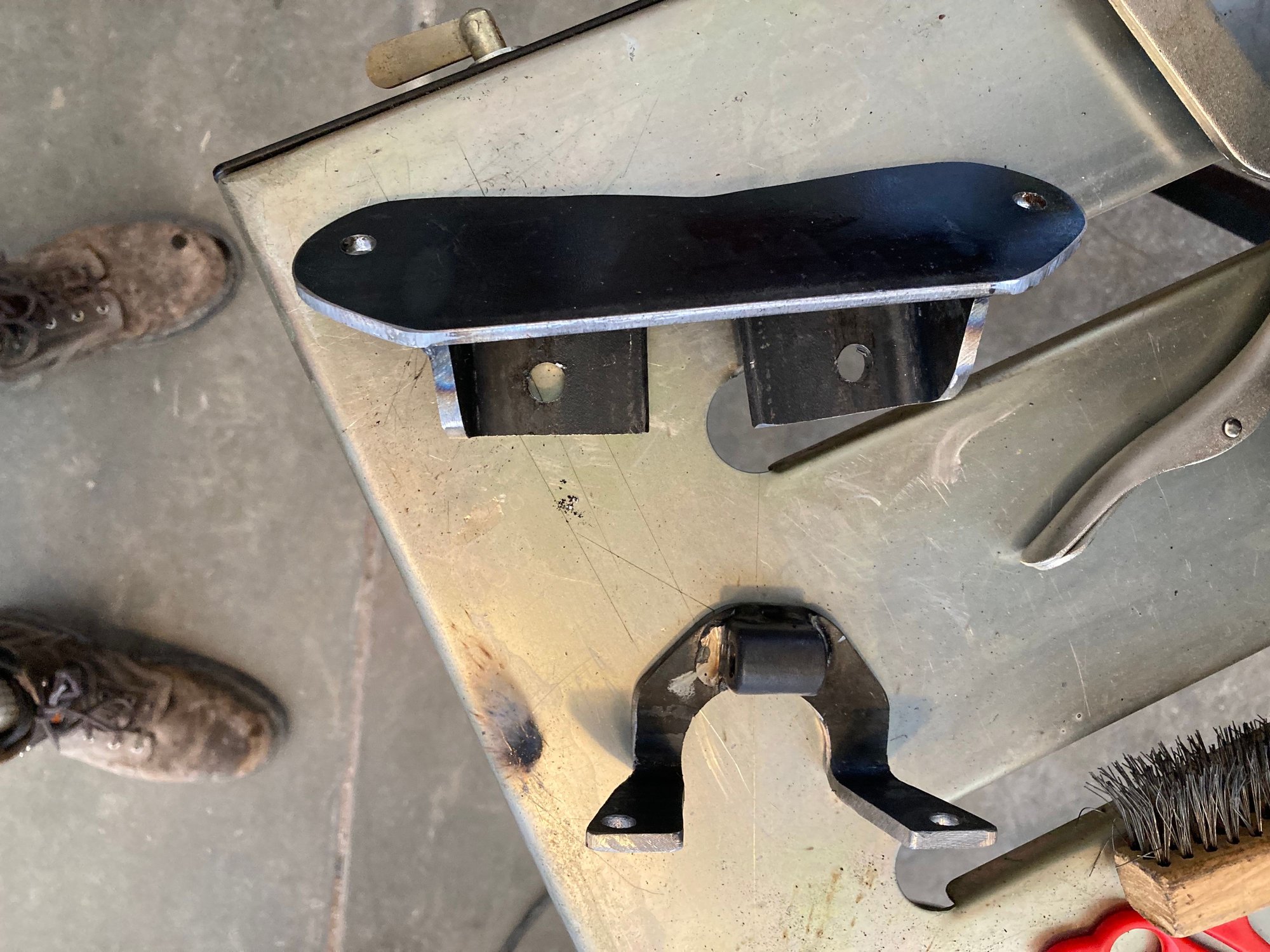

Hmmm… My hair stylist is 5’9”, so extrapolating to my 6’2” frame, being even higher together with farther forward wouldn’t be great. Maybe—and this is if the ’62 doesn’t materialize—I could design a 7075-T6 cantilever that would mirror the seat tee I posted a photo of above. But it could extend farther back, so as to position the saddle in a similar position in a fore-aft dimension to where I’m sitting now…?
You could do that but may need heavier springs.

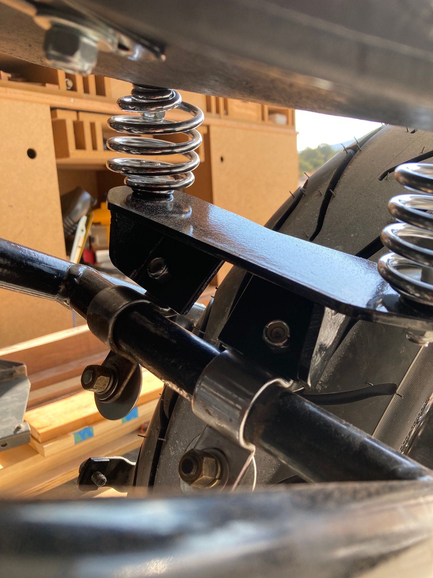

I am thinking perhaps my best bet would be to make the setup I’d pondered a while back. That is, attach the nose pivot of my existing Rich Phillips saddle’s sliding mount to the pogo stick’s ear. Somewhere, I have an email from Pacific Mike with a measurement of how much I need to leave intact so it won’t bottom out (but that’s unlikely as part of a three-point suspension.
Then, for the shimmy from those twin rear springs, I could maybe fashion some sleeve guides to prevent lateral movement that would somehow affix to my platform mount, shown here (springs shown are shorties that bottomed out on hard bumps). But I’d probably have to use different springs that didn’t have that tapered barrel shape. I guess they’d go inside the outer sleeve, which could be aluminum and polished.

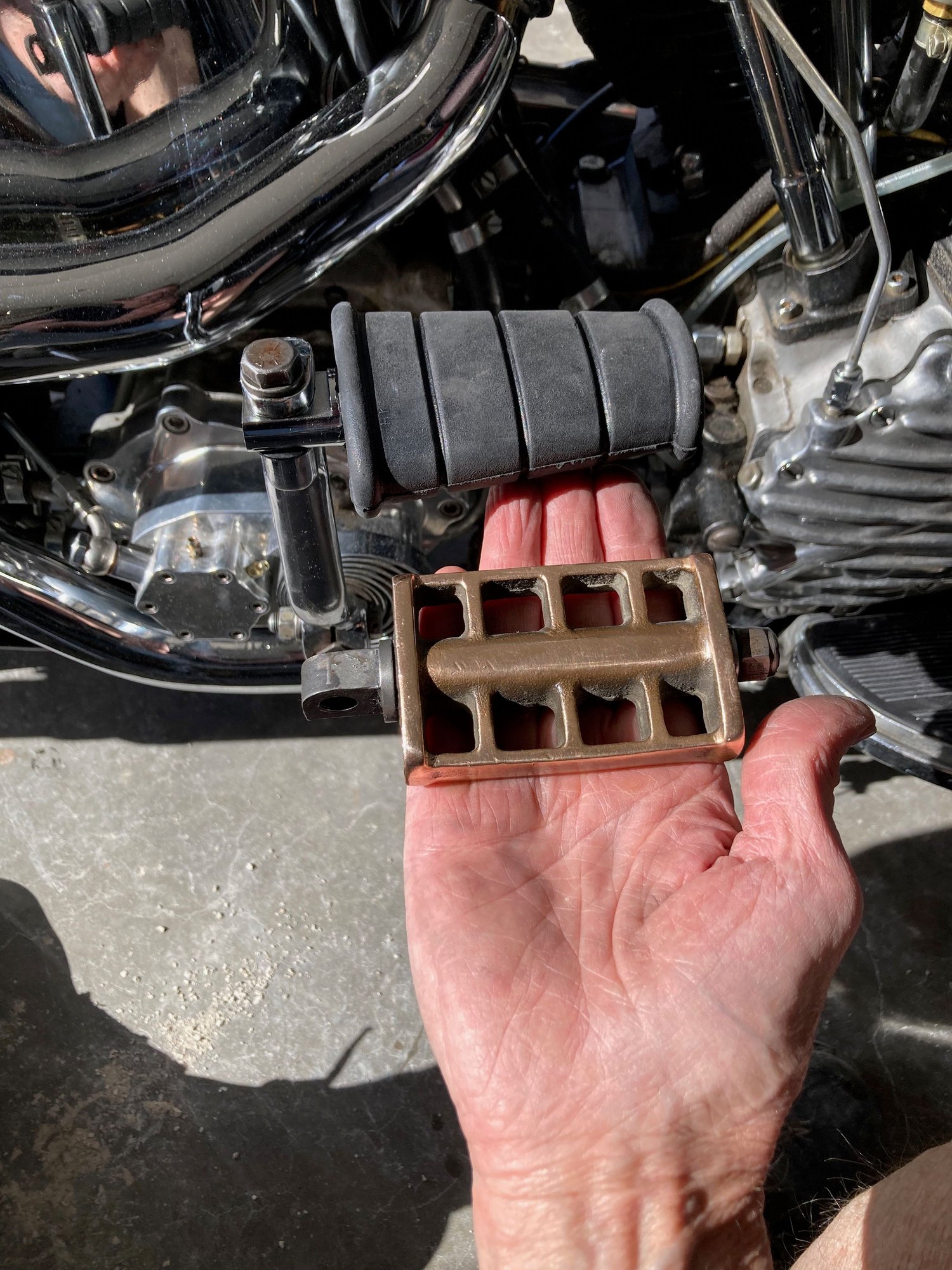

I’m trying out a regular old rubber kicker pedal. That brass job the PO had on her is pretty but kind of slippery. The rubber is more confidence-inspiring under my boot and seems well made. A little 3-in-1 on the bearing and she spins great.

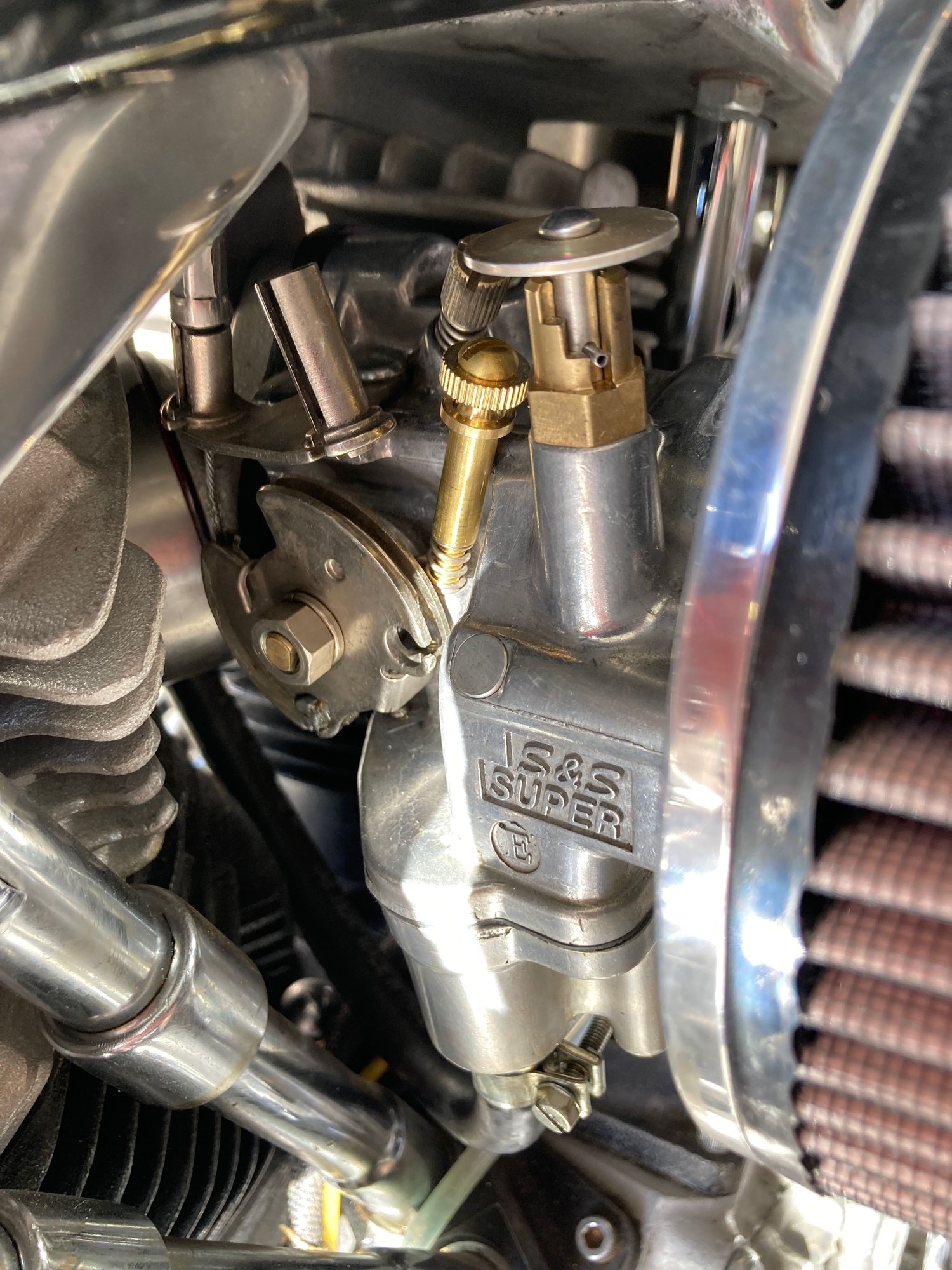

I also sprung for one of those thumb wheel idle screws. It looks like it’s contacting the enrichener from this angle but no—just close. So close, in fact, that the screwdriver slot is useless, at least with this aftermarket style enrichener. But easy to turn with your fingers, so no biggie.

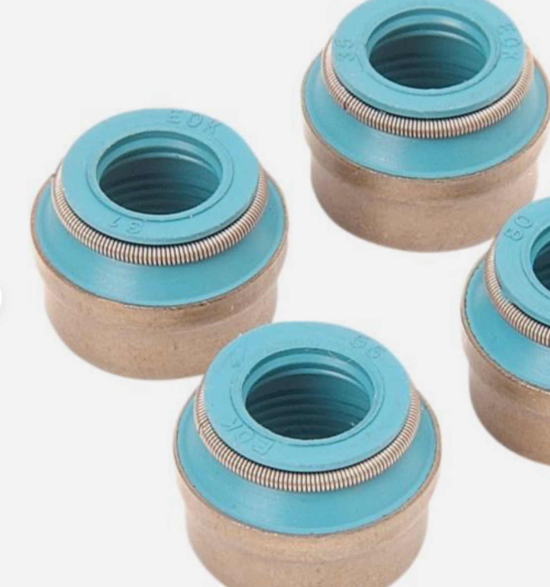

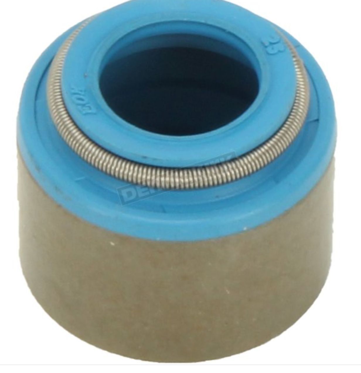

A fitment ‘note’ of my own. If memory serves, James # JGI-18000-48-10, first pic below, which The Usual Suspects call out for a ’66 Shovelhead, did not fit the guides in my S&S heads: their I.D. was too large to grab the guides and they just rotated loosely. Those look identical to what Cometic includes in its top end kit, and indeed all four of the latter are in the leftovers from when I repaired these ‘ready to run’ heads.
Also supporting this: I found an order confirmation email right around the time I did that work, which was for James # JGI-18001-83-A, second pic below. So, I’ve ordered a set of the latter just in case (and can always return them if wrong), so I won’t be dead in the water if my memory is correct—not something I’d bet a cheeseburger on, but... We’ll soon see.
