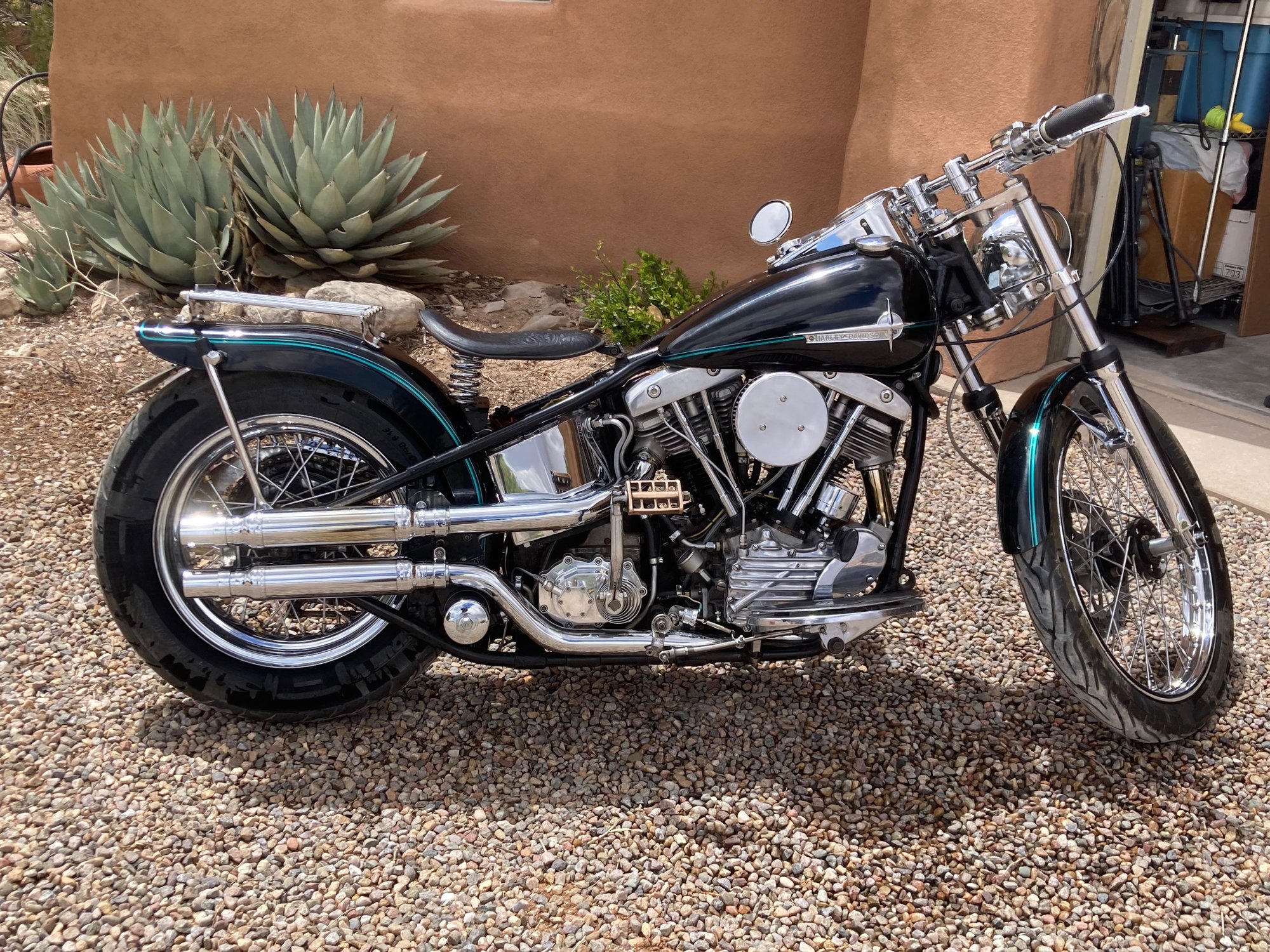

So, rode down HWY 313 along the Rio Grande into The Big City for groceries this morning, completing ~110 miles since the new top end, and she’s running fine. As you can see, nary a drop from the base gaskets up. That O-ring eliminator for the carb manifold seems to be sealing nicely, as the idle is quite even.
We’ll see how the plugs look when she cools down, but unless I get fouling-related starting problems, I’m going to leave her be for the balance of this 500-mile leg of the 1,000-mile break-in period.
I must say that with the seemingly constant state of disrepair in ABQ’s roads, I am tempted to revert to the OEM pogo stick full-suspension seat setup. I recently turned 65 and am not yet to the point where my back is bothered by the pummeling I take each time I swing a leg over this machine: it still reminds me of riding a cantankerous, retired ranch horse and that’s okay by me. But if I want to hang onto her into my ‘70s and beyond, I may want the extra comfort of the original setup.

I’ve been using the front-pivot, rear-spring solo saddle you see here as an upgrade from what was on the bike when I bought it—an old chopper-style Pacer (?) that sat directly on the frame rails. I hit a pothole in town while riding the bike shortly after the purchase that knocked the wind out of me and nearly threw me off the bike, and that was enough. Maybe if one lived in LA or Tokyo or somewhere with meticulously maintained roads, but not out here in NM.
So, what I meant to say is that I am leaning toward installing the new pogo and bushing I bought a while back. My only potential gripe would be that I’d be lifted up in the air quite a ways from where I now sit. Well, if my 1” risers then proved too short, I still have the 5-1/2” versions I had originally installed and/or could fiddle with new bars...

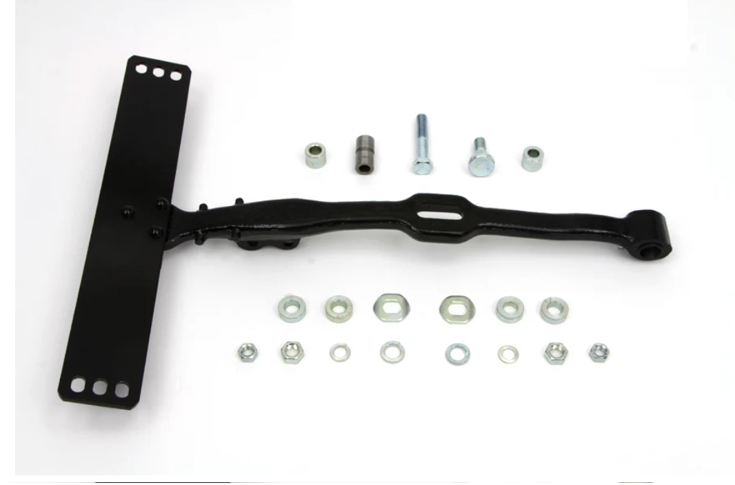

Okay, I see… and I’d need this seat tee kit to go with the pogo stick and bushing I already have...
https://widowmakersboneyard.com/coll...replica-seat-t
Plus, there would seem to be a part that would screw into those holes in the frame backbone up front to accept the pivot bolt…?
