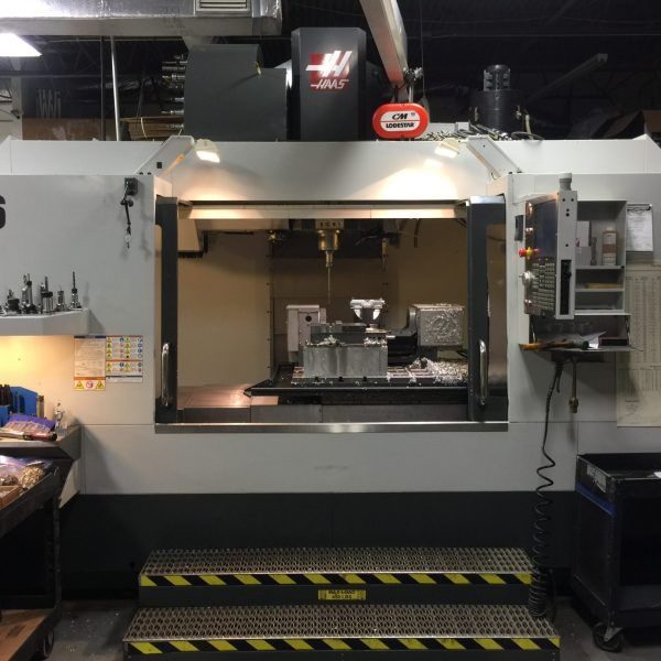

Oh, okay, thank you. I’ll talk to Zach about that. He’s got three lathes: a medium-sized one, a large one, and the (giant) CNC lathe he uses to make up some of my parts. My guess is the large standard lathe would be best for this task for the jugs.
I anticipate, though, that based on our past work for Creative Spridgets parts, he’ll tell me he doesn’t want to make up a jig to hold the jugs (or heads) in the lathe. His big CNC mill (see below) is so accurate across its entire bed length that it’s mind-boggling—and it’s simpler to make up a fixture or in the case of the jugs, to just grab them in the vise by the squared-off base. There is actually zero measurable deviation across something the size of a cylinder head. Not rejecting your suggestion, here, just anticipating what Zach will say.
I remember once when he and his late father (who started the business) were consulting with me on some Creative Spridgets part I had designed, Zach rolled his eyes and said, “Geez, Joel, we’re not freaking woodworkers!” I am, and typically make up a prototype out of acrylic or hardwood, so they’re always poking fun at me...
But seriously, I appreciate your suggestion, and we’ll see what he says!
Oh, BTW, the below pic is a Haas mill at the other local business I used to contract with for my Sprite/Midget disc brake adapters when I was still offering them. Zach's new mill is slightly smaller than the Hass and more accurate, he says.

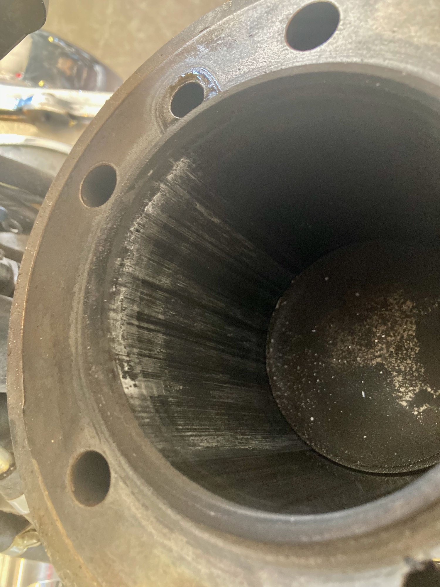

Update: I pulled the heads and the valves look fine (will check one of the rockers on one head tomorrow), and saw bad scoring on the cylinder walls (see pic); matching ugliness on pistons—they’re toast. Then, held my breath and pulled the jugs to check the bottom end… and I was astounded to find that the crank turns smoothly and silently—with not a whisper from the cam chest or oil pump.
There was zero up-and-down play at the rods, so measured the ‘rod shake’ side-to-side per the OEM manual, which is supposed to be 3/32” or less… and the thing is still in spec! Amazing!
So, the felonious b______s at Home Depot cost me a set of cylinders and pistons, but at least I do not have to split the cases and rebuild the bottom end, as I had feared. Man, are these things bullet proof.

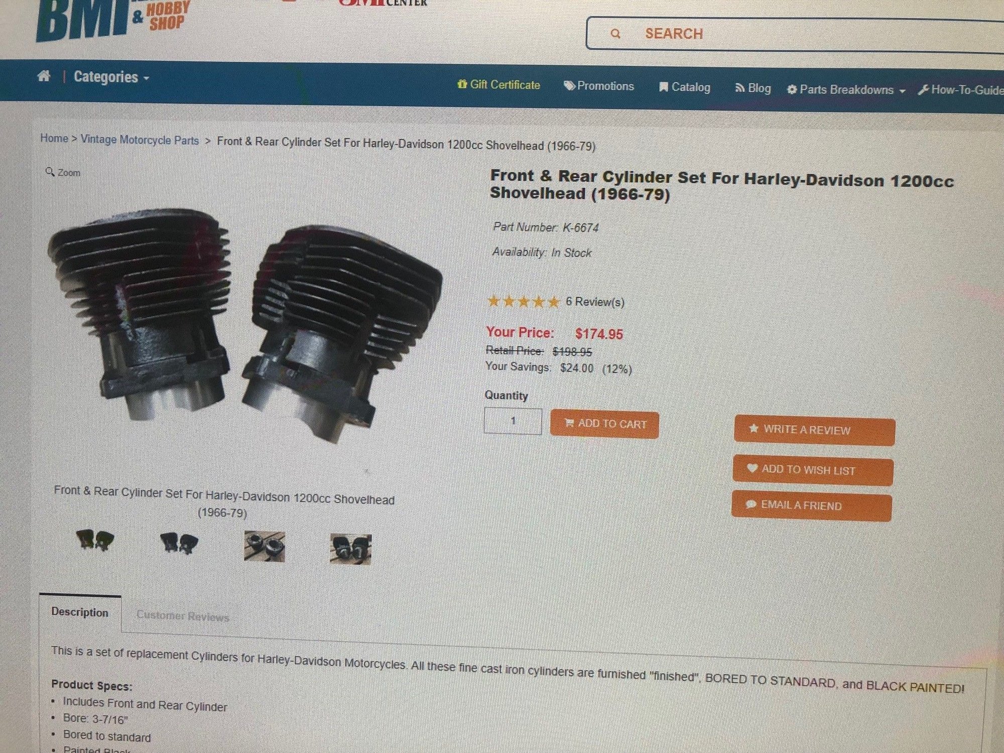

Check BMI Karts , see if they still have cylinders from Dixie / Superior
Can your current cylinders be bored ?
The current ones are badly scored. I mean deeply, so I don’t think so.
I will check out BMI - thank you very much!

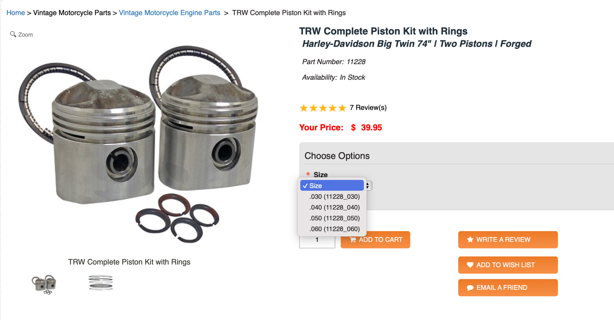

Well, my goodness… if they could be, I could get these TRW forged pistons available in .030 to .060” as a complete set for $40! I’d only be saving, like, $400 or so… and I’d be upgrading to forged pistons…
Let me carry these jugs down to the local shop tomorrow and see what’s what!
