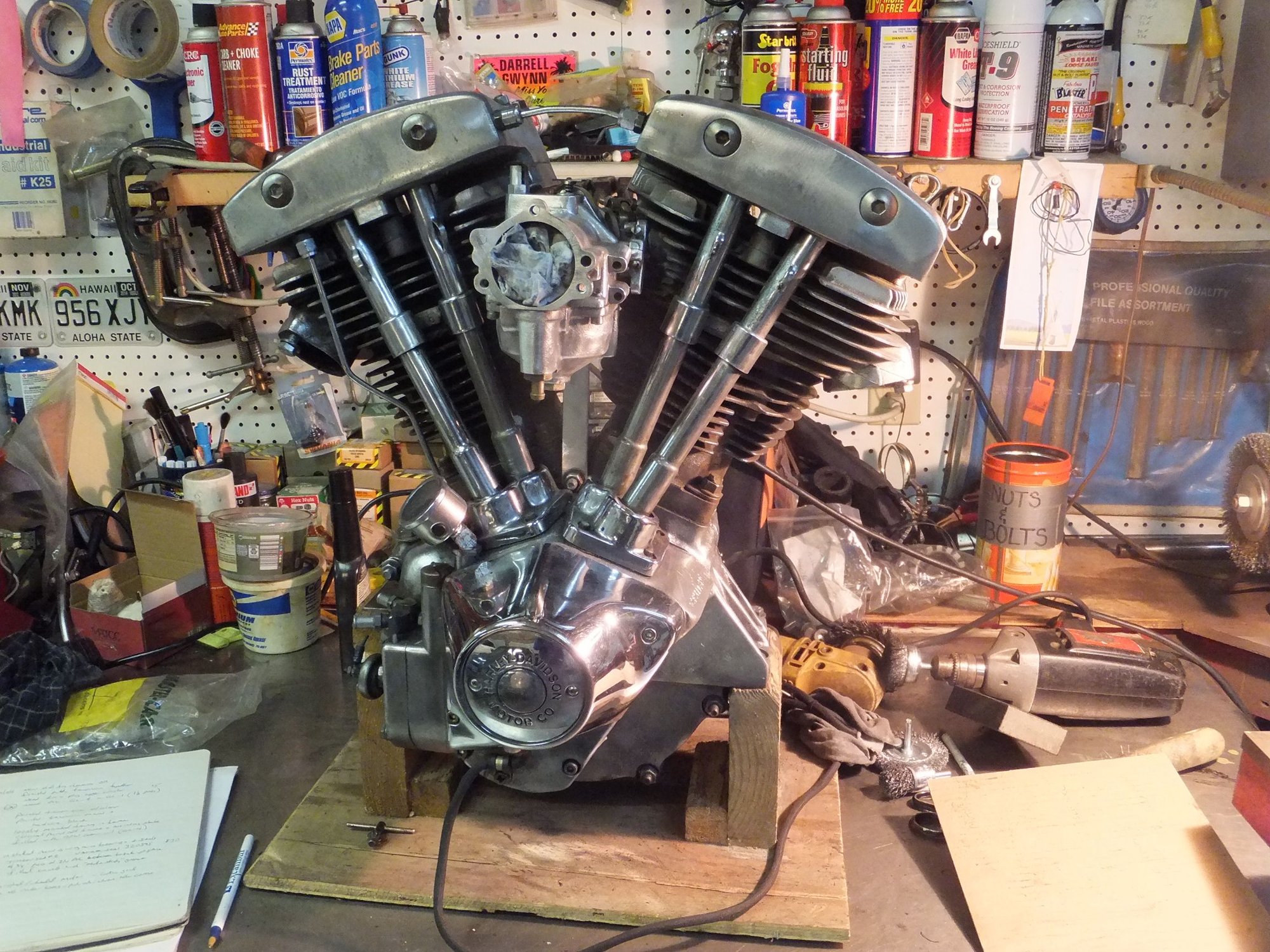

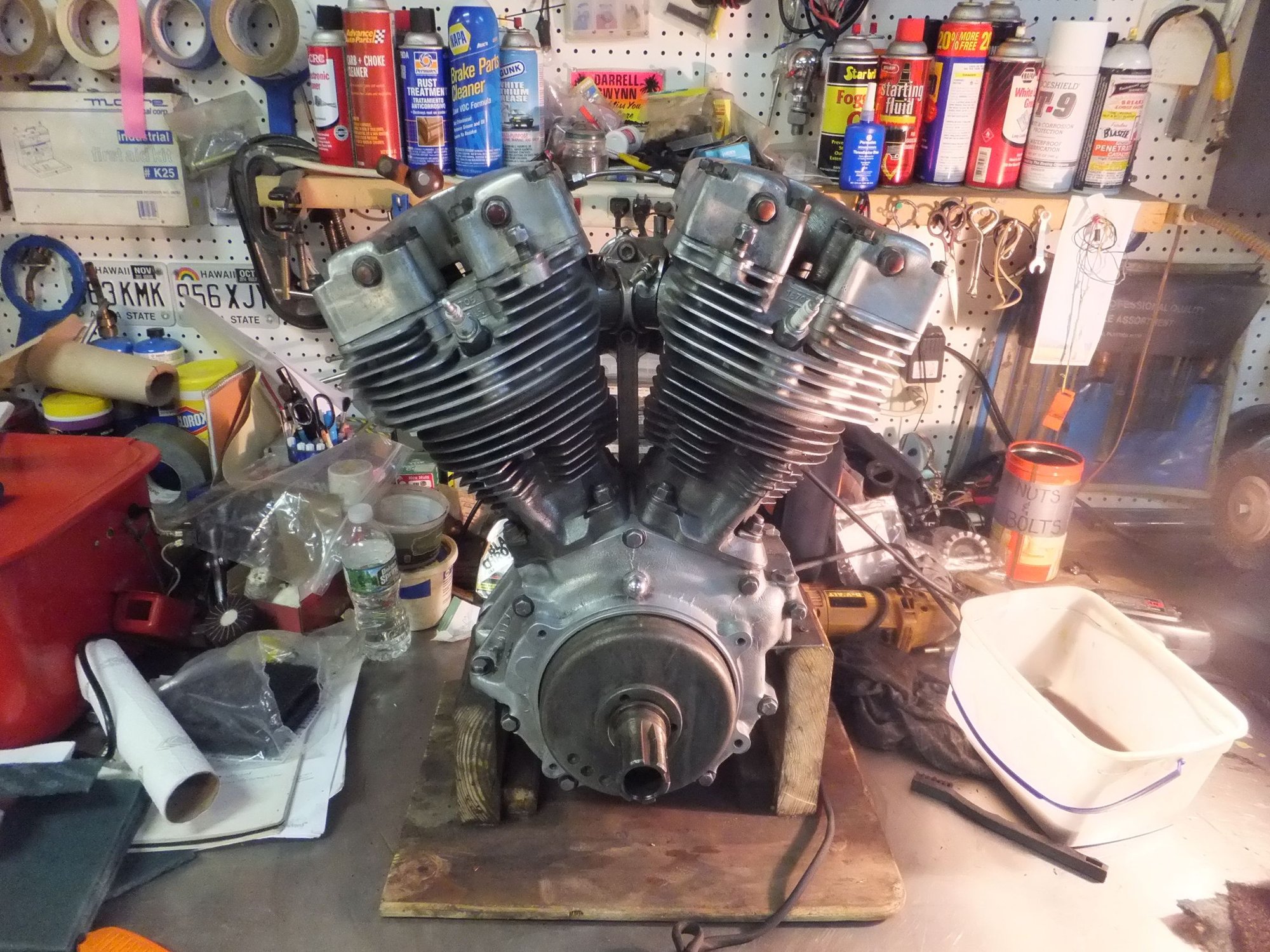

Gentlemen - thanks for the reassurance on the rod kit. I'll have more requests for recommendations on parts when I see what needs replacement during tear-down. I don't recall but think that I have got meat in the jugs to go .020" over if needed.
TwiZted - just 70 pounds? Cool. I can easily lift that onto the bench w/o hauling the engine stand into the garage--which I think the mice out back would resent...
I was looking at Max's very nice engine stand, which looks homemade, and need to compare the cost of a length of angle iron to a pre-fab stand. I think I saw one that bolts to a traditional auto engine stand, which I have, so might go that route... Only downside I can think of is it'd take up more floor space in garage, as opposed to setting a stand on my (small) work bench...?

You can make one out of wood too. 2x6 and 2x8 uprights on a piece of plywood. You need a small metal plate on one side
Oh, cool, I will scope out the wood pile in addition to seeing what scrap steel I might have lying around. Thanks!
