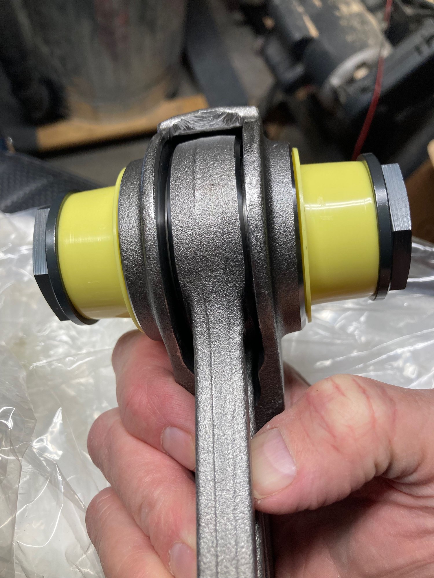

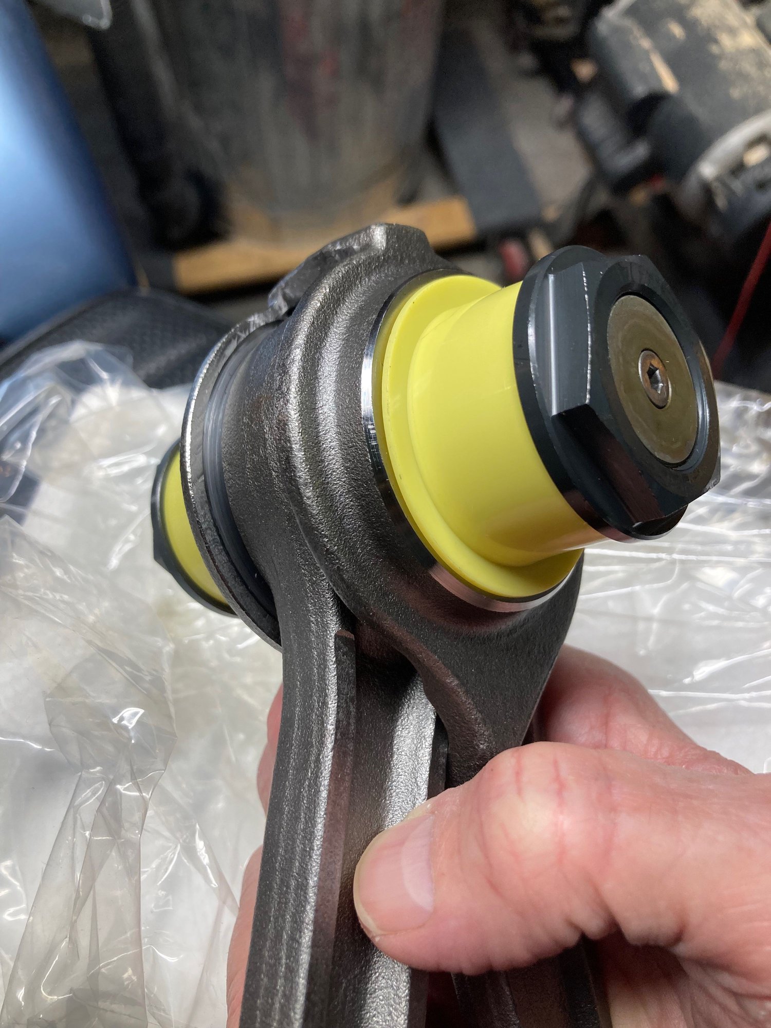

I received the rod-pin-bearing set discussed above (first 3 pics), and they look pretty well made. I will be interested to see how their weight compares to the OEM set--if indeed it needs replacing as I anticipate based on the sound when the engine ran dry. The seller says the crank pin and bearings are correct for my bike but the rods are a .002" shorter or something like that. So, slightly lower compression--though as I like Cometic head gaskets, I can add that right back in by ordering a thinner middle layer, if I want. Frankly, I don't think it'll make a difference I'll notice and 'premium' is only 91 octane these days, so...

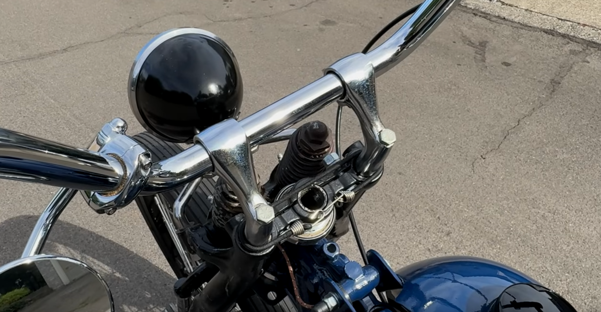

Also ran across a guy discussing his '49 FL bobber project, which has a '36~40-something springer which I don't want. But he used two old school Schwinn bicycle handlebar stems to mount his bar, which I think looks kinda neat (4th and 5th pics). I might be using that idea when I bend up the custom sissy bar--and probably refinish the sheet metal, too. If I didn't go with a different bar, it would mean some machining to keep my existing drag bar or to adapt my controls onto a new, slimmer bar... well, we'll see...

.002" you won't notice it on the old girls. Those rods will be a lot closer to factory than S&S.

Check the cylinder head gasket surface. It is common for the steel inserts for the head bolts to rise a little above the gasket surface. If that is the case, you will need to surface the head gasket surface and could easily take .002 off. Ideally that's machine shop work to get it cut evenly. But agree with TwistedZ Biker that .002 is not enough to matter.
That's good to hear, thanks. I'll look forward to seeing how they compare.
Paul
Okay, will do, thanks. As for lapping the bottom end races and reaming the timing cover bushings, there's one local shop, Larry's Custom Cycles, which has a pretty extensive old school machine shop. Though he has a wait list, if memory serves...
