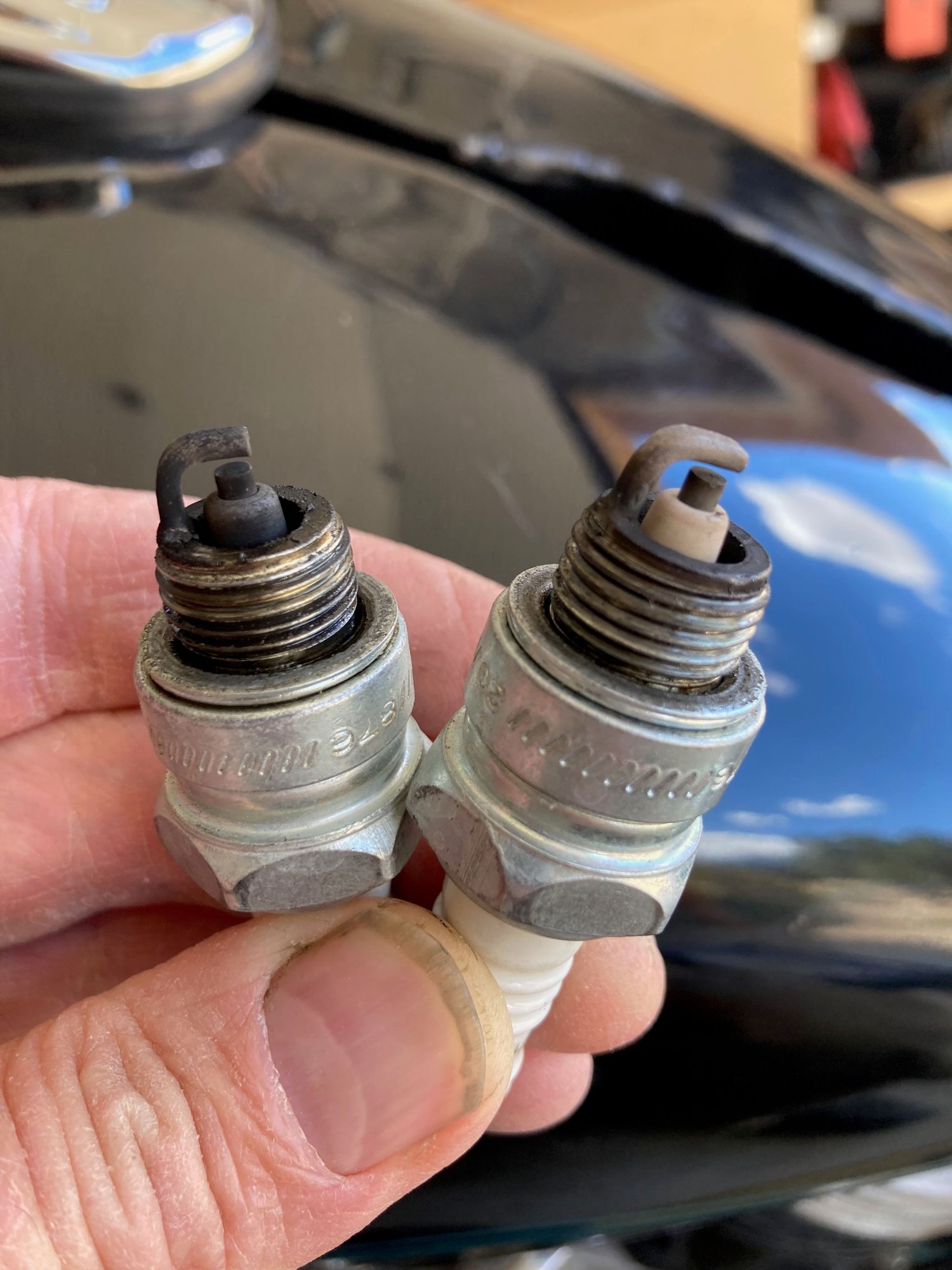

Well, I’m not happy about this. No. 2 is just about right, but no. 1… looks like oil fouling to me.
I am 99.9% sure that I installed the oil control rings the same way in both cylinders (must’ve checked two or three times when installing each cylinder), and the piston-to-cylinder fit was nearly identical in both cylinders. So, perhaps all that’s happening is the front cylinder is taking a little longer to bed in. I hope so because what a drag to have to R&R the front cylinder again to fit new rings…
The oil was exceptionally nasty, so even though I’ve got a spin-on filter in the scavenge line, I may think about pulling the tank and flushing it out.

On the photo of the plugs in post #125, if it isn’t merely slow ring bedding on no. 1 cylinder, another possibility in light of the oil starvation that prompted this top end occurs to me.
It is possible that the intake valve seal grabbed onto the bone dry stem and got lifted up off the guide. If the problem persists, and before I pull the front cylinder and mess with what is probably a nicely bedded set of new rings, I may just pull the front head, remove the rocker cover, and see if the intake valve seal is displaced. I’ve got extra seals and rocker gaskets, so it’d just be a $40 experiment for a new set of MLS head gaskets.

Unless the valve to guide fit is too loose, there shouldn't much oil passing there even if the stem seal has lifted off. The original setup didn't have seals and they didn't burn much oil (enough to smoke on shifts) until they got well worn. Generally, rings smoke on acceleration, guides on decel.
Have you checked to see that oil is returning to the tank?
If it were mine I'd put more miles before tearing into it. And if you are just to curious to do that, remove the intake and exhaust and see if there is wet oil present on the valve stem. And / or use a bore scope to have a look in the cylinder.

OMG yes, oil return to tank was checked on first startup, after glancing at gauge to make sure (initial) pressure was there.
Okay, good to know about guides and oil consumption on these old machines—thank you. I will for sure chill out for the balance of the break-in period (500 or 1,000, depending on how you read S&S’s instructions). I’ve decided to fit my GoPro to the R/H rear frame tube just above the mufflers and a bit outboard, so will make a video at, say, 500 miles to see if there’s any smoke and from which pipe.
BTW the PO said the poof he saw from no. 1 was when I let off the gas to shift gears. Not accelerating.
To pull related info from the original thread: I bought reamers 60% toward the larger end of the spec, because S&S had reamed them at the bottom end of the spec in their ‘ready to run’ heads and the No. 1 exhaust valve seized and nicked both valves as they passed each other. That’s what prompted me to replace their valves with Kibblewhite black diamonds, recut my own seats, and while I was in there install roller rockers and machine the shafts to eliminate shims and achieve .008” all the way across with 12~15 ft lbs on the rocker nuts.
