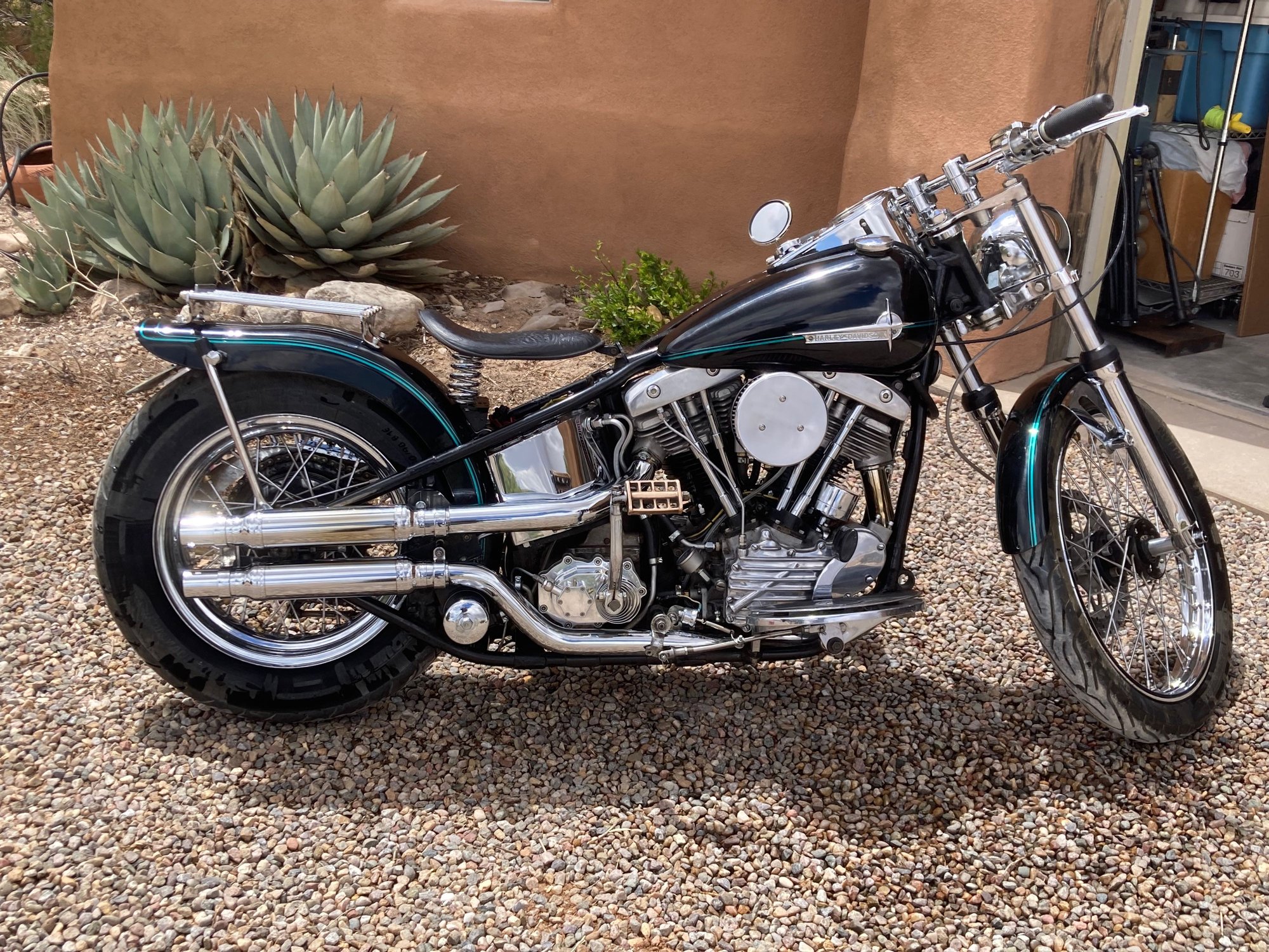

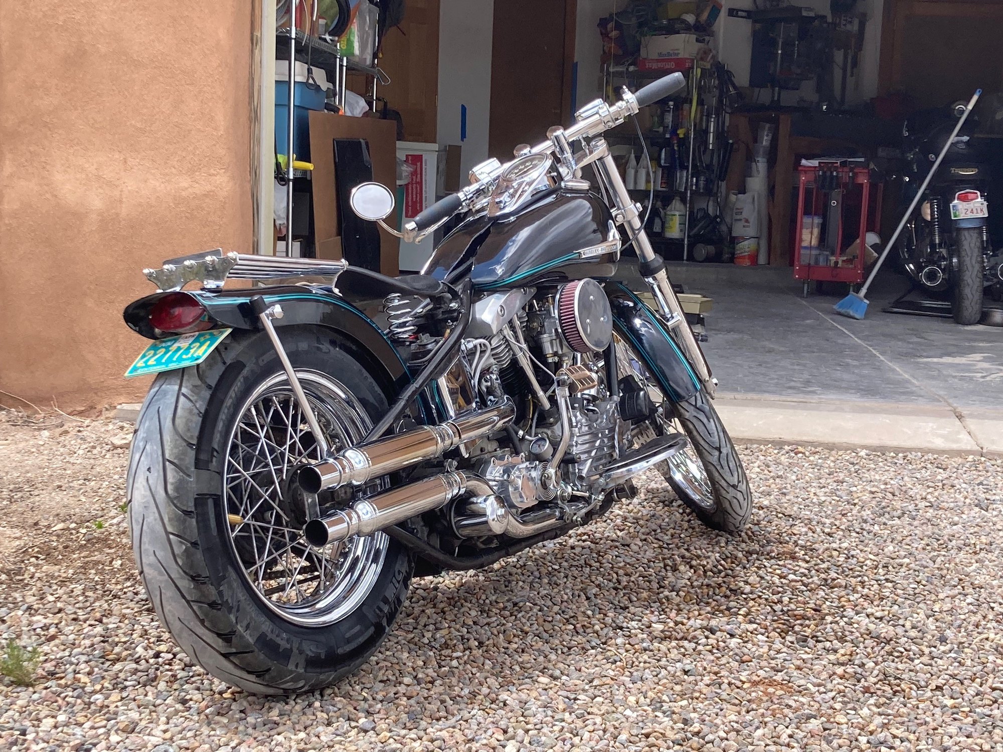

So, I am satisfied with the latest DIY air filter—the base being CNC’d by my neighbor, the lid being DIY as shown earlier. Best compliment to the lines of the bike between the stock Super E dog dish, the Offy low-profile option, and this simple round K&N 6” filter. When I get my tax refund, I may ask Zach about making up the recessed base plate, but it’d be lots of bread to gain 3/4” lower profile—and I haven’t yet ridden this one to see whether it bothers my knee.

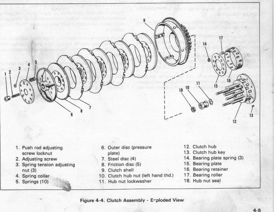

If you haven't already, make sure the clutch hub bearing retaining plate (item 15, Fig 4.4 page 4-5 in my manual) (the one that those round springs are pressed against) isn't contacting the clutch shell (basket). It can drag on the clutch hub keeping it turning some like the clutch isn't fully disengaging (at least as much as the earlier clutches will).
Oh, thanks, hadn’t thought of that. So, its inner surface should be completely clear of the clutch shell’s outer suface?
If it isn’t, what is the solution? To insert shims somewhere to keep it proud of the shell’s outer surface? Or is this an O.D. / I.D. contact issue?
Also: I have a hub kit with rollers, the three springs, a tube of lubricant and what I assume is the plate. It feels like a kind of flimsy fiber thing—and I seem to remember the one in there was plastic. Is one better than the other?

There are a few aftermarket plates made of nylon to replace the steel one. The idea is to keep clutch basket in place so the friction and steel clutch plates won't come in contact causing drag. I've never used one but I know many that swear by them with the Shovel and earlier clutch setups.
As far as the rollers go, the short offset rollers have always worked better than the longer inline rollers.

Check the clutch shell to see if there is any or much wobble when the pressure is released (springs removed). If the shell moves much, that will take up slack between the clutch plates that the movement of the release disk movement creates when the lever isn pulled in. The clutch fix kit you have is supposed to help keep the clutch shell in place, rather than walk out and push the plates closer together creating drag. Hopefully there are installation instructions, but the people I know that have used them only installed the nylon bearing plate.
As far as the springs go, they just can't coil bind before the clutch is fully released (the clutch pushrod stops pushing against the release plate). But they also need to provide enough pressure to prevent the clutch from slipping under a load.

No, it’s worth something. A bike’s aesthetics to my mind are always a blend of how the looks affect the rider and others. Nobody lives in a vacuum (though there’s a hilarious Panhead in the below Chopper Cult Panhead compilation with bizarre, vertical handgrips soaring into the air that challenges this idea… could anyone but him like those bars?)
My only gripe about the Offy setup was the possibility that it was increasing vapor lock and causing, or contributing to, difficult hot starts. However, since I have (finally) learned that I was timing the auto-advance distributor incorrectly—with too much initial advance—it could well be that the Offy’s plenum wasn’t the cause.
So: when I get free to conclude the initial 50-mile ring-bedding segment and start running errands, I can experiment with the air cleaners. The extremely low profile of the Offy plenum does make for a nice knee-to-tank riding experience. And I think it looks kinda cool...
