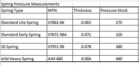

Not to hijack the thread, but do you know what the springs are rated by the color mark on them? Mine's marked blue and is engraved 257 lb.
Don't know for sure, Seem to remember the 280s (275) had a yellowish brown dot. I've seen blue ones but have not measured them..
I measured the few discs I had.. You can sort of go by thickness.

Thanks. I'm going to break out the calipers and compare. Seems somewhere there's gotta be a color chart.
