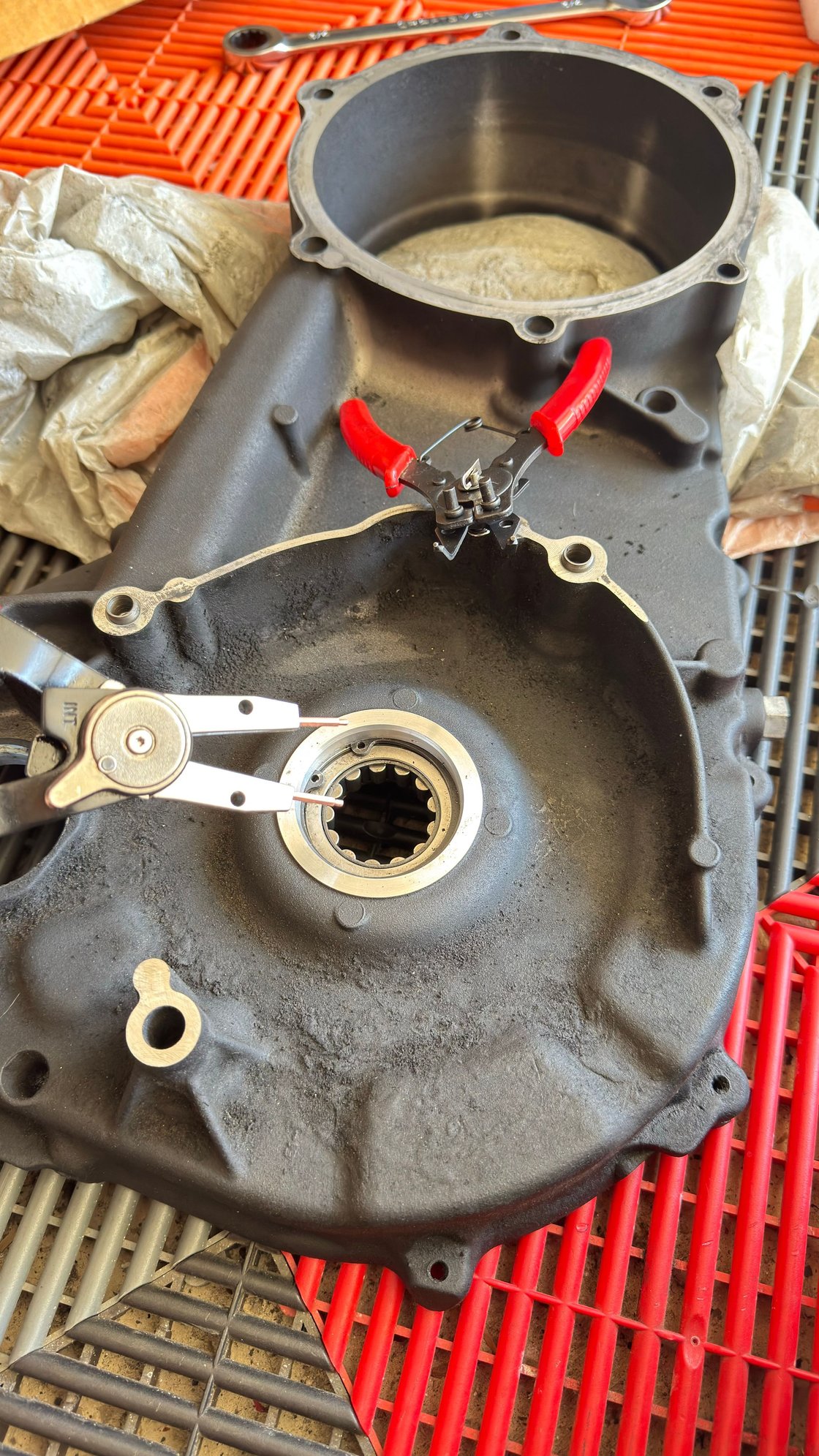

Wanted to share my experiences trying to remove the big & nasty main primary case bearing. Don’t bother using any of those snap ring pliers with inter-changeable tips as they’ll probably slip off. My HF Quinn pliers did and scratch the seal surfaces as the inner lip is deep and my lousy pliers holder pins didn’t not having enough strength to close despite the handles being together. Anyway I’d recommend forged one piece types and got this a great set for $14 on Amazon.
[img alt="My 08 Ultra 96in- Looks like it did weep possibly with belt dust stuck in a a grease surface .
Anyway I’m replacing the stock compensator to the HD ‘SE’ version and fitting an extra disk clutch and slightly 15% stronger pressure plate spring."]https://cimg7.ibsrv.net/gimg/www.hdforums.com-vbulletin/1120x2000/img_1304_c1c4a80f1008727228be75585a8337a2f89115a1. jpeg[/img]
My 08 Ultra 96in- Looks like it did weep possibly with belt dust stuck in a a grease surface . Anyway I’m replacing the stock compensator to the HD ‘SE’ version and fitting an extra disk clutch and slightly 15% stronger pressure plate spring.
I’ll buff out the surface nicks with Scotch brite and 3k papers prior to the new OEM seal placement.

Default For clarity these are straight type pliers as this pic didn’t seem to upload originally.
Just to clarify they were brand new straight type pliers as this pic didn’t upload originally. I’d only used straight types. My new forged one piece types come in a four pack of both straight & curved.

Just gonna mention this.
The tips of the snap ring pliers need to be real close to the size holes in the snap ring itself.
It makes a good bit of difference in how easy the snap ring is installed or removed.
A thin coat of sealer will help on the scratches if worried about them
WP

The ones with the red handles are too small.. I have a set of HF Pittsburg reversable and the larger ones work well if you grind the pins so they are flat and even..
