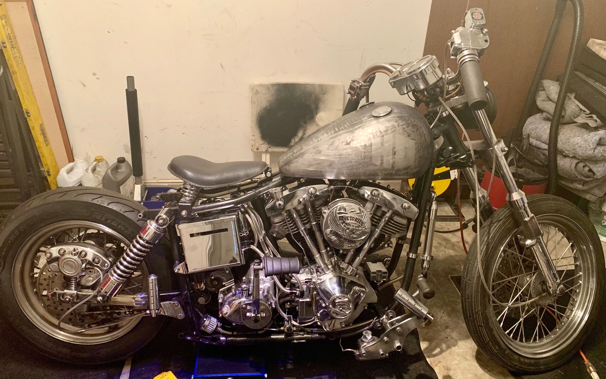

Yea I looked at Baker replacement gears... can’t afford them as of now. Just rebuilt my Dads 76’ Shovelhead from the ground up- I did all the work; even separated the crank cases. Then took crank to a machine shop and had it balanced. I did the rings, pistons, push rods, also I had to rewire the whole bike...
