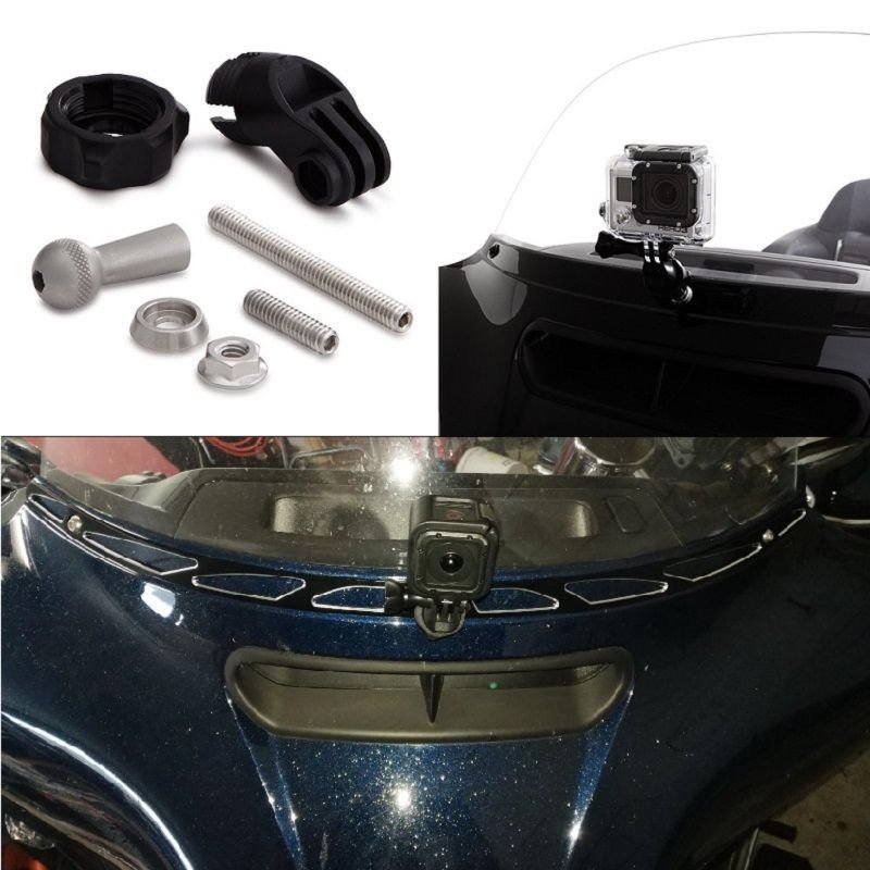

Default Fairing Mount
Ciro3D Camera Mount
I've tried several mounts... a few whose name I've forgotten as well as several configurations by RAM. I've never seen this type before, so I'm gonna give it a try and hopefully it works well and I can use it this summer on our ride.
It's a Ciro3D mount which I ordered from Amazon.

Man...that is slick! Can't believe no one thought of that before. I think this will work for my Road King as well. Just switch out the center bolt on the wimp shield....
Anyone see why that wouldn't work for me?

The problem is that this works for a Garmin GPS also... which goes on the opposite side of that camera location... you could mount something similar to one of the bolts that is off similar if you have a swivel bracket.

You could probably use a short (measure twice...LOL) stainless 1/4-20 Phillips pan head machine screw (inside to outside) and thread the ball portion of the mount down onto it from the front. If you unmount the camera and don't like the look of a ball sticking out from the front of your windshield, unscrew the ball portion and screw on a stainless cap nut. I checked my old RK windshield and it looks like it would work.
