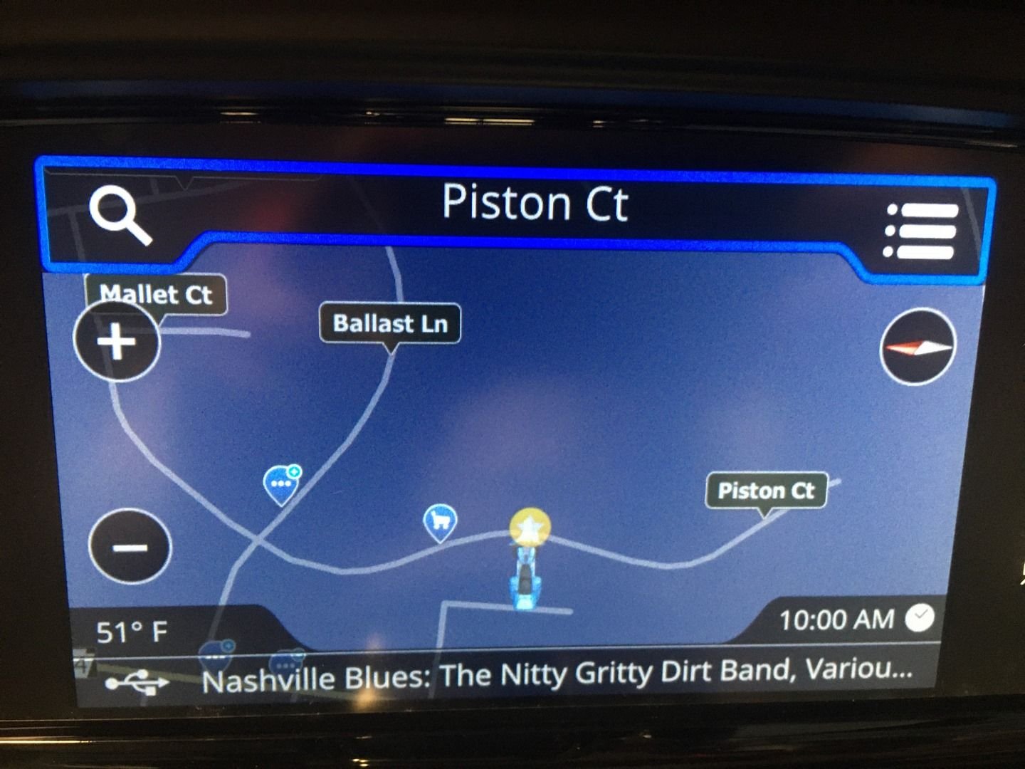

See screen shots below. 1. go to your NAV, then NAV menu, then NAV settings.
Main Screen go up and to the mag glass

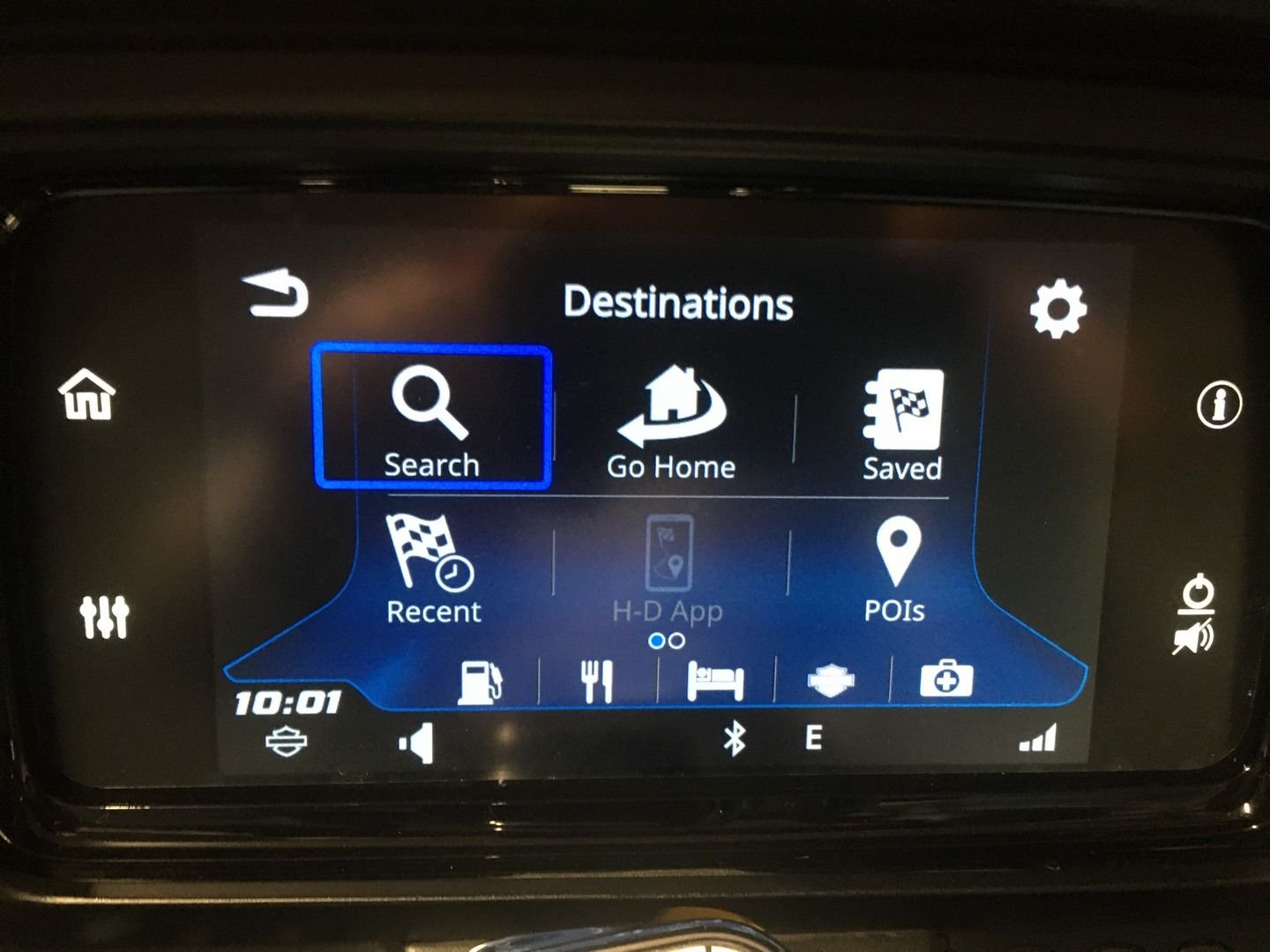

Then you will get this screen go up to the top and use the wheel on the right.

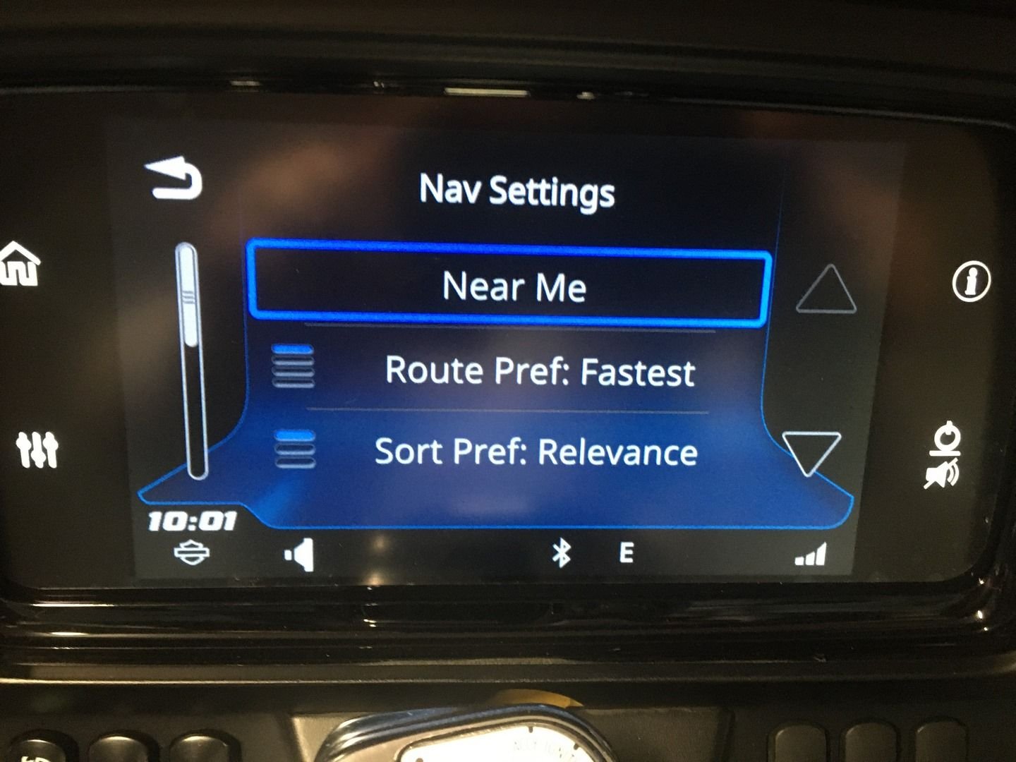

You will get this screen
Scroll down until you find these settings.
Then change the settings.

Thanks to all for the replies and help. I found the setting thanks to CoolBreeze3646 and it was already set to off. As soon as we get some deceit weather, I will do more experimenting. But, I think it is a waypoint issue and will need to be sure to include as many waypoints as possible. I wish Harley would fix this. I rode thousands of miles using my Garmin and it was flawless 98% of the time. Route completed in Basecamp and imported into the Zumo. Multi day trips, including an 18 day, 5600 mile adventure, No problem for Garmin. I do not want to install a Garmin on the new bike, but it appears that this will be the only solution.
