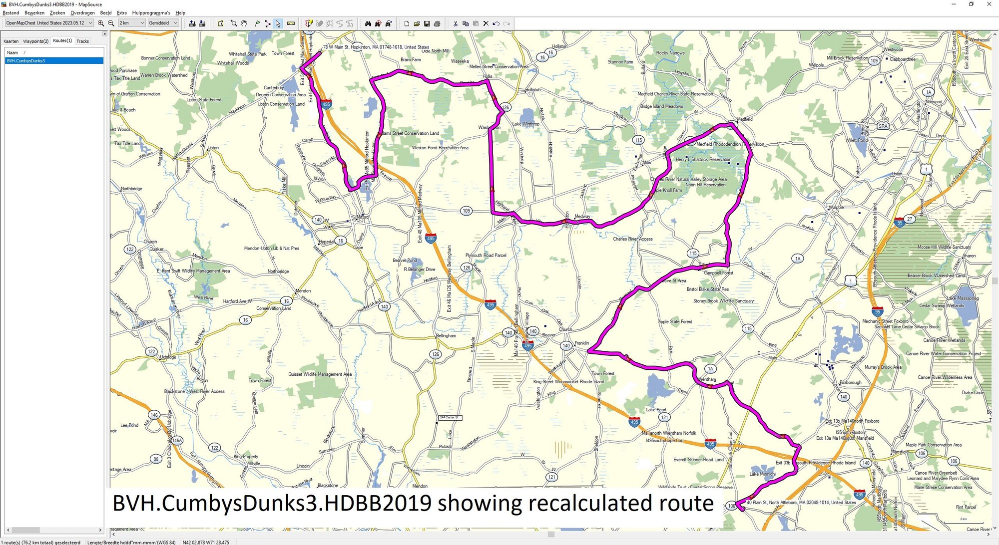

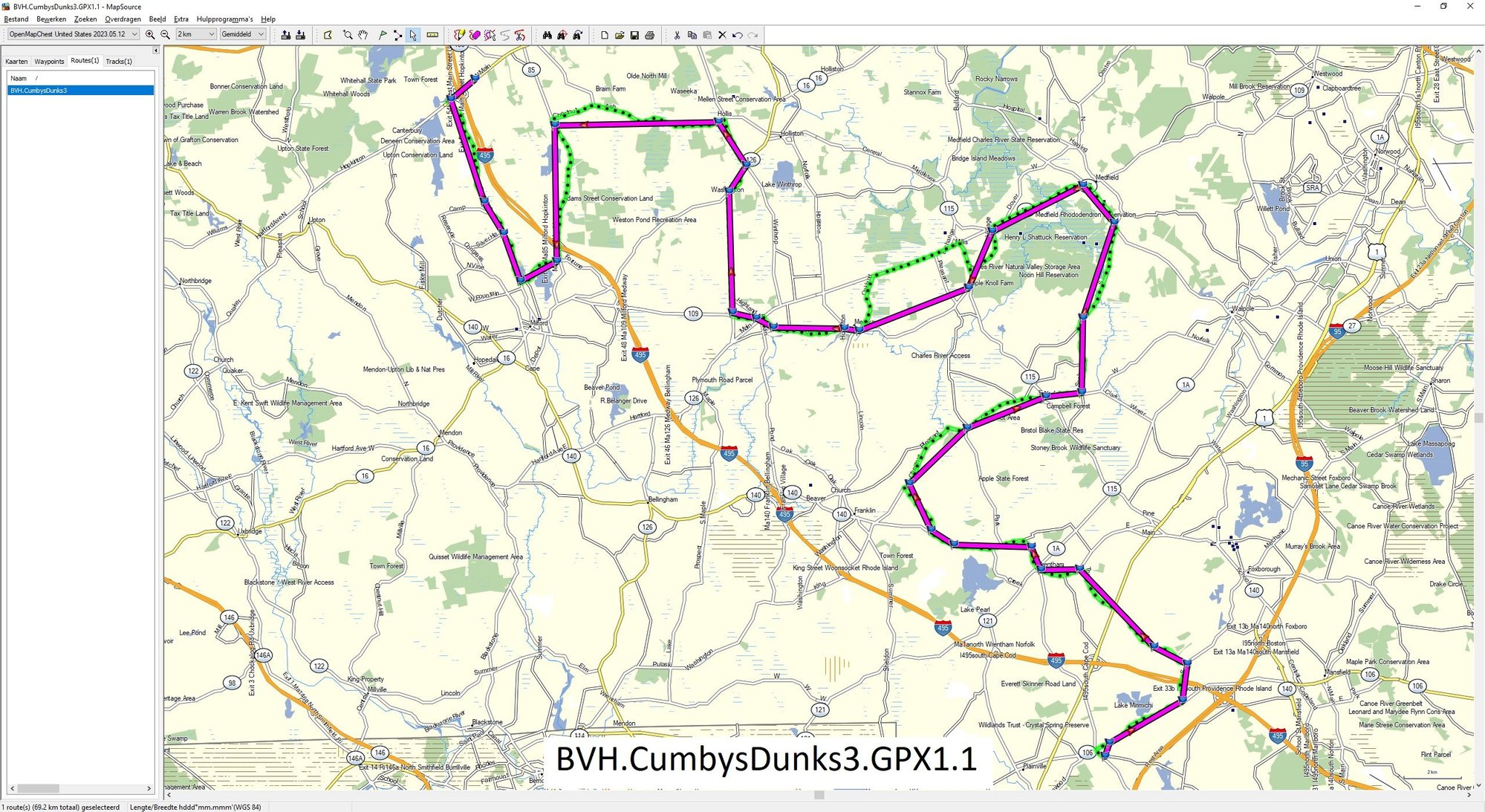

Thanks a lot for taking the time to look in to this. The difference between what you show in the .GPX 1.1 format versus the Boom 2019 format don't account for the confusing mish-mash of purple route lines that I originally posted. It looks like that might have to remain a mystery that only the engineers at Naviextras can address, and of course, there's no way to reach Naviextras.

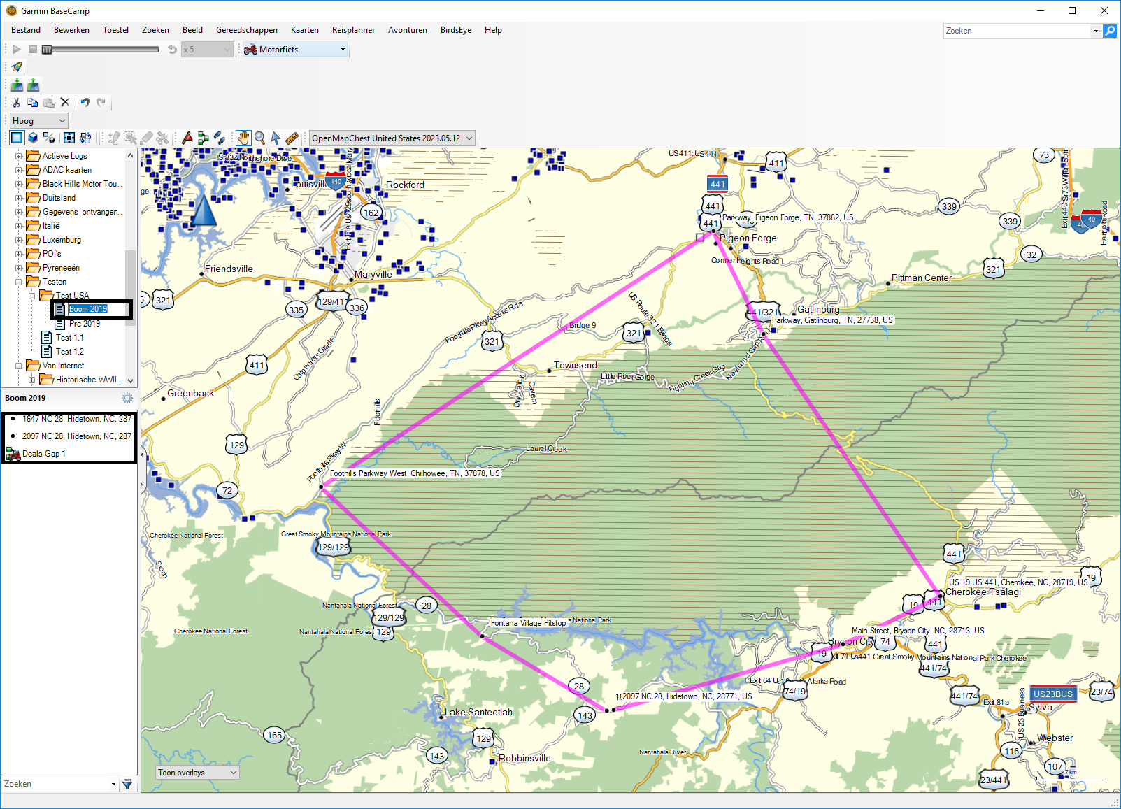

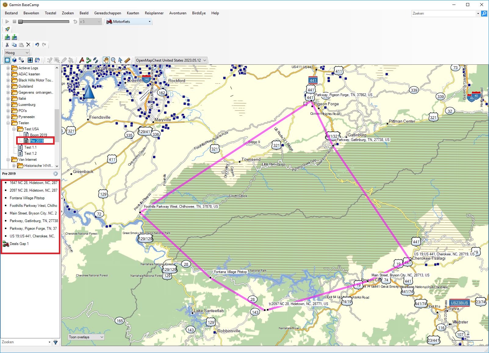

Track in green and route in maroon from your gpx1.1 file
Route (crowsflight) in maroon from your Boom2019 file:
Here's the route when calculated in BaseCamp and/or your gps device depending on the settings and used map:

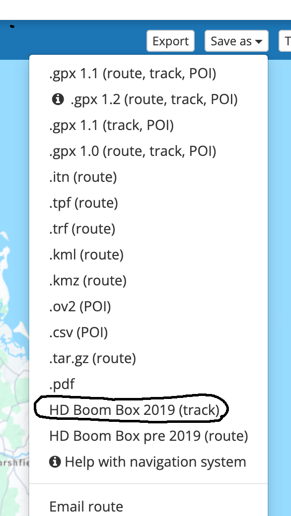

Actually, saving as the BoomBox 2019 format creates a Track file. Please see this screenshot of MRA's "Save As" menu.
At MRA they call it a track. This is a bit confusing. In terms of BaseCamp both HD formats produce routes. The pre 2019 format produces a file containing all waypoints and the uncalculated route.
The Boom2019 format contains only start and finish waypoint plus the uncalculated route
I assume that's why they call the Boom2019 format a track although it's not composed of "breadcrumbs" like a track in the gpx1.1 format.
