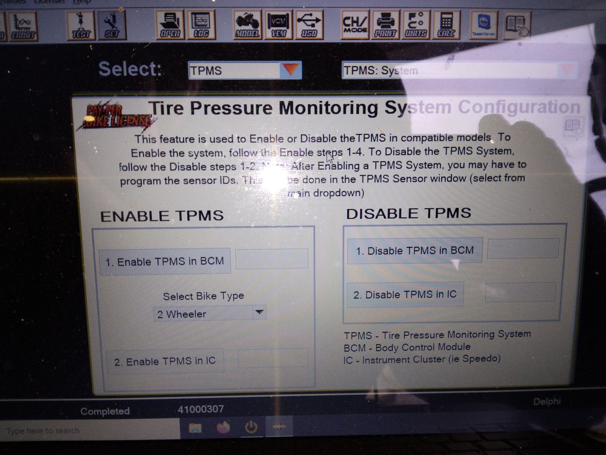

Originally Posted by YPD485
Finally an actual positive user. Thank you.
I have in the past run Rideon with TPMS with no issues . However on last tire change they said no to using it with TPMS. Issues were coming up and they have stopped installing it with TPMS.
Old Apr 25, 2024 | 06:14 AM
smitty901's Avatar
smitty901
Joined: Feb 2008
Posts: 23,003
Likes: 11,441
Originally Posted by smoothcvo
I took mine to the dealer and had them disable it ($42.50). They wanted to start checking all kinds of crap that has been checked by 4 dealers and no one can seem to figure out the cause. Screw it. Thats one of the bells and whistles that I can live without. I have to check my wife's bike anyway. Good luck to everyone else.
10 minutes max to disable them easy money. Someone mentioned re-calibrating. There is no calibrating.
When your tire is off write down the number on you senors. System remembers the last one entered. How ever some times it needs to be reentered.
If you do not write it you may have to have to break tire down to get the number . Does not happen often but can happen.
