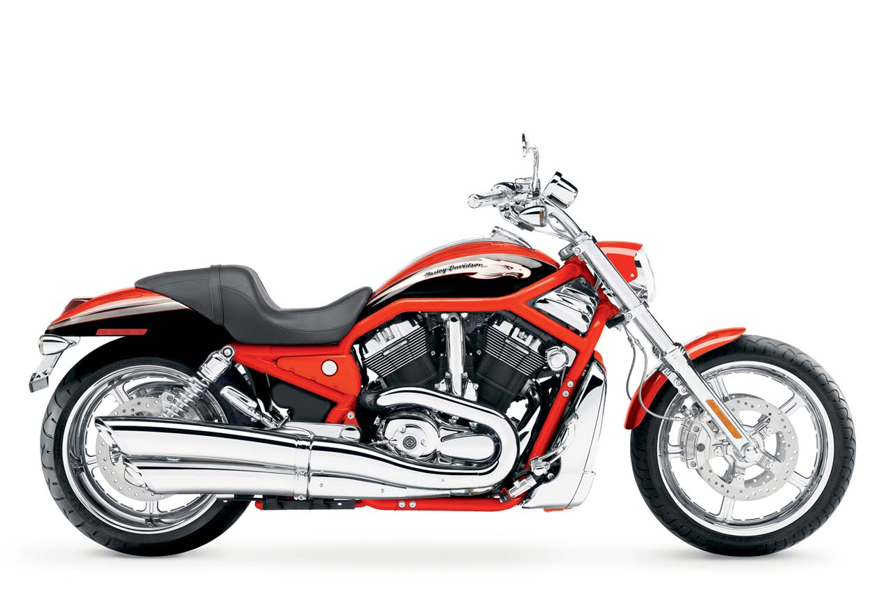

We have a VRSCSE CVO Red Screamin Eagle Vrod just been delivered its a 2006 and has only 1600 miles on it . It has a ignition switch on the right side of the frame and there is a panel on the right side (sitting on the bike) that has a hole in it and some sort of protrusion. Is this where the ignition was previously and should there be a chrome blanking plate over it on the panel.
If anyone has the colour code from the frame paint which is red with a metal flake that would be great.

Ignition is correct. Looks like there is just a chrome cap on there. Ronnies Harley fishe shows a fuel cell cover but not the escrutcheon. Might have to look at Harleys parts book. And Ronnies says it is a scarlet red cover which can be purchased.

51636-06 button missing on the seat release. Ignition switch is normal/correct for that model.

We have the correct answer.
OP—that is a 2006 VRSCSE2. That may help to find parts, etc. Great looking bike and low miles—congrats!
