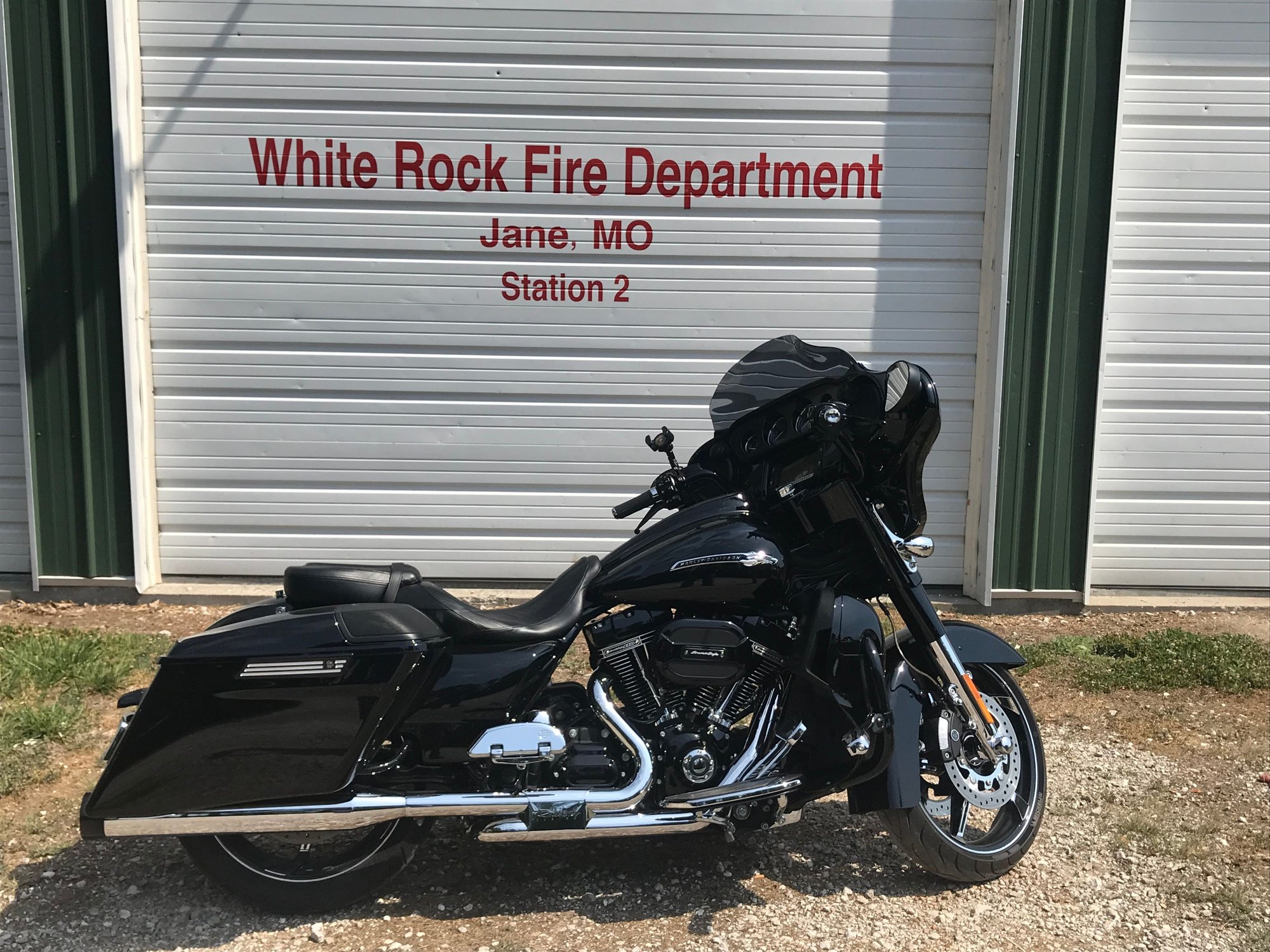

This is my new 2019 CVO Street Glide. Quick docking and pipes!
This id the CVO i pulled the trigger on. 1000 miles so far in a week. Looking to put many more on it. 9th HD. This is by far the best bike i have owned or ridden. Over priced but Rolls Royce on 2 wheels. Thanks for all the input!

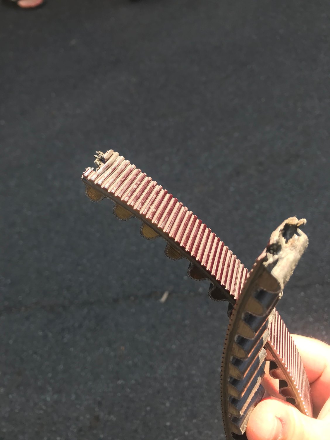

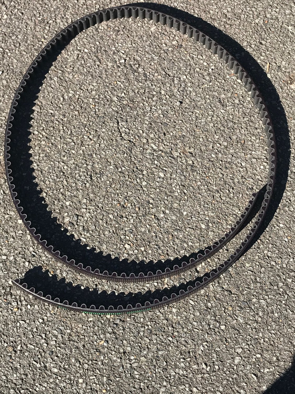

Any one can help me please??? I went for a long ride here in Sydney We went to Oxley Highway and coming back home I broke my belt drive and I just start free welling down hill.. when I stop the engine and park on the side, I just saw the belt drive hanging at the back.. I herd a loud crank or the belt snapping.. is this covered by warranty and is the belt drive only the problem??? I left the bike in the dealership and would you imagine there’s only one belt drive in Australia... I couldn’t believe it!!!!
Stuck with a broken belt drive 2019 CVO STREET glide
Is this covered by warranty??
2019 cvo street glide is this belt drive covered by warranty???

Stock bike? Thats very unusual for a belt to break on that new a bike. I would think it should be covered under warranty, if the bike is less then 2 years old.

It’s hard to tell, there might have been a puncture there for a while and it finally failed. Have them check the pulley for abrasion as well. Belts usually last a very long time, usually age or debris causes them to fail specially if they are not adjusted correctly, in your case your bike is a 2019 so there is no reason for the belt to fail like that on its own.

Betcha they will say that it is a wear item and they won't cover it. Even will little to no mileage.
It does look like a puncture wound, my guessing is a rock caused it.
BUT, hopefully your selling dealer will cover it for good faith.
Keep us posted.

I would think it should be covered by warranty. I have a '17 SG and it would be covered under my ESP.
you have a gorgeous bike, sir....i love that color
if I were you, I'd two two things. Get it into a competent shop and see what you can do understand what happened.
As well, get the HD tool for checking the tension on your belt. That belt failure is really unusual. The first place I'd be checking is the tensioner to make sure there wasn't an issue there.
