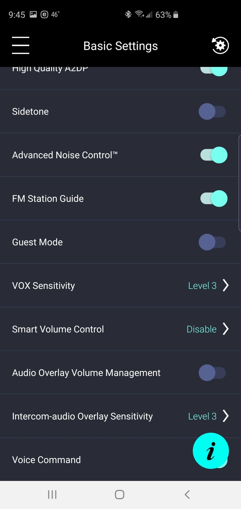

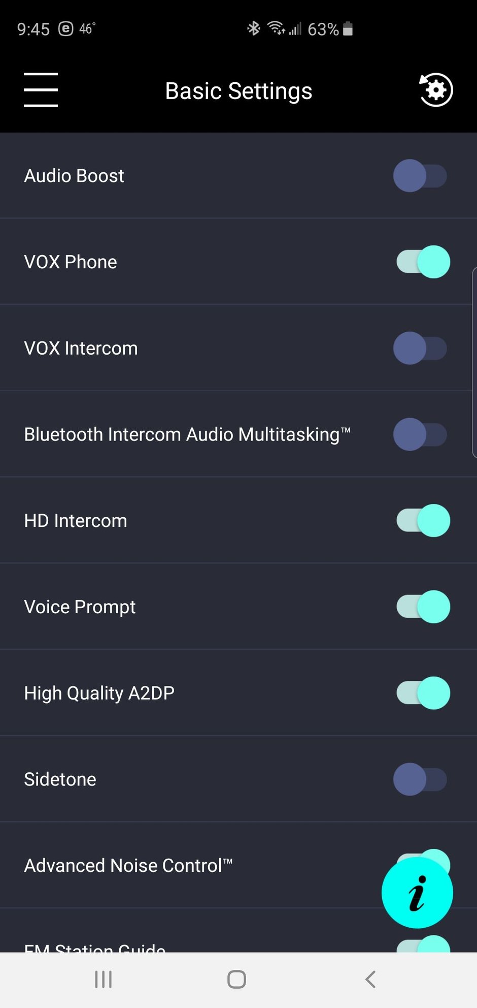

Sapman, I was having the same issue on my 30K also. If you haven't downloaded the Sena app on your phone, I recommend that you do. Then you can Bluetooth the 30K to your phone app and see all settings. There are settings in there that I never knew about. I think I turned off the side tone and it took care of my issue. I may have also changed another setting or 2.

You can disconnect you phone after you adjust the setting if you want. I don't like my phone hooked up to the bike while riding. But if you don't connect the app and look at the setting, you won't know what is in there to adjust. I understand there is also a way to go on line and make the adjustments. Either way you might be surprised in all the setting you don't even know are there. Here are screen shots of the basic settings.
