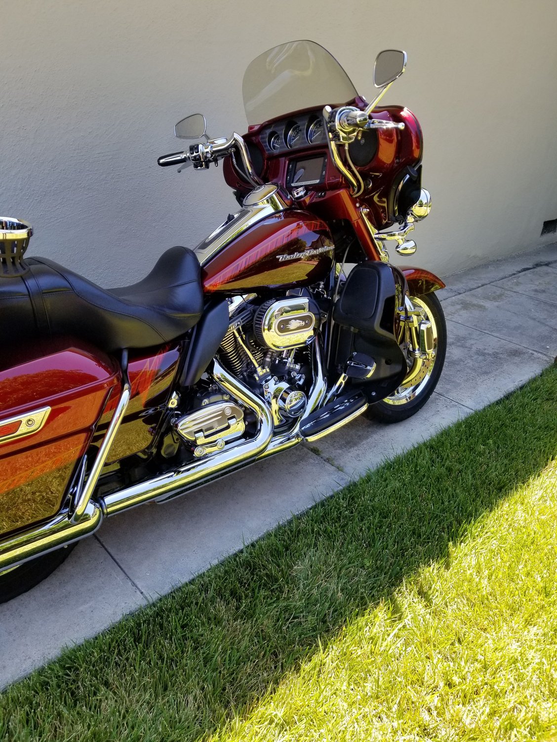

Here are KST Maymen Baggers on a 2014. I really like the height, and I am 6' 3". These might be just above the fairing, but I have no trouble on cold mornings.
